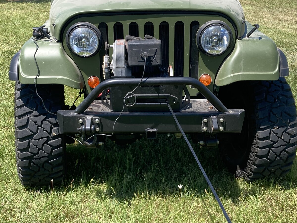

I did it a little different. First I found a used warn x8000i used for 200. Put new solenoids to get it working and some harbor freight synthetic line. Then I found a new superwinch 10k winch at our shop that had been in storage for several years. Swapped the warn to that since it was a new 10k winch. Put the warn up for another day/vehicle. Then I found a guy wanting to swap a warn 8274 for a regular feet down winch. Like an even swap. So I jumped all over that and swapped that warn for it. So I ended up with an 8274 for about $500 Which is about what I had all in that warn. I put new battery cables and some synthetic line from tactical recovery equipment on the 8274 and built my own plate to fit the Roxor. Wouldn’t have any other winch on my Roxor. The 8274 is about as bullet proof and rebuildable/modifiable as you can get. Plus it’s iconic for an old school jeep style build. every Roxor should have one IMO.

txroadkill You did a great job on your Roxor. It looks like a Roxor should look. Well "WILLYS" Decals on the Hood would be even better. I cannot tell from the front picture, WILLYS may be on the hood. Great Front Bumper by the way. I need to sell my front Shackle Mount, and get the Cecco set. The Cecco ones you have are much better built than the first set that I bought.
