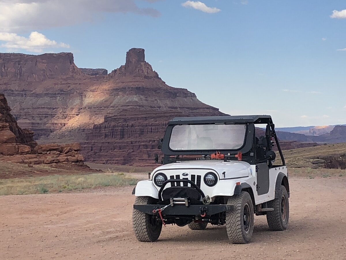

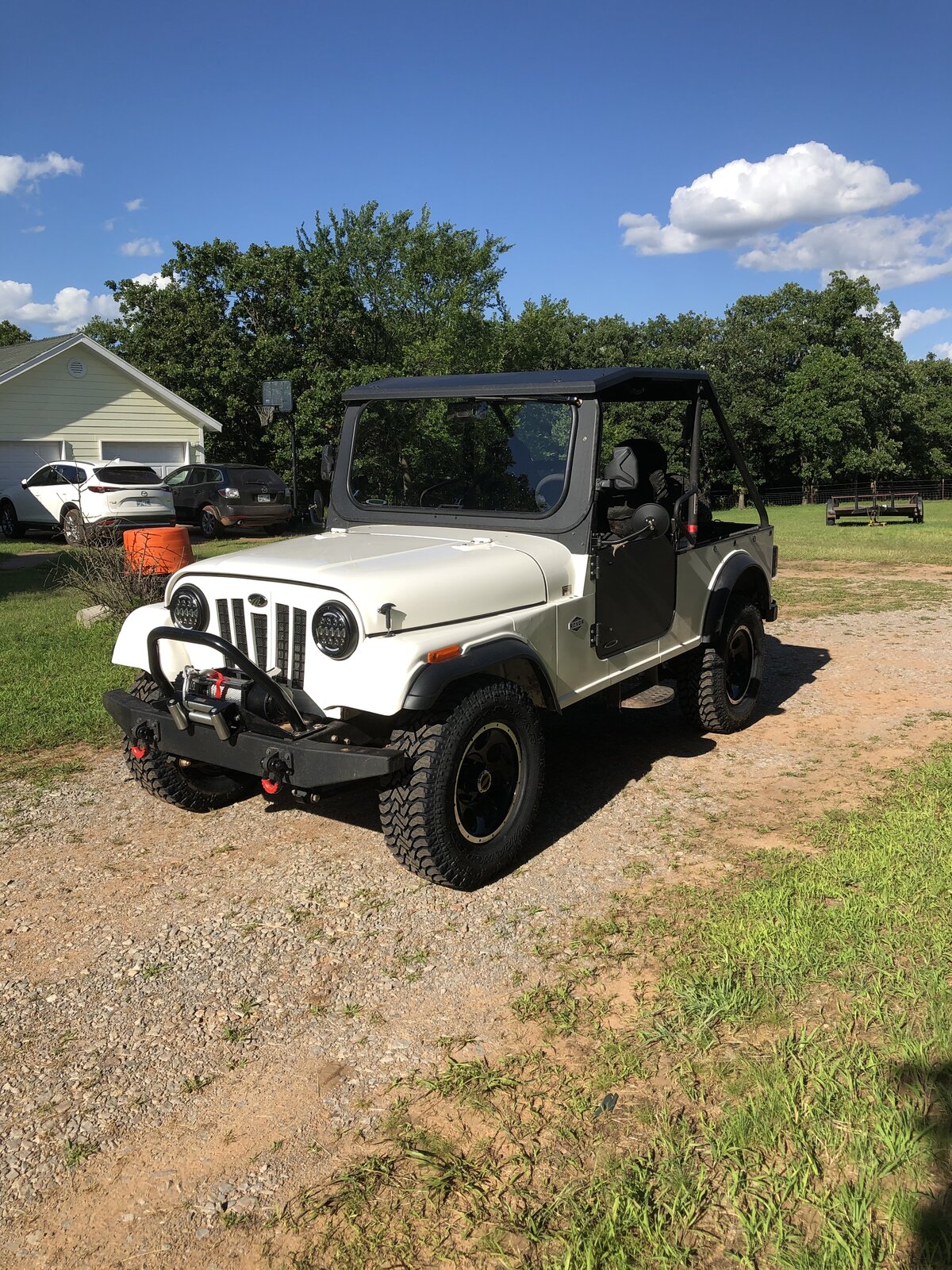

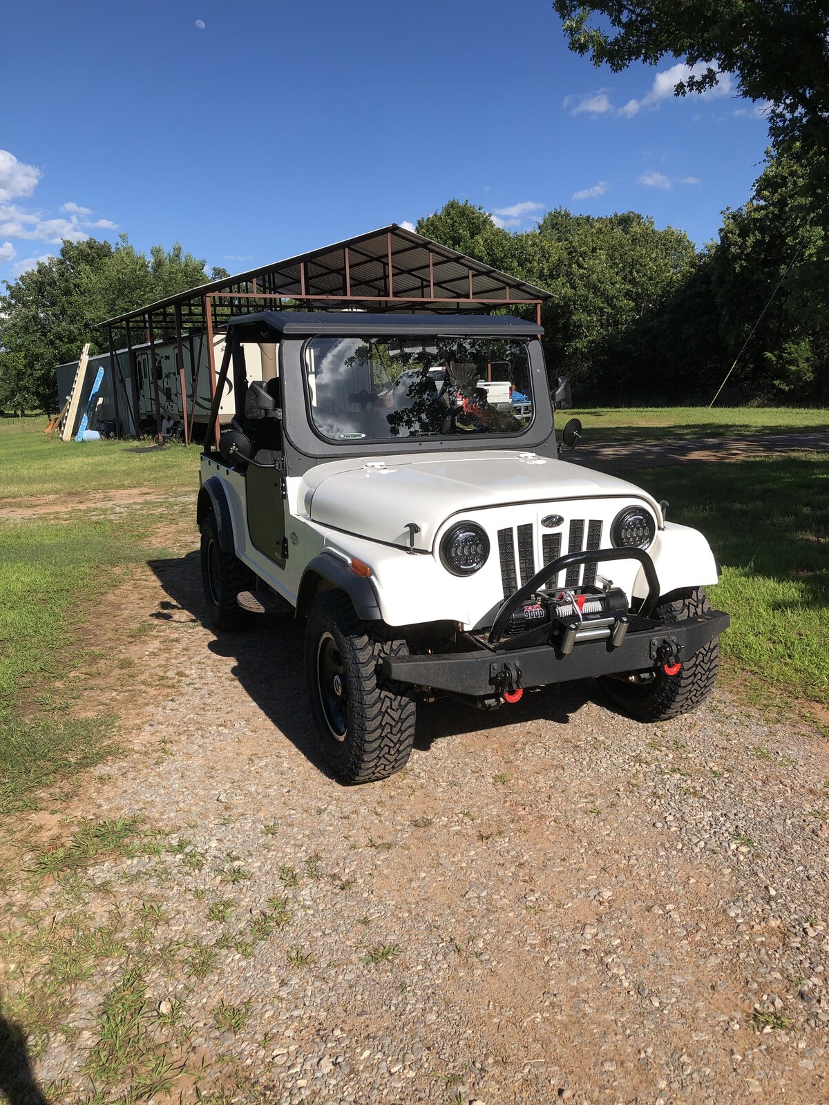

I have 1.5”. Been on since 2018. No problems at all. 245/70/16 Goodyear mud tire. 10 ply
703BADD0-2637-45D2-A22B-B36444726558.jpeg 620B5699-8028-478C-B868-3AD453F7F4E4.jpeg

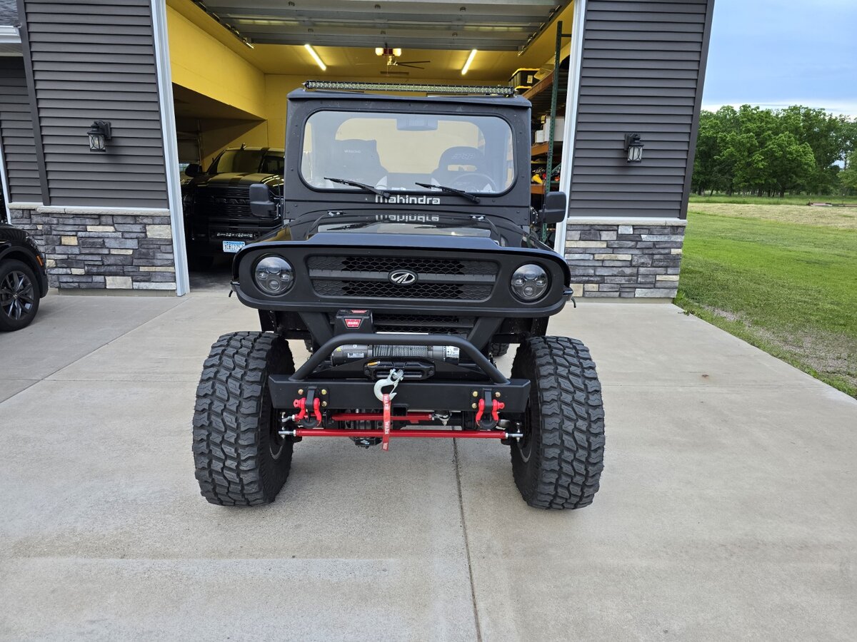

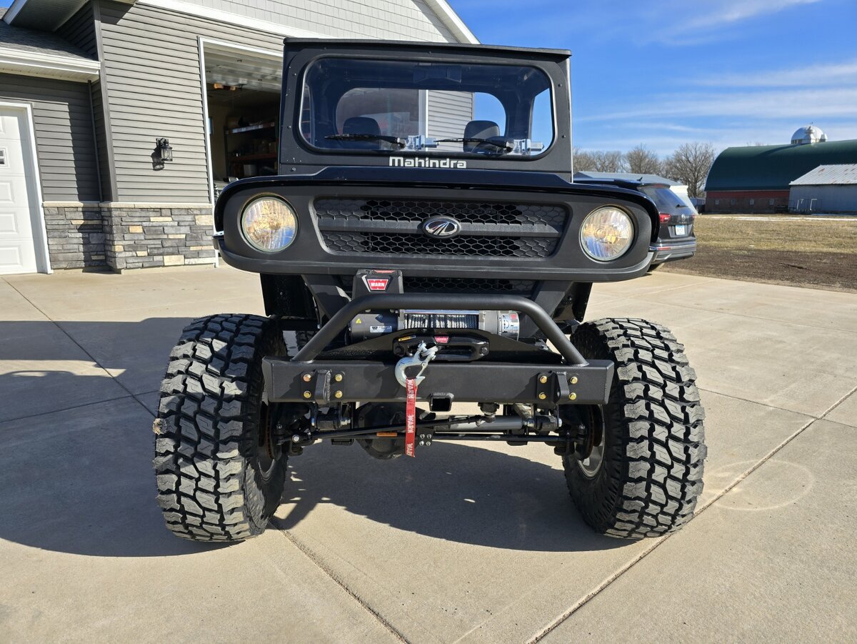

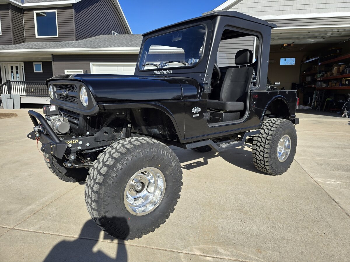

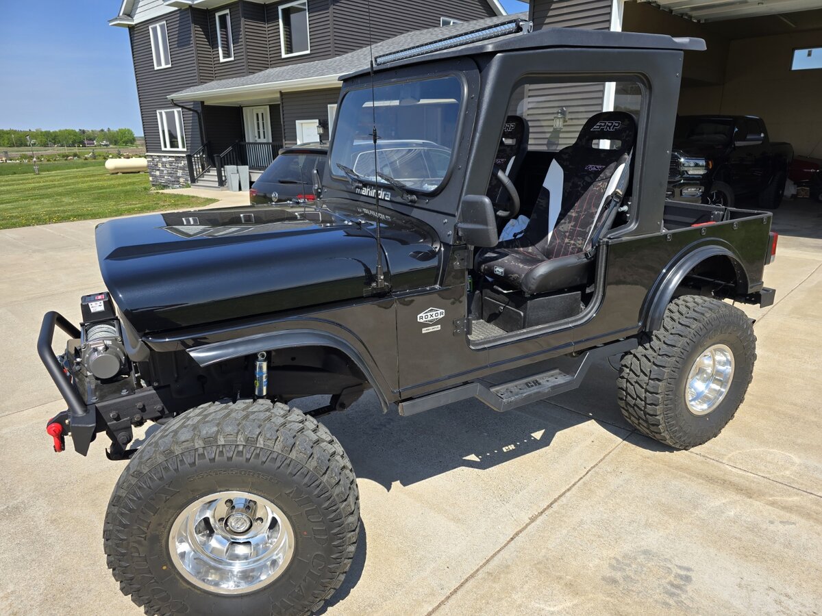

I started with 2" Spacers on a 5" lift and 35"x 12.50" tires. Awesome stance and look, but I couldn't drive it in the rain decent. Flung everything on the windshield even with small flares. I'd have to run some huge flares to keep it to a minimum. Just went to 1.5" and that kept the road spray liveable. No issues so far, 5000 miles.
Got pics of the fitment without spacers? I'm running 6 ply super swamper pizza cutters. 33x9.50 with a 2 inch spacer should stick out almost as far as your 35s without spacers.

I never mounted them without spacers. They would fit with the wheels I'm using as they are only 3.5" back spacing, but the turning radius would be slightly lessened as the tires will contact the springs.
Here it was with 2" spacers with 3.5 backspacing before flares:
Here it is currently with 1.5" spacers, 3.5" backspacing and flexi flares:
