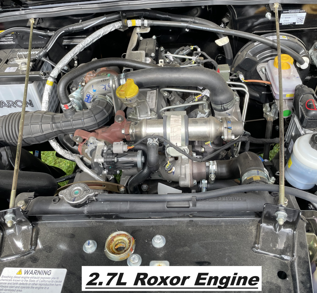

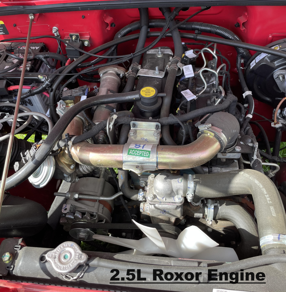

The two pages I spoke of that may be helpful in telling what year etc a Roxor is:
Roxor PIN Decoder (what Year, GVRW, etc. is my Roxor)
Roxor Timeline Features
Below are pictures of each engine to help.
