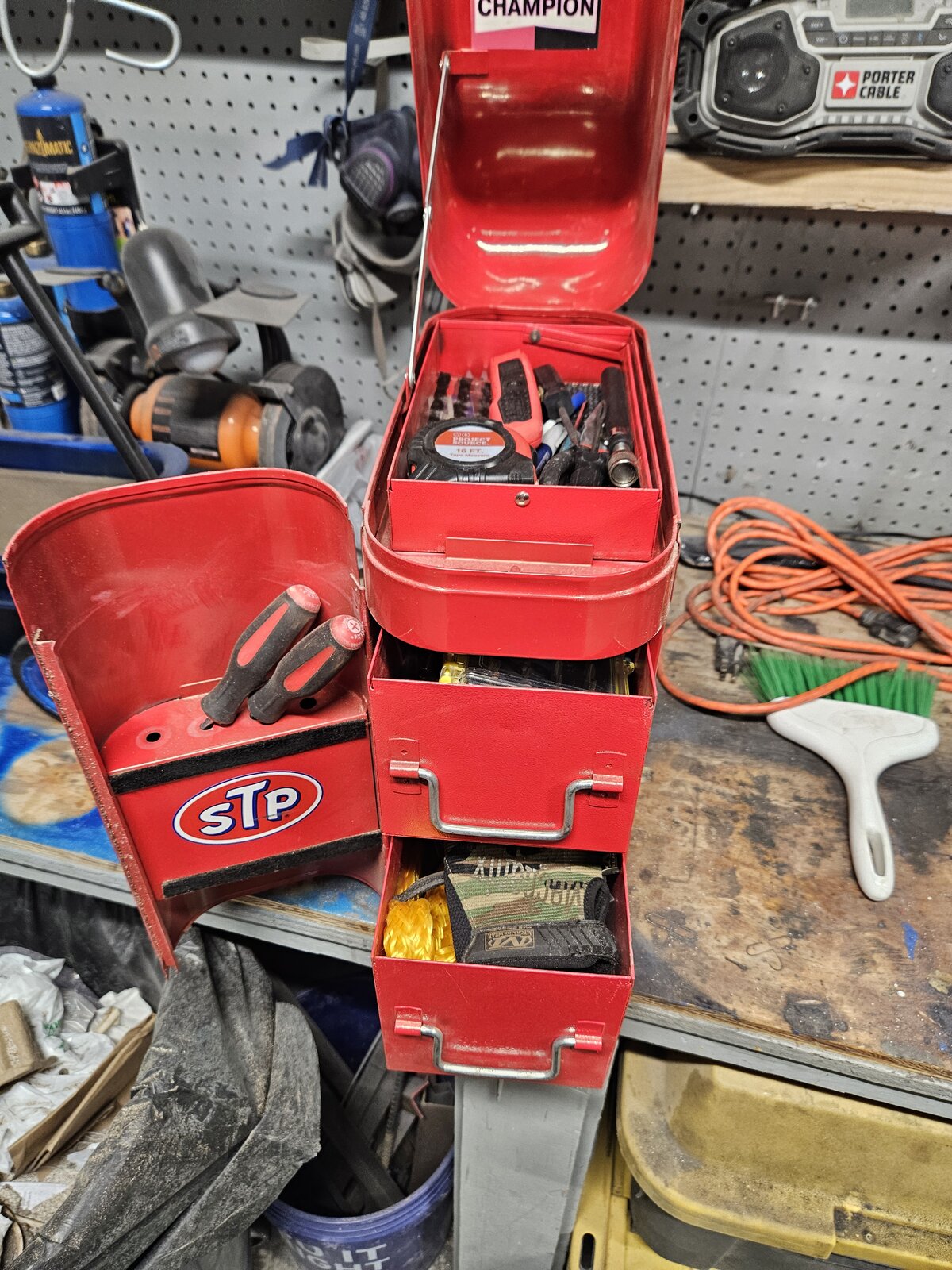

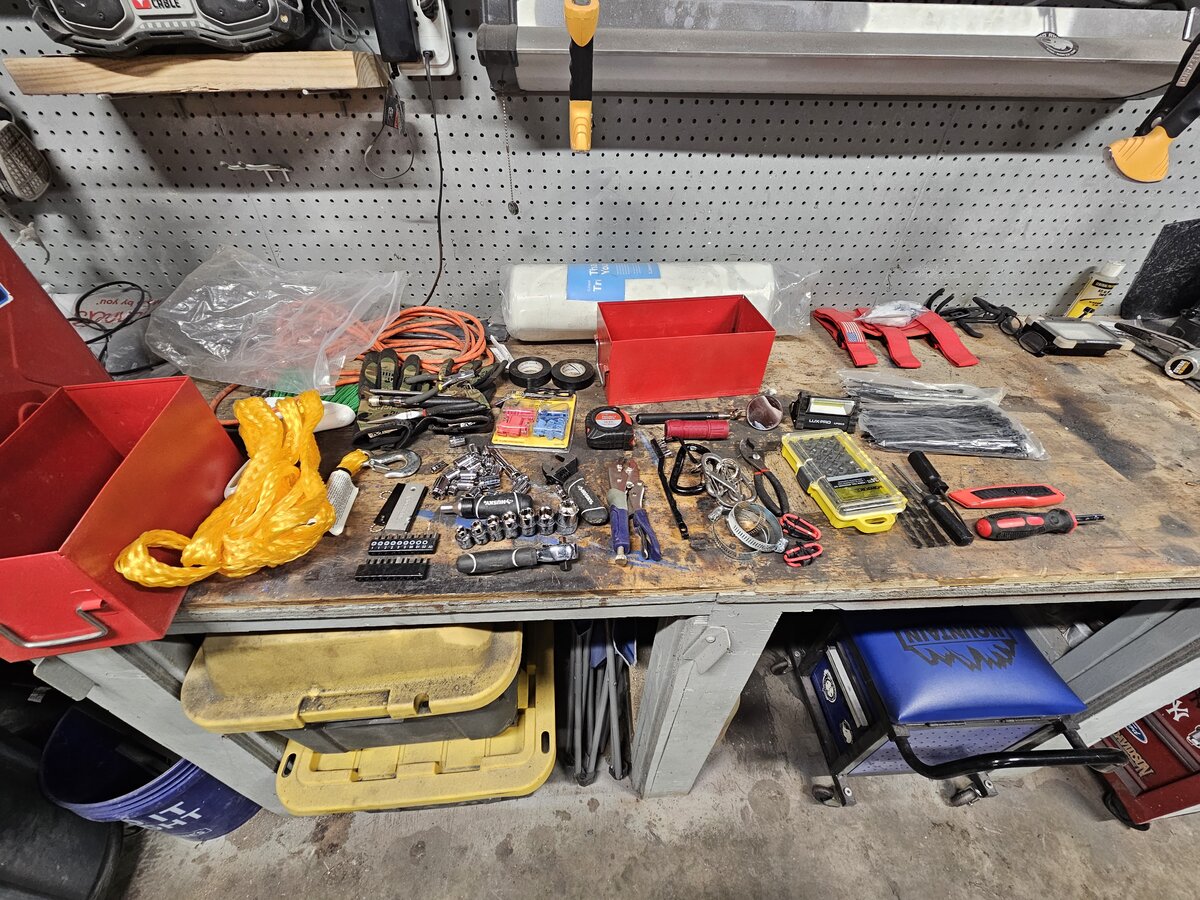

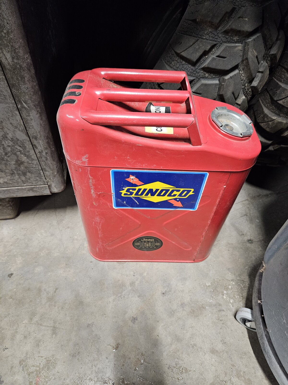

2,292
I usually carry this fuel can tool box and a bag with medical supplies ans binos.
