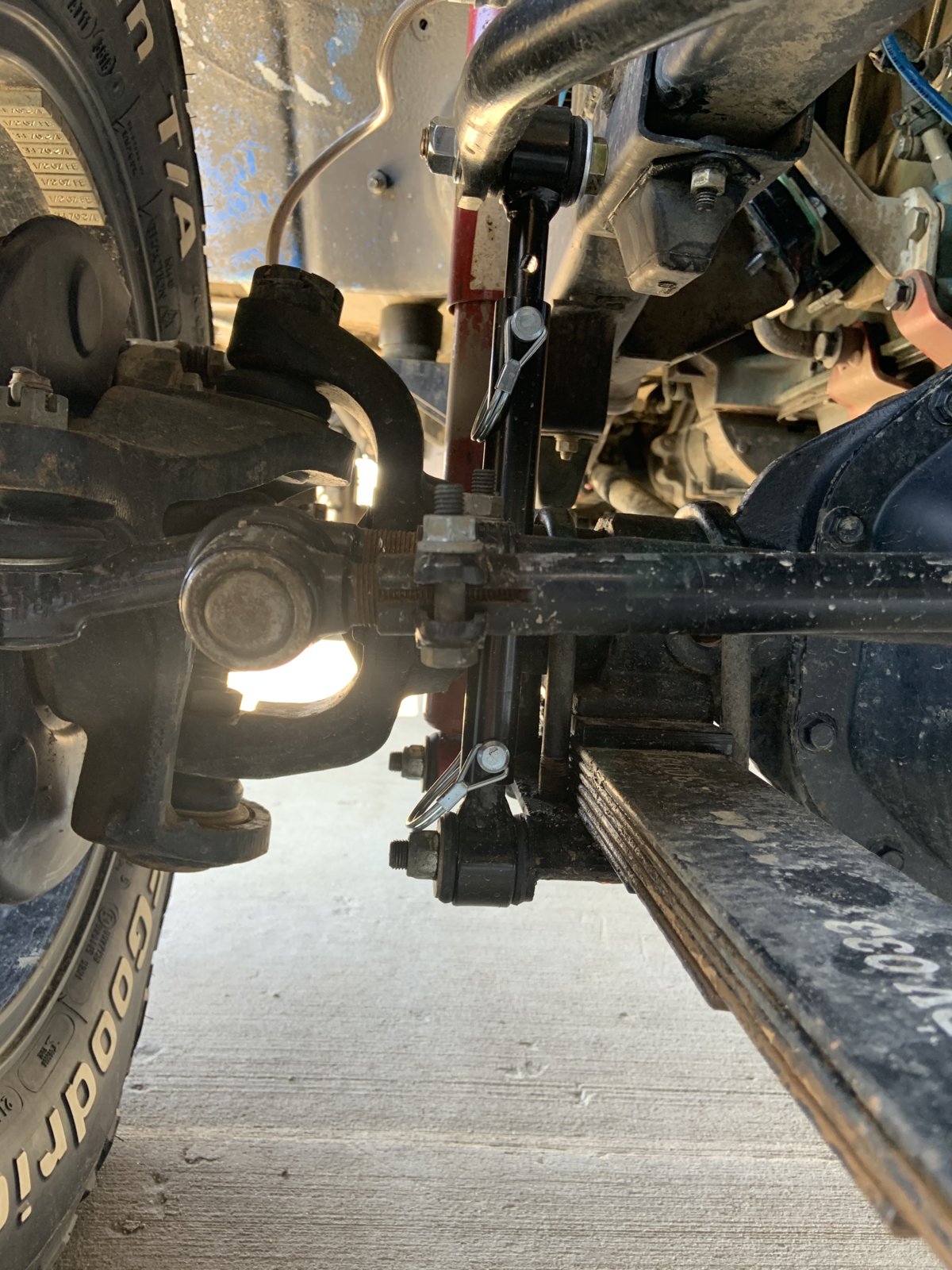

C93FD729-2CE7-43D4-82D8-0BEB0A8570BA.jpegI’m using the rough country disconnects model #1186

Yes, the links should still work with stock suspension. The factory hardware still fits, and I lubed up the bushings to slide them on easier. The links are adjustable. Remember you can always cut down the tube and drill new holes if needed

Worked fine on my stock suspension. Just shorten the tube and drilled new holes.
