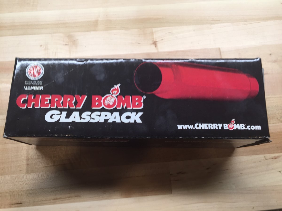

So while waiting on parts I got bored and went to Autozone and bought a Cherry Bomb Glass Pack. Remember those from High School? It was pretty straight forward thanks to seeing someone do it on Facebook. The Glass Pack is a 12" with 2.5 inch inlet and outlet. I needed an adapter 2.5 in ID to 2.5 in OD and 3 2.5 in exhaust clamps. Total cost was 38 bucks. Got it bolted in and cranked it up. I expected it to be louder but it was surprisingly quiet. I did get a little more turbo whistle though!
Dang, can't load video. It sounds better. Trust me! Lol.

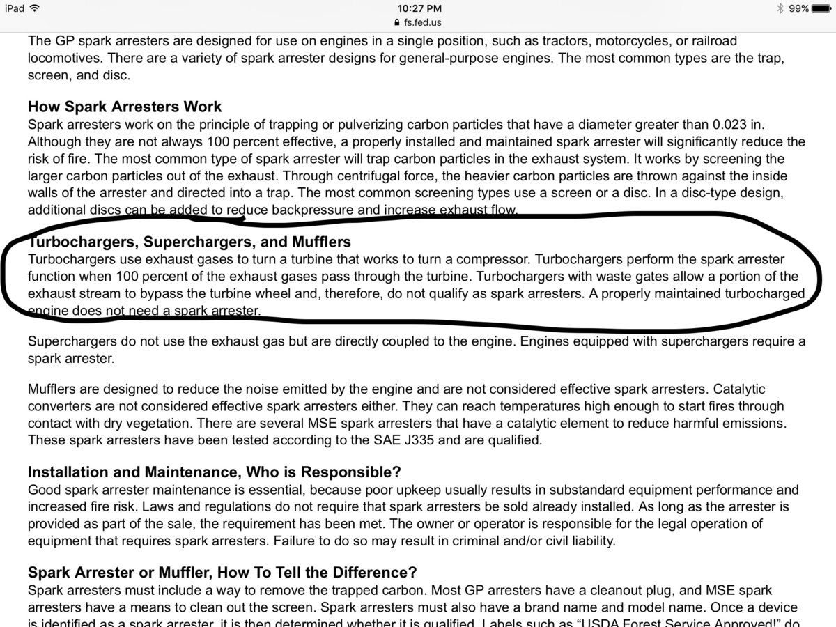

I did some research on Spark arrestors. Seems that on turbo charged vehicles the turbo acts as a spark arrestor as long as you don't blow past the waste gate. I wonder if there could be a tune that could disable the wastegate and divert 100% of the exhaust gas through the turbo? Then you could switch it back when you are on pavement. That would, in effect, eliminate the need for a spark arrestor on our Roxor's and still be safe. Here is a screen shot form the US Dept of Agriculture regarding Spark Arrestors.
