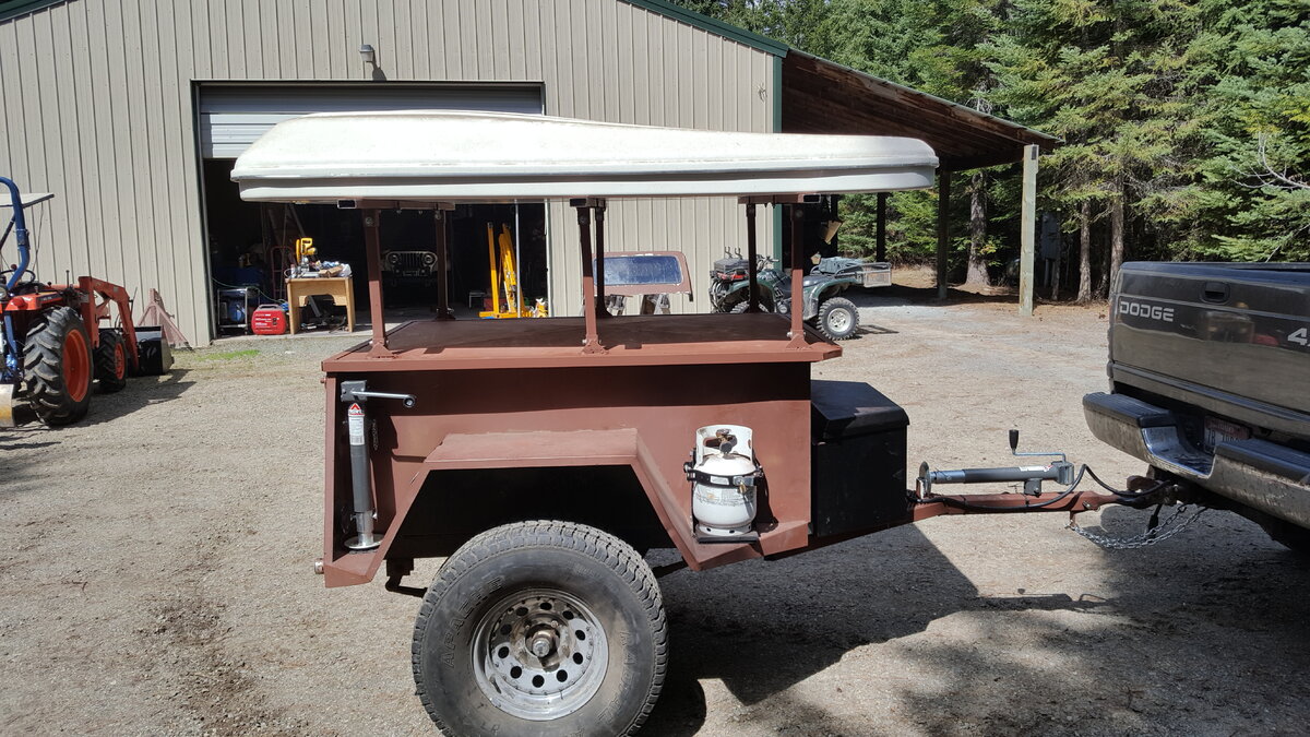

I'll post one soon. Also have a late 70's model off road trailer by Helder Welding, Marysville, Ca that was designed and built for the Rubicon. Roof top tent and other goodie$$$ added to it. The '53 Dunbar-Kappel trailer I got 20+ years ago will follow the Roxor on it's trips to the dump etc.
