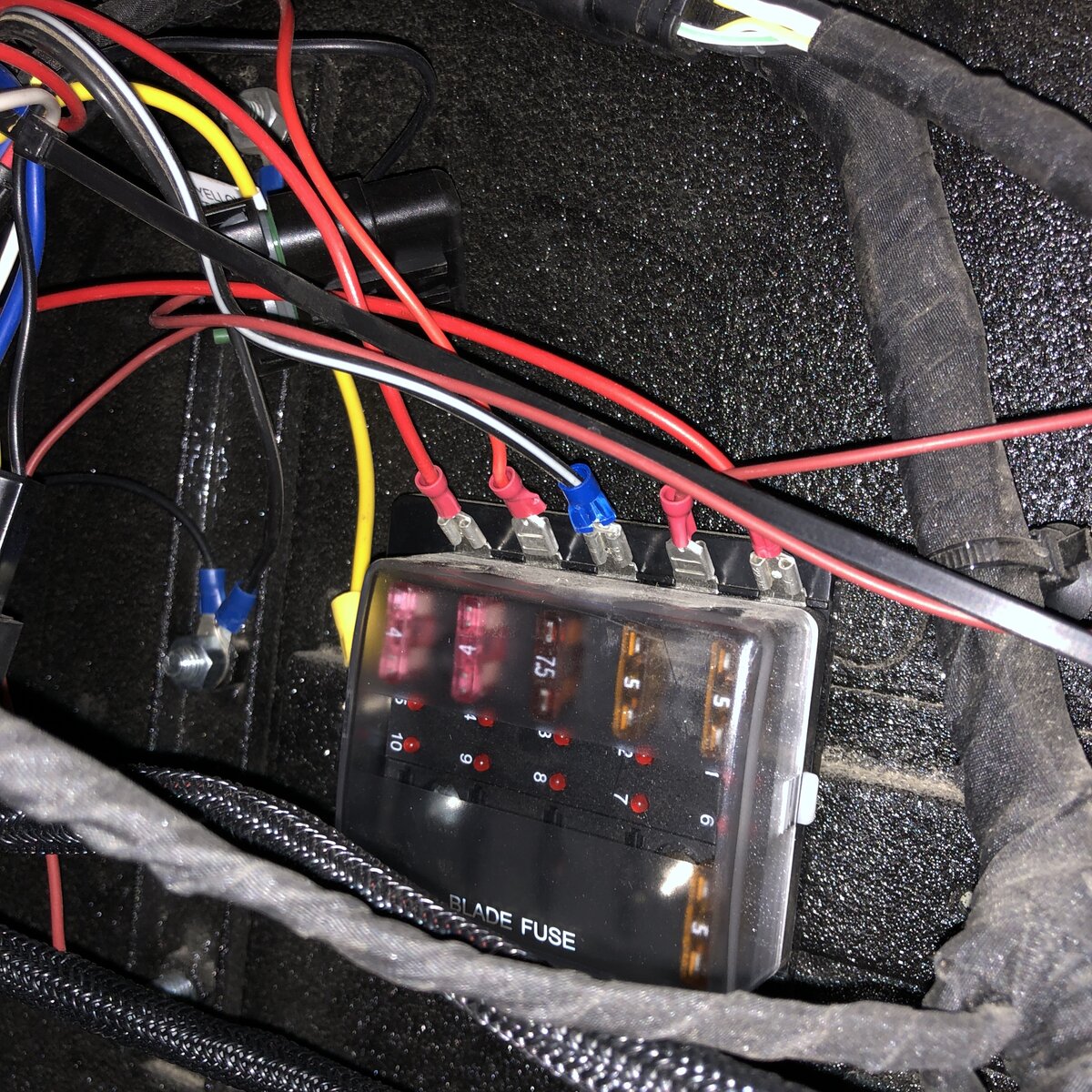

I added my own aux fuse panel under the dash powered direct from the battery that comes on with the key via relay. Did the same on my old Rhino. Makes adding stuff so easy.
Picture before I tied up (most) of the wires. lol

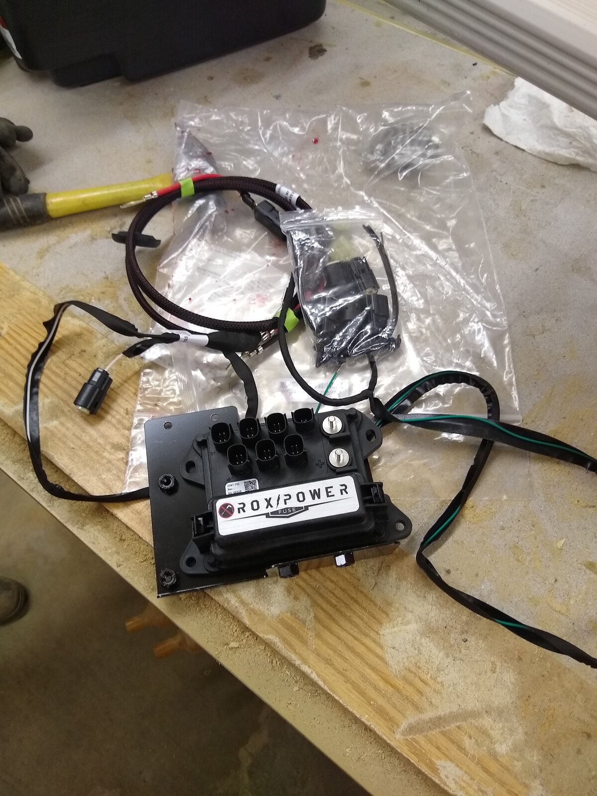

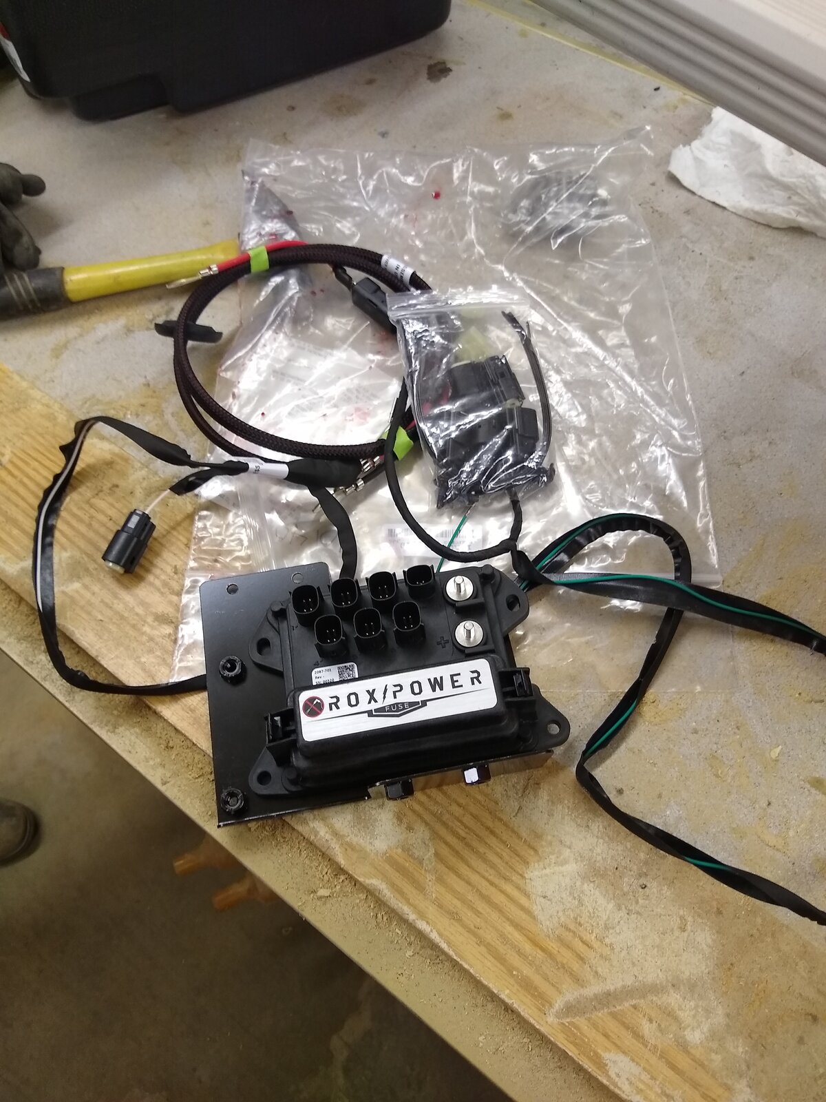

Hey guys have one of these rocks powers we're trying to figure out where to mount it on a 2020 anybody got a photo of this thing in action?
796
Check the electrical manual. I'm pretty sure it's supposed to go on the firewall under the dash, on the passenger side.

They mount up under the dash on the driver side. All our units have them. Don't over torque the 6mm nuts on the ground and power or the studs will break.....Ask me how I know :(
I'll try to post picture up when I get home. My employer frowns upon social media posting at work

Hey guys we haven't tried to install this yet. Looks like driver's side is the place not sure about any additional wiring yet.

Just a FYI. It is alot cheaper and very easy to install a aux fuse panel. I got a 12 fuse panel with grounds from amazon for $20. Add in a relay. I took switched 12v off the cigarette lighter for the relay (30 amp) to feed from the battery. The hardest part was drilling mounting holes. The lining material is tough and the body steel is nothing to sneeze at. I’ll take some pics when I get home this weekend and post. My panel is not water proof, I’ll pr change that this winter, but it is covered so it’s somewhat protected from the elements. I don’t have plans or opportunities to ford creeks right now so element protection is all that I care about right now
