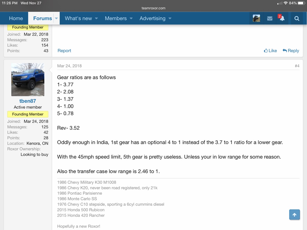

Here’s the gears for the trans and t case
What brand of transmission will it have? - Team ROXOR Forum - Unofficial Mahindra ROXOR Off-road Community!
Use those numbers and plug it into this gear calculator. http://www.grimmjeeper.com/gears.html
Put it on both sides and leave one stock with 29” tires and make the other 37”. Then change the gear ratios in the axle to see where you’ll be. Keep in mind with the added weight and rolling resistance of the larger tires you’ll want the overall gear ratio to be a little lower than stock at any given speed otherwise you’ll feel a little sluggish.
