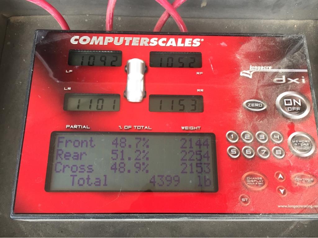

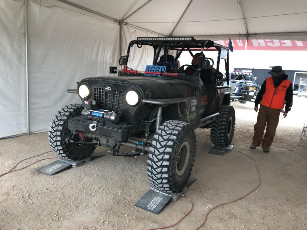

Hello everyone, I'm curious if anyone has actually weighed the Roxor and if it comes in at the listed weight.

Also interested in knowing front/rear weight of a stock Roxor if anyone knows. I'm getting custom tuned shocks and they need this info

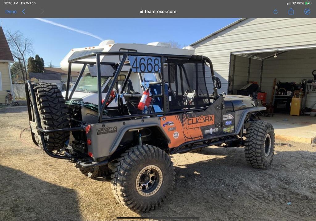

Max, did you have more picks at the time to see equipment installed front and back? Custom bumpers, winches, spare tire, etc? I am impressed with the weight balance.
That was race weight. With a full 12 gallons of fuel onboard. I did my best to keep things balanced.
More info here…
