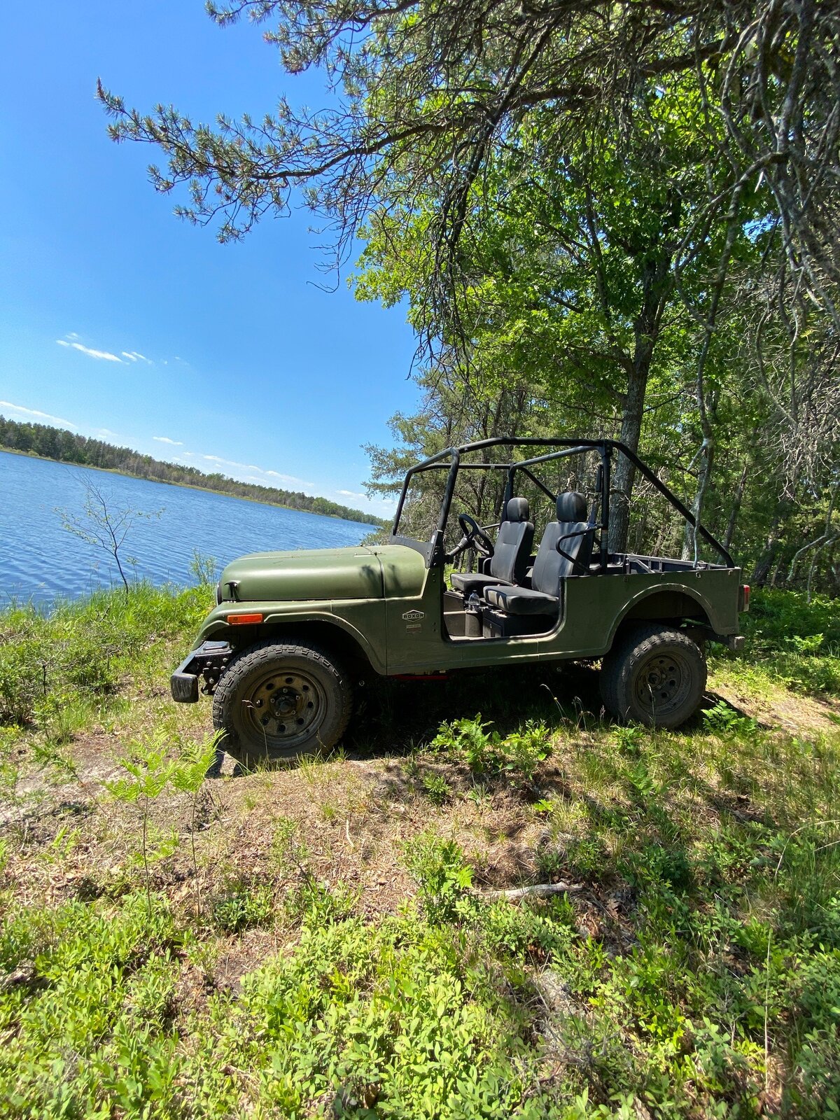

Got a deal on a 2019 Roxor with the auto transmission. It wasn't my first choice but I couldn't pass up the deal. Since there's a ton of reviews on them I'll just stick to the auto portion and a couple things I'll be changing. The auto works well, mostly, and I'm happier than I initially thought I would be. The auto likes to shift early, sometimes too early and lugs like crazy if your just putting around under 30mph. Every once and a while it starts to chatter the tires a bit but then back shifts, not often but happened a couple times. I found some good sand climbs and wasn't sure how it was going to go as they are very steep and long. I was pleasantly surprised how well the motor and trans worked though! I started some of the climbs in 4 high with it in "L1" which basically limited it to first gear. It worked great and the only limiting factor will be traction and I don't see it stalling out. It turned my tires, the 29" stock Goodyears, no problem. I decided to try 4 low and in L1 it's basically a slow creeper, probably great for rocks but I don't do any of that. The trans also has "L2" but I'm not sure what it does. It didn't seem to limit to 2nd gear so I'm thinking it's more of a non-overdrive setting for towing. Maybe doesn't shift into 6th or something? In 4 low if you hammer the gas is shifts good and backshifts great and I had no issues. In 4 high when your on the gas hard it does a decent job of backshifting too it's only when your idling around slow that I had an issue with early shifting, which honestly as long as it's not hurting the trans, it super quiet and no vibration.

A few more things I thought I'd mention about my automatic. Looks like the engine is limited to 3500 rpms but doesn't feel like it's hitting a rev limiter. I'm thinking that's part of the conservative programming from the factory. I also found that "L2" only allows second and first gears. Deep sand hills I ran 4 low in L2 and could keep the wheels spinning. In “drive” it likes to upshift and almost stall off road when your trying to climb or mud. I’ve read the 5.38 gears in the 2020’s eliminates any auto trans issues. I’m still happy with my auto and I think 4low in drive is perfect for most trails. In high it feels like it really wants to stay above 35.
