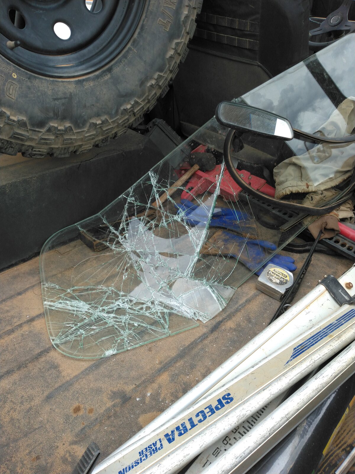

I have a rock road window frame. The drain flexes a lot down the highway. Last Thursday the glass actually came out of the frame. I'm looking for one that's a little safer.

If you have a flat frame I would have a windshield cut from a car glass shop and glue it on Just like a car windshield.
We do it all the time on equipment and its cheap.
I would be doing that on the OEM pvc windshields frame when the pvc get too scratchy.
