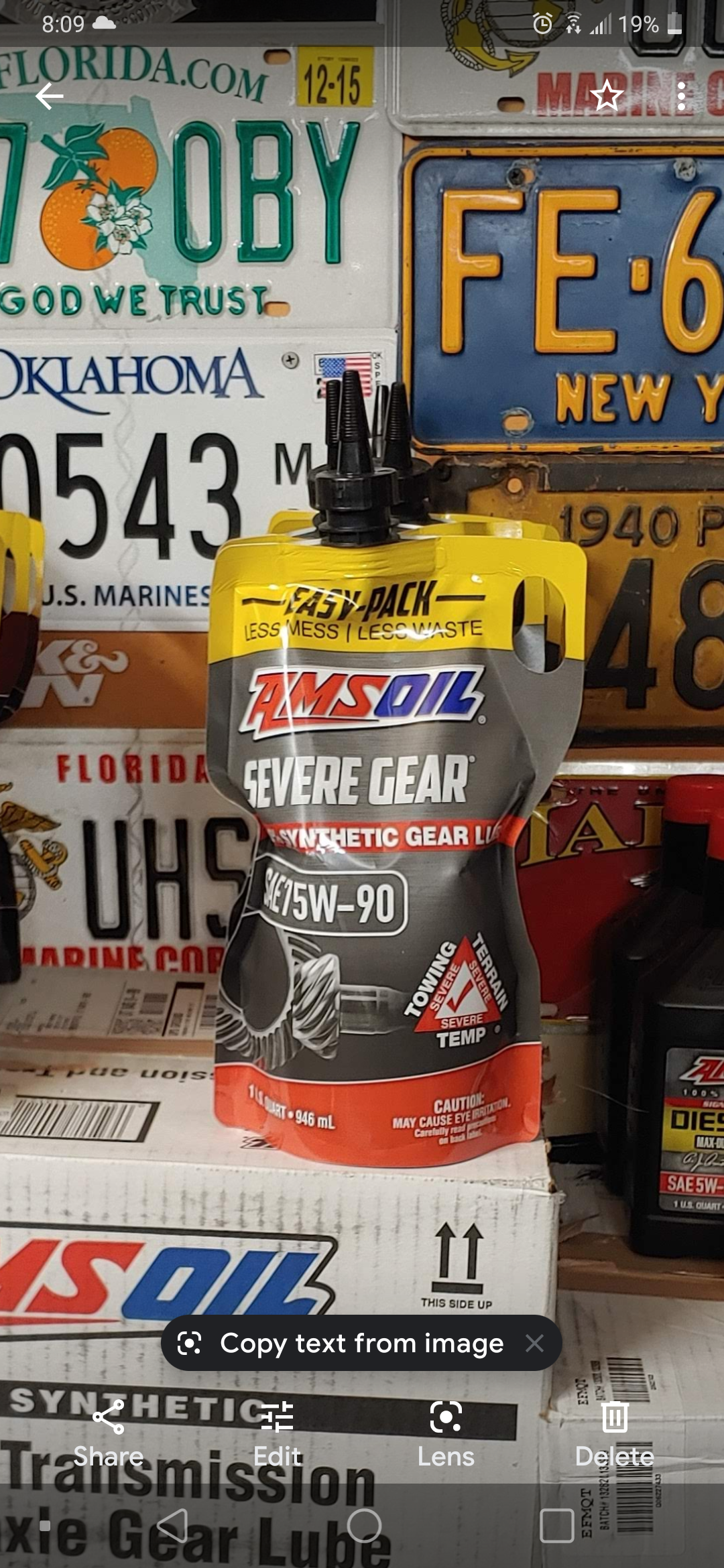

813
Running a Full Synthetic fluid with dramatically drop Temps over petroleum fluids. A few of us here Run severe gear Amsoil. It will go from to hot to touch to warm. Me and Roxasuras both swapped out everything to Amsoil
2,198
This is it.
