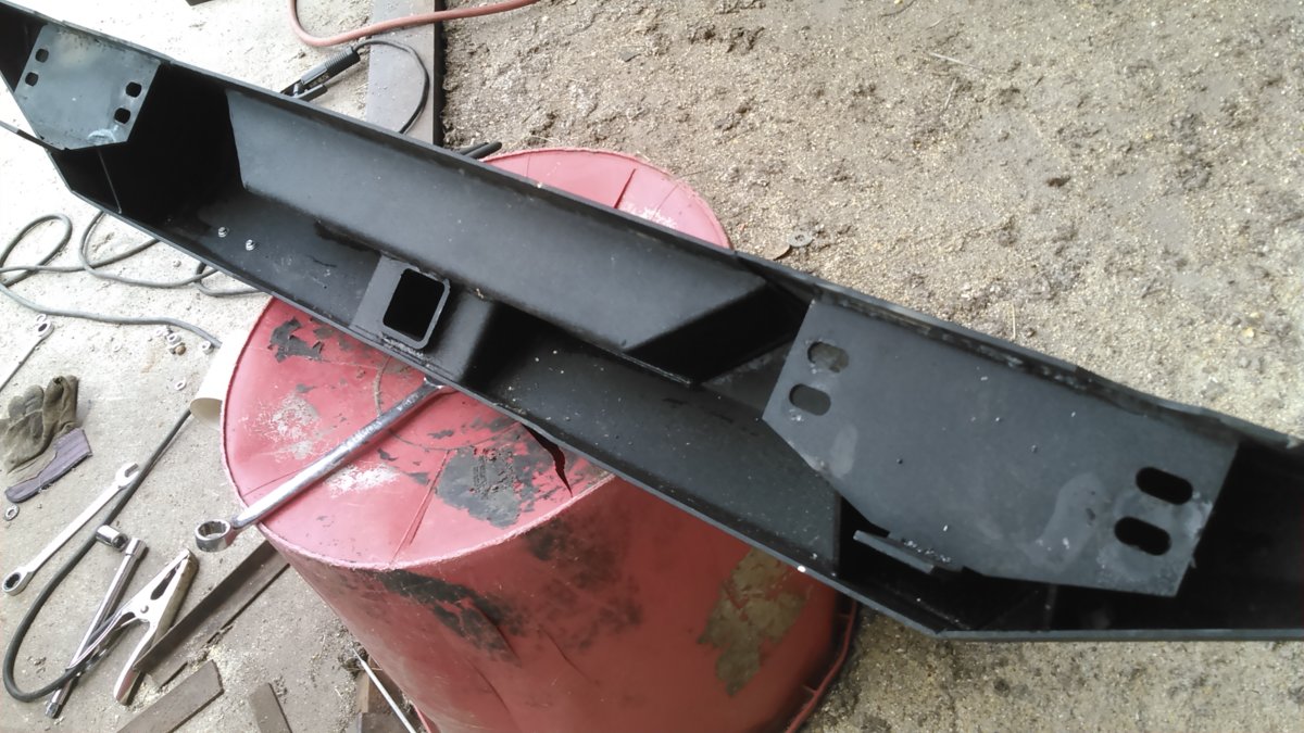

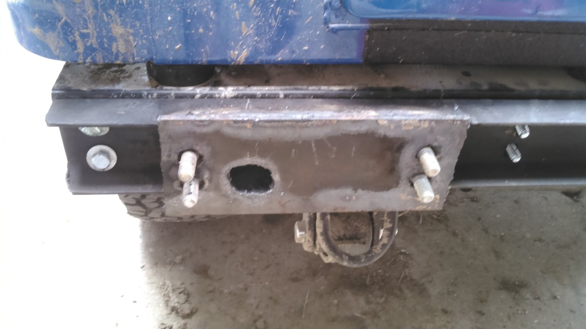

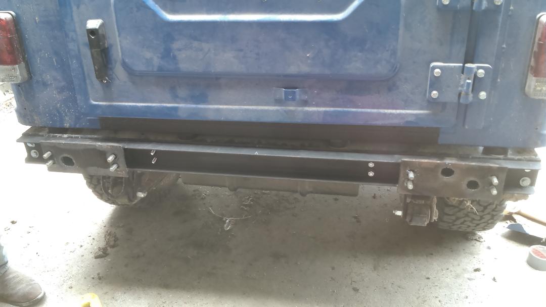

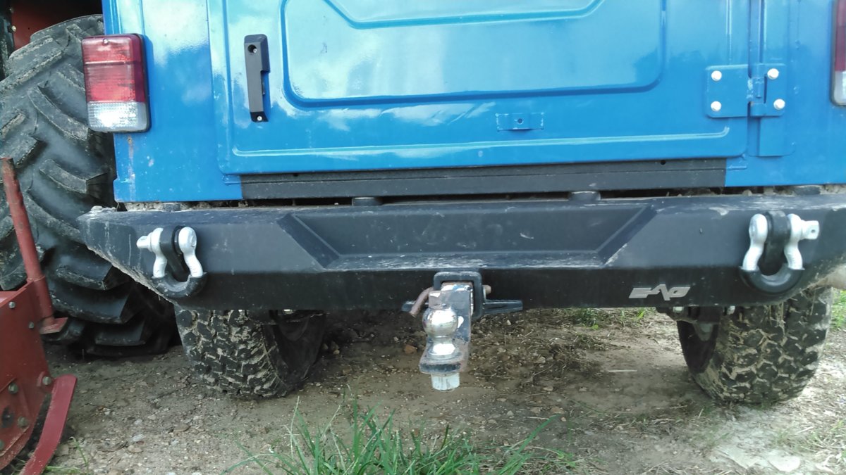

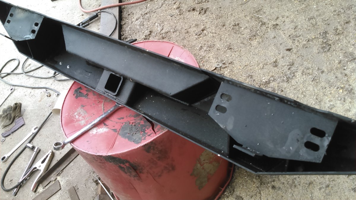

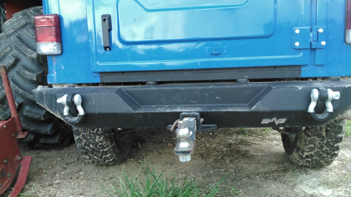

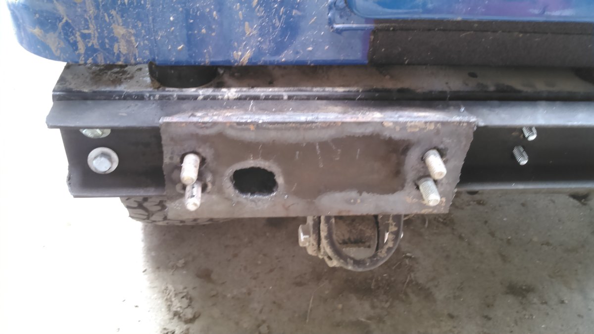

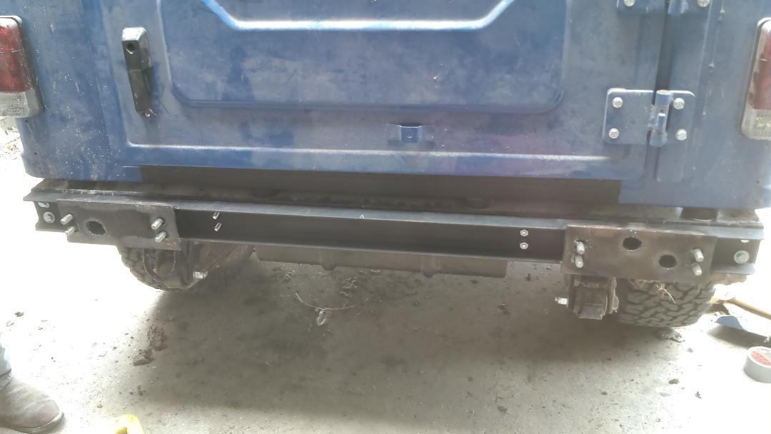

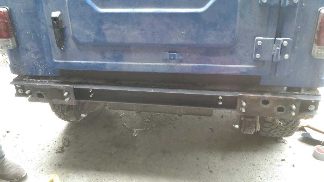

I added an EAG rear bumper to my Roxor and will post a picture when I can. Basically though, a piece of channel was placed all the way down the thin oem and bolted at every hole where my hand or a wrench would fit. Then 3/8 plates were welded on each end the Eag was then bolted on. looks good , sturdy and I love the hitch/ step up bumper.

I don't do much email so hope you get this.
I found the link to my bumpers on here back in March. They were on sale at that time and even included free shipping. I believe it was from vicious offroad. I posted the prices I paid on a thread but can.t remember exactly but it was less than 400 for both of them left on the doorstep. We can weld so that made it possible but they are NOT a direct fit . The width is right on the ones I ordered though.
We put a piece of thick channel iron with bolt holes cut in everywhere there was one in the oem, (BY clamping it to the thin oem and I took a can of spray paint on the back side and marked all the holes that way) bolted it then on the thin oem at every bolt hole reacheable, and then welded a thick plate that lined up with the mounting brackets on the EAG onto the piece of channel. (We got it lined up by bolting the plates to the EAG and marked the channel ),. Took it off the EAG and then welded to the channel and then bolted the bumper on permanently back on. I see if I can find that thread. bordercollie

View attachment 4264View attachment 4265View attachment 4266View attachment 4267
Great job, thanks for the pics.

This is one of the links . The sale price is listed in the header ( $123) but not in the post - maybe it was edited after the sale went off., or I still need to find the right one. If I remember correctly it needs to be for a 87-06 tj jeep. The later ones won't do according to what I read. Just be sure to check the measurements as far as length . Will keep looking for that mystery post https://teamroxor.com/threads/eag-tj-bumper-works-easy-to-fab-and-on-sale-123.1049/ I am sure gratefull to the original poster- Isure need to find that thread and thank him.

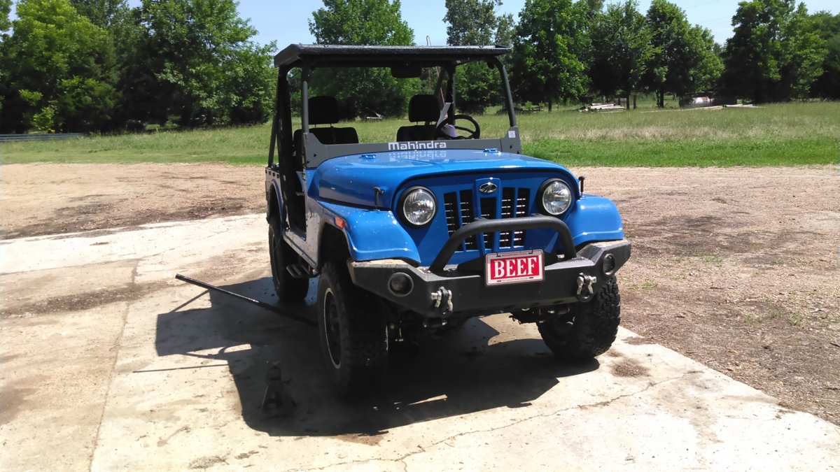

If your question is directed at me, I'm measure it in the morning and post back . It is very close though to original and does not look wonky. ( Click on above pictures to see larger picture of the set mounted). I use the rear bumper constantly on the farm (off road only) and pull mineral troughs on skids with no problems as well as small fallen trees and clumps of large limbs . That is unless the calf scale is in the hitch (Oct -Dec) .
We did a dry run with each bumper before welding anything to see how much room we had to "play " with. As you can see in the front bumper picture once enlarged, there is very little spare room between the fender and the bumper but it did fit, with ,the sized plate we used to weld and use as a mount. The plate has to be thick enough to work though and the size I posted is doing good for me.
