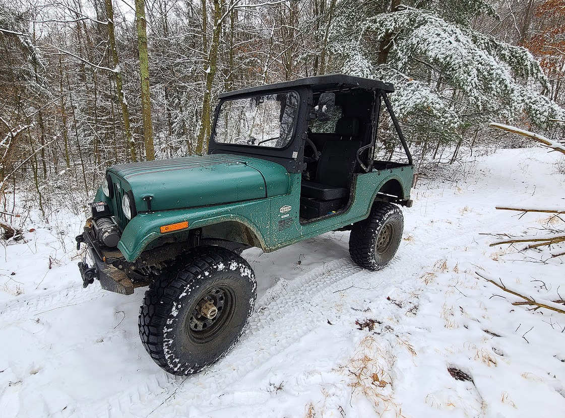

I just wanted to give you all a warning. The rough country 5" lift with 35" tires (at least for my machine) requires longer drive shafts. In switching to a twin stick configuration, I disconnected the front drive shaft. in putting things back together, I quickly realized it is fully extended to the end of the yolk as it sits on level ground. This is not good. I contact RC via phone, but I doubt they will offer the warning on their site. Even worse, they will likely miss the opportunity to upsell better drive shafts from Torque King.
