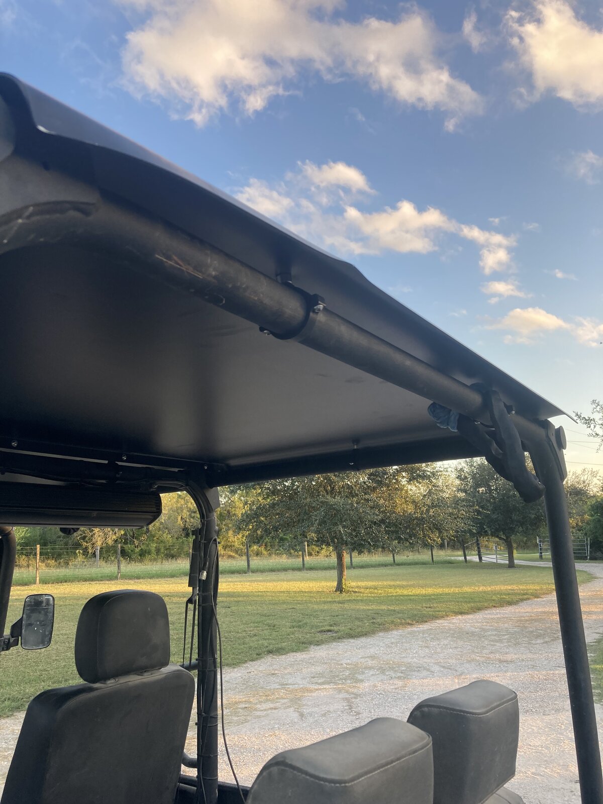

I have it. I’ll take a look tomorrow and see if I can see where the spacers are. It’s been a few years since I installed it so I’m not sure what goes where.
1,226
I found this pic on my iPad. You can see the spacers on the rear section of the top. Does this answer your questions?

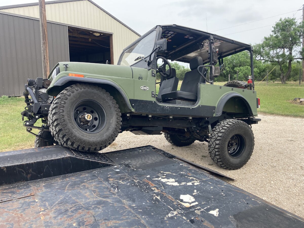

Mines over the top of the frame. but a folding one will be different of course. Sounds like you’re gonna need to call OTR.

They are. i did the windshield first then a few years later the top. shortly after doing the wimdshield I found out they started shipping them with some foam and OTR sent me the foam no charge for mine. The foam goes on the windshield frame and seals against the roll bar. Everything sits tight up front with no gaps and the frame is sandwiched between the top lip and the roll bar. If I’m not mistaken I think there also might be a strip of foam between the top and windshield frame.
