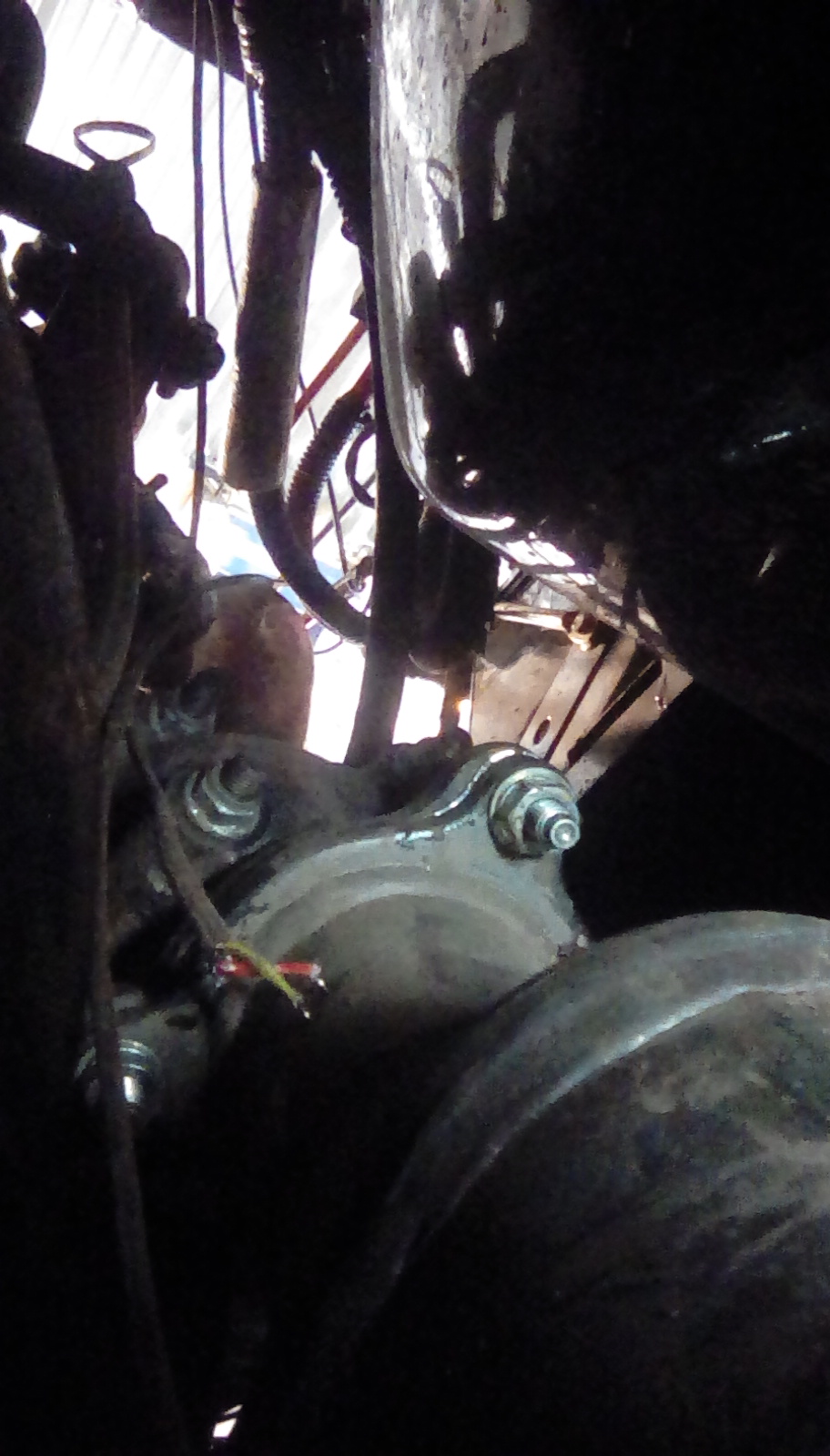

This is the location of the pre turbo tc. It is on the cast section just above the turbo inlet flange.

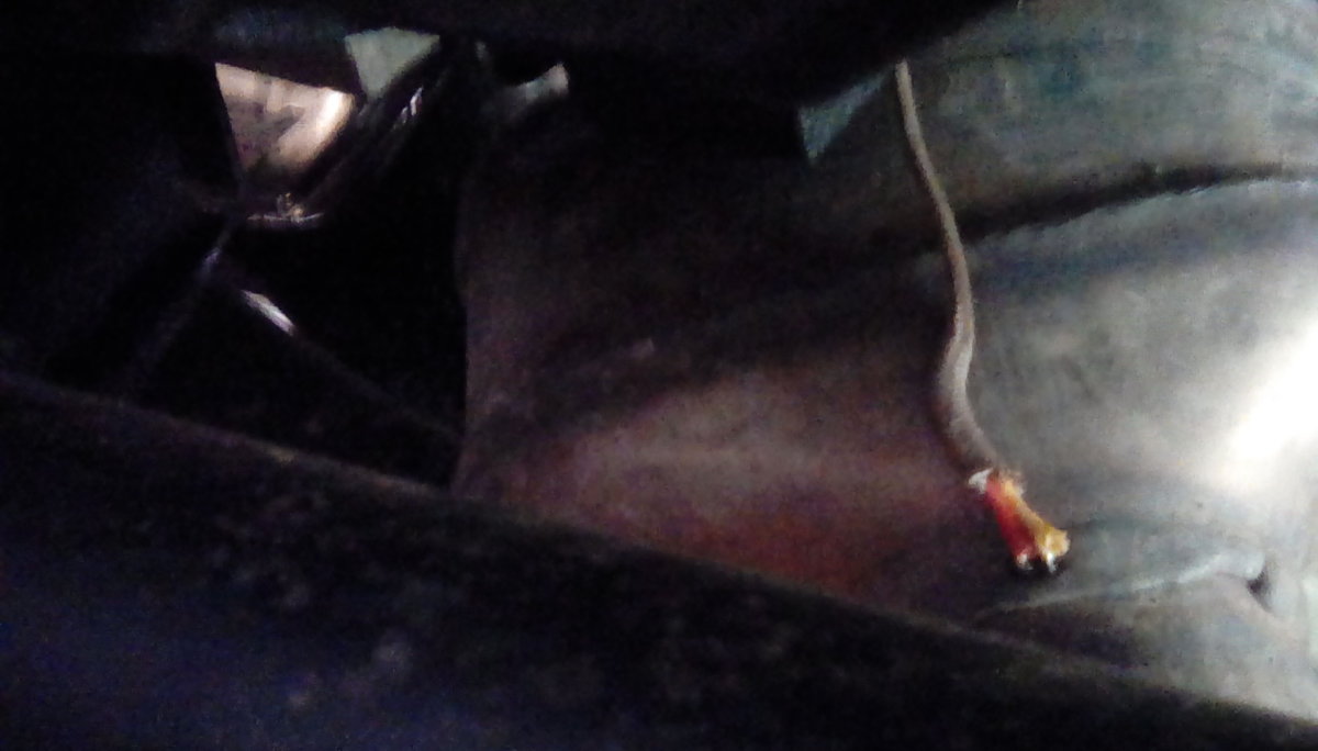

This is the location of the post turbo T/c. It is just below the turbo on the exhaust pipe.

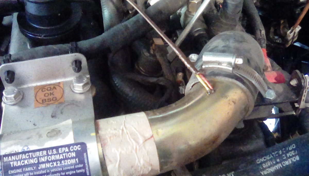

This is a T/c attached right below the exhaust filter.

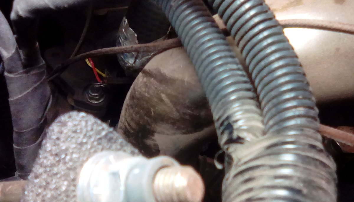

I also tacked a thermocouple on the air inlet before the grid heater
Saw 140f ,but only watched it once.
