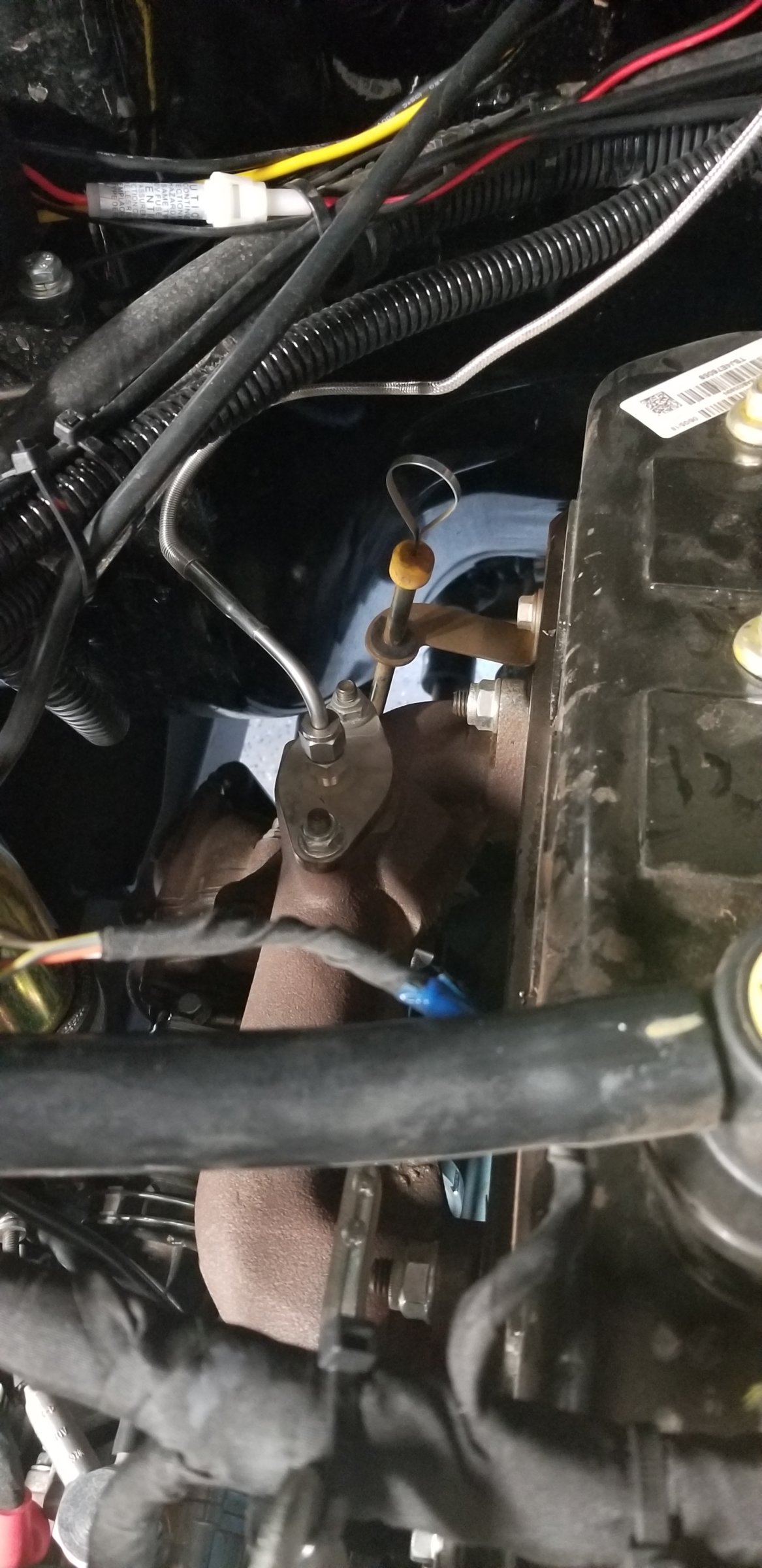

Is your thermocouple pre turbo or post turbo? If it's pre 1100 is what I would be comfortable with. By that I mean floor boarded till it stabilized all day long,maybe 1300 for a second. Post turbo, maybe 950 all day. Keep in mind that if the thermocouple burns off, it will go through the turbo possibility harming turbo. That is why some folks mount it post turbo. Pre turbo reacts faster,and gives more accurate information. I think using the egr to see what it is preturbo, then moving it post turbo would be nice to know.

Here's what I've got. Deleted egr, flashed ecu, cold air intake, 2.5" exhaust, cat delete. Attached is where the egt probe is.
