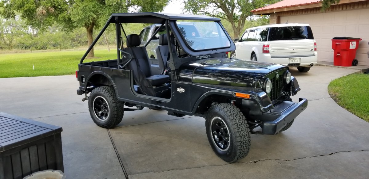

Had the steel roof and flip out windshield installed by the dealer. The roof and windshield come from "the Perry Company / Fortress LoPro Aftermarket" in Waco, TX. It's about $1000-$1200 for both installed. It appears Perry does not deal to the public so you will likely have to find a dealer that can get it but it's way worth it.

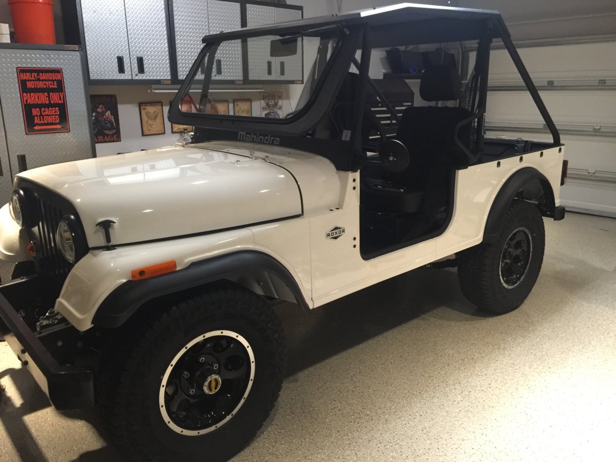

I also run the Fortress set up. Its a compromise as far as convenient and practicality. I do like driving with the window swung out, well till I hit 40 mph and it slams shut and scares the S H I T right the hell out of ya! WHAM! Then you back off the peddle and it flings back open. HAhaaaaa. DANG!
I think a small stay rod added at the ends and one in the center would solve that WHAM issue. I will also say that now that I have seen it do the WHAM, I look for it and the speed at which it occurs, calculating the head winds and gusty wind. So as it starts its " OH I'M ABOUT TO SLAM SHUT GIGGLE WOBBLE ", I reach up and snag the center handle and pull it home to the stowed position and hook the drivers side yeti style lid latch onto its snag point. Its habit after 125 road miles.

Yes mine too closes at 40-45+. It is nice when just putting around the ranch at slow speed on a hot day. Some sort of braces or something to "lock" it open would be nice. Mostly I like that its glass and not plastic. It is well made at least. Time will ultimately tell but I do not regret it.

I see in your pic of the black beast that you are not running the windshield wiper. It is a tad pricy but once installed and made to work, it does a great job.

I installed the top, windshield and wiper kit. I haven't had the chance to drive it yet since I am waiting on parts at powder coaters. With the bigger tires and fender flares the front tires rub the flares so waiting on a lift from On The Rox. Once I get it installed it will be ready to roll.
I just had the dealer order it for me. Seems really pricey at 230 for a wiper but hopefully the quality makes up for it.
Like I mentioned in past posts, others have dealt with small install issues easily. I added a washer on the post that mounts to windshield, so a brass nut is not all there is between black powdercoat and the nut. You will also need to re locate the wiper blade pivot hole 3 inches from where it is centered or someone else mentioned they shortened the wiper arm. You may need to drill up a hole in the slot provided for the lower motor mount bolt.
I wired straight to battery lugs for now and replaced the provided in line glass fuse with a blade type that is encased in rubber, Installed near the battery hook up. Convenient high low switch on driver face of unit.

My windshield is sealed very well all the way around the outer edge of the frame and there is weather stripping they put between the top of the frame and the roof so no air or water comes through. I have had a chance to drive it in rain and the only water really coming in was around the sides from the tires (need some moderate fender flares) and over the top back around from the wind. As far as the windshield, its glass, so I rainx'd the heck out of it front and back and wipers are not really needed. I guess I want a wiper just in case but honestly it's just a want. Not a need. But if I get one, does not matter to me to mod or fab a little, I enjoy that. What I want is quality hardware. Which is why I ask for pics and opinions.
