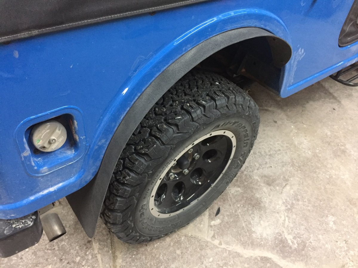

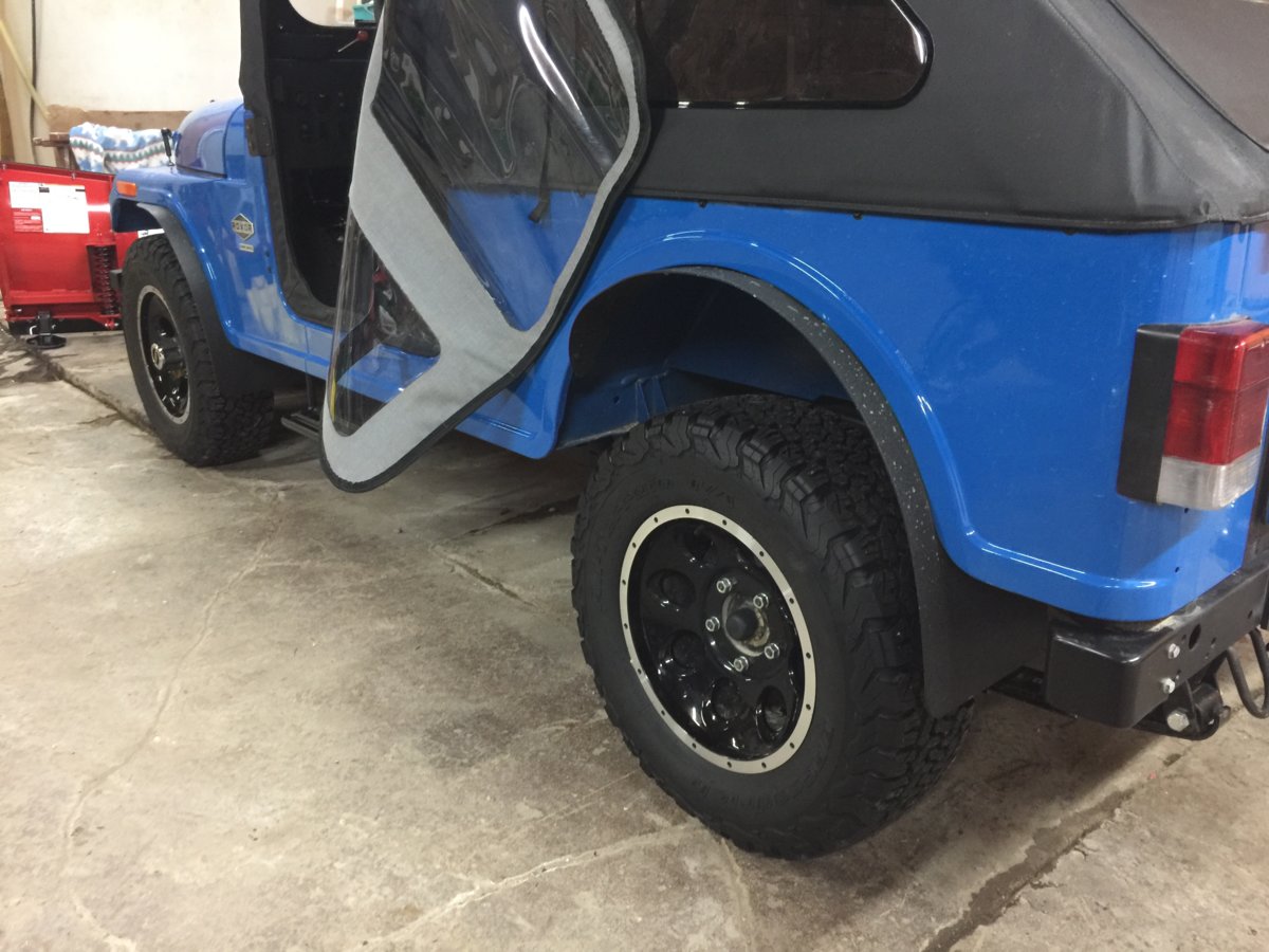

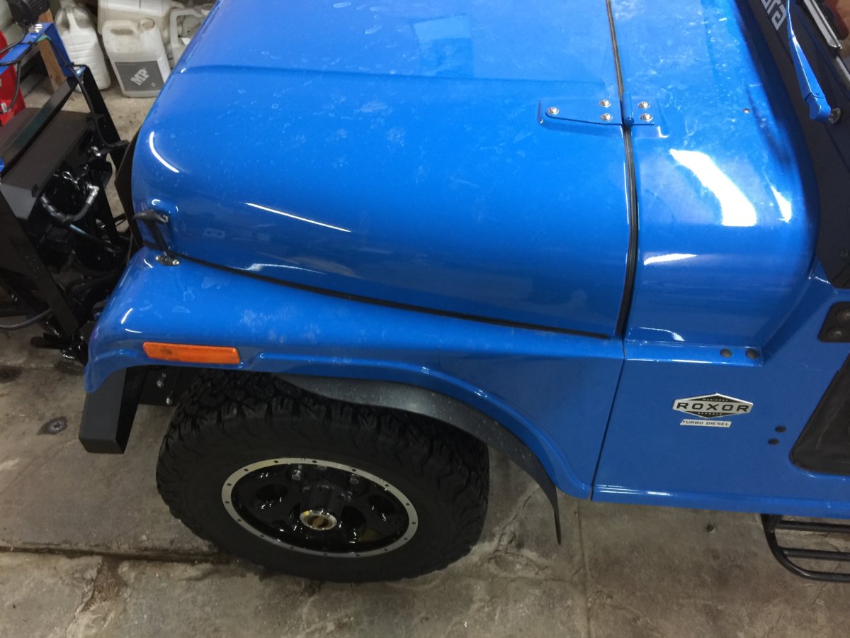

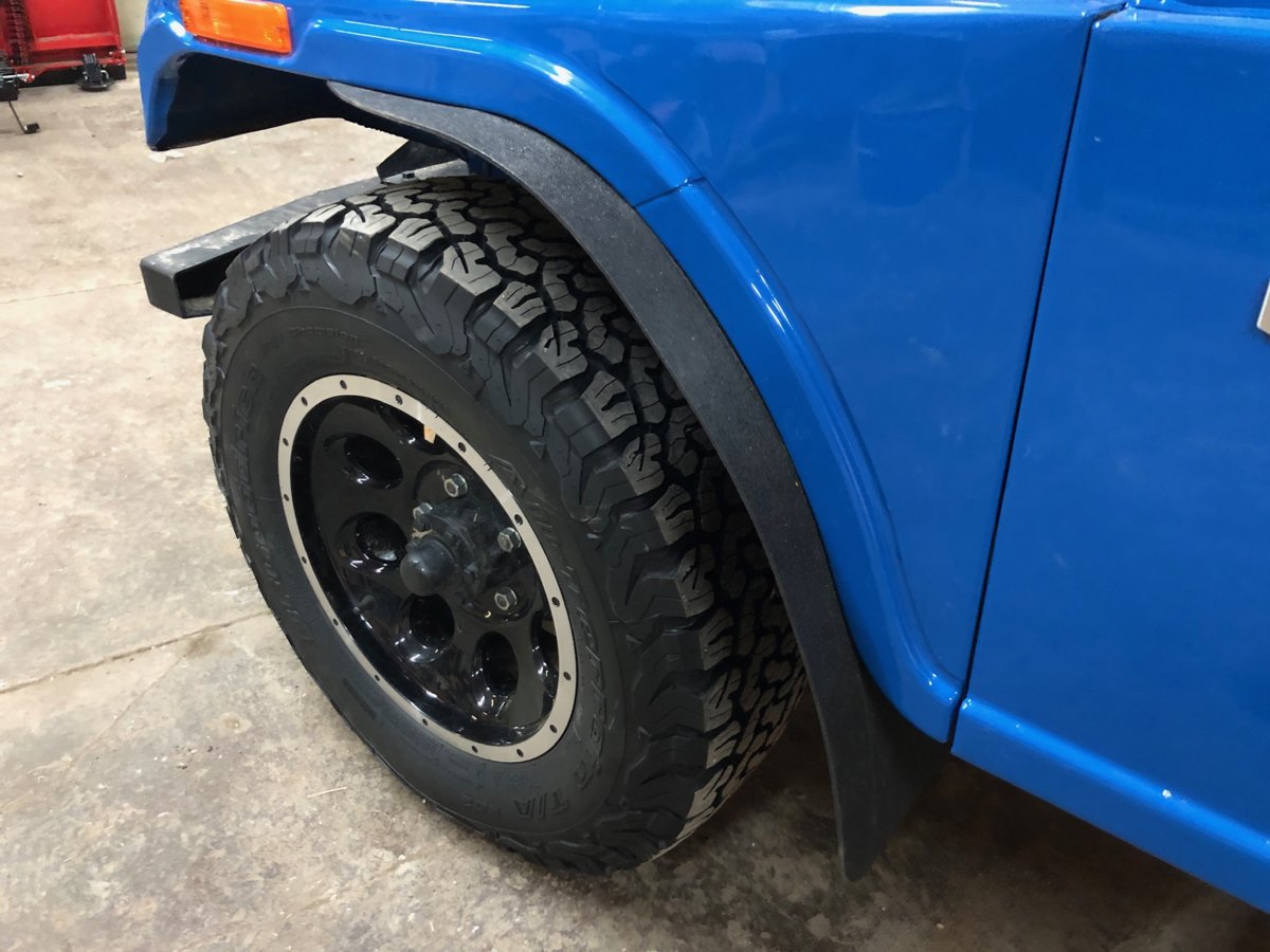

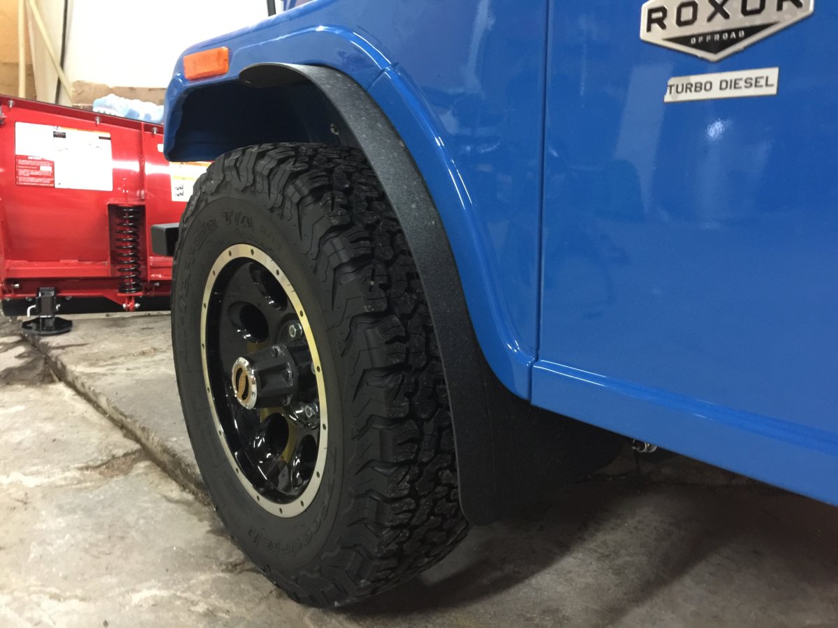

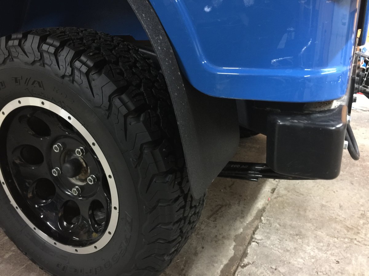

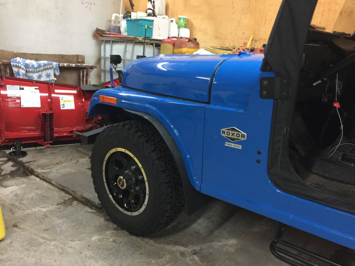

I put these on. 36”x12” on the front and the 48” ones on the back. If I did it again I would probably do the 48” all around. I left them fairly high so I don’t tear them off in the Bush. The rear one will really help keep the crap out of the tail light area. And the lip will keep the crow crap off me in the summer. Lol

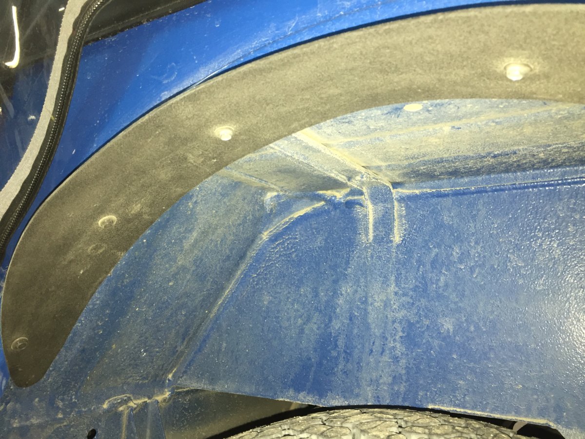

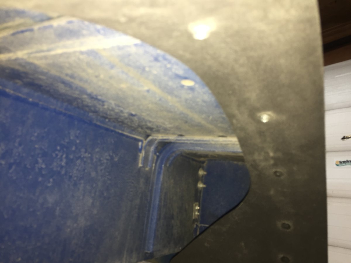

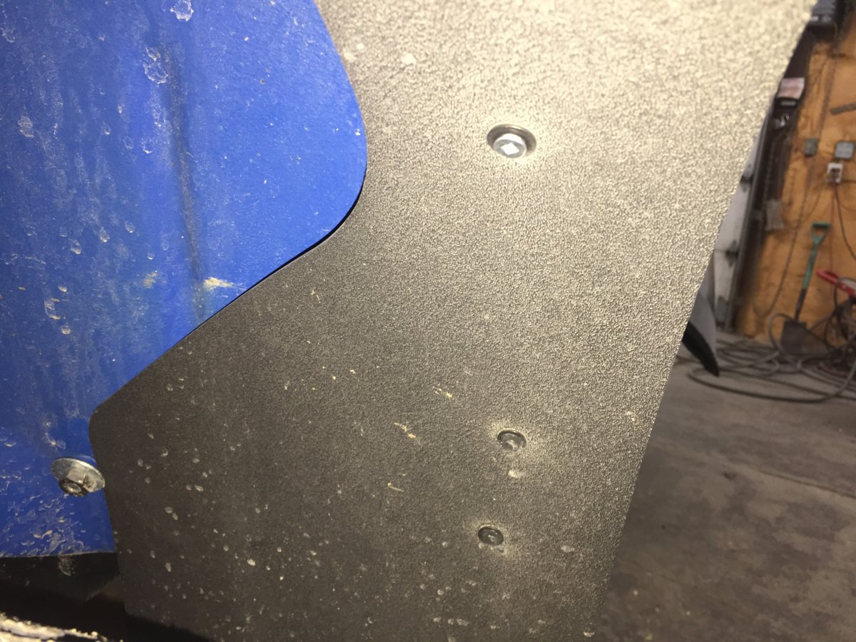

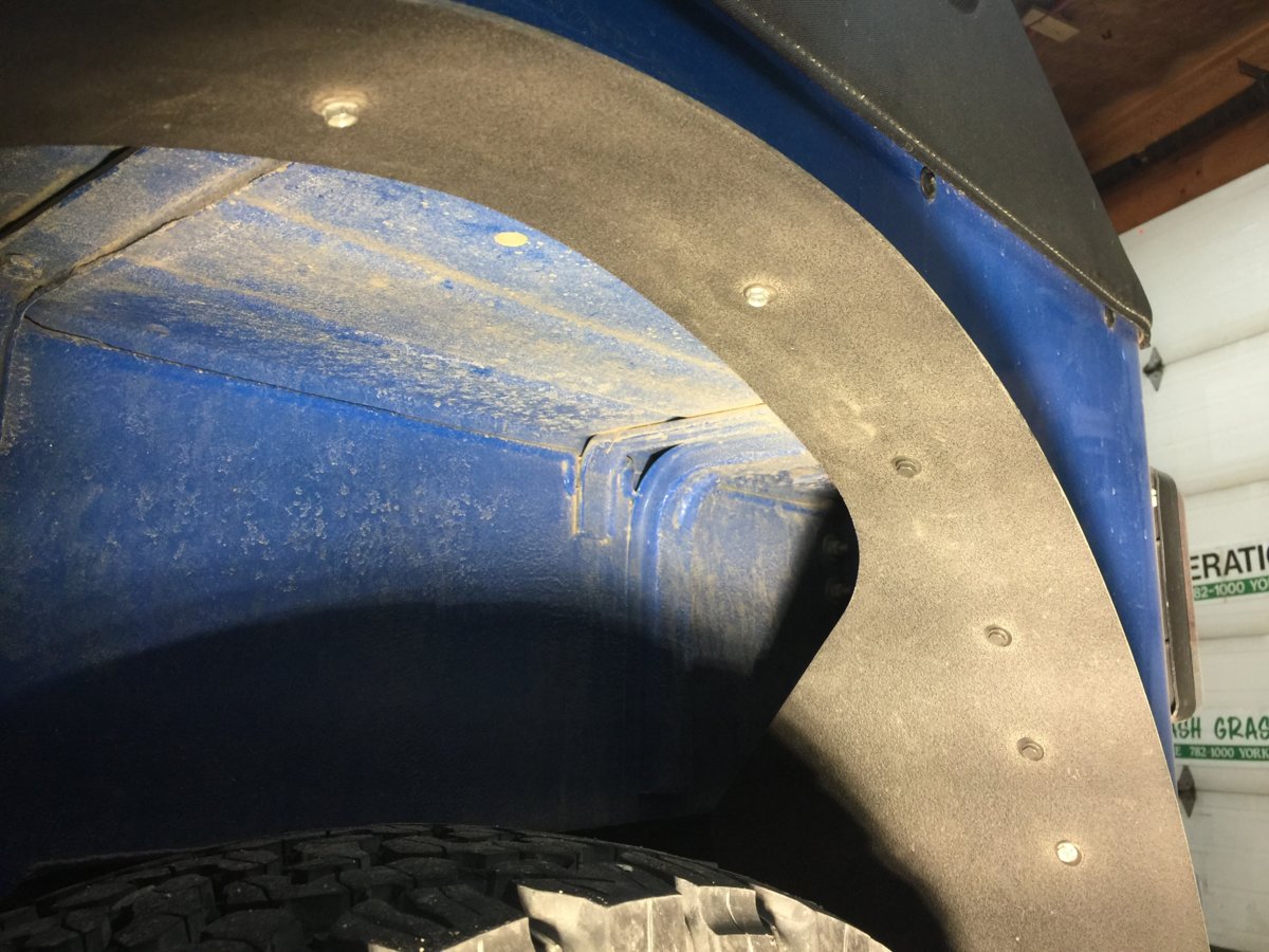

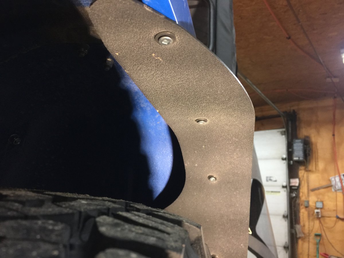

Picture of how you mounted them please.

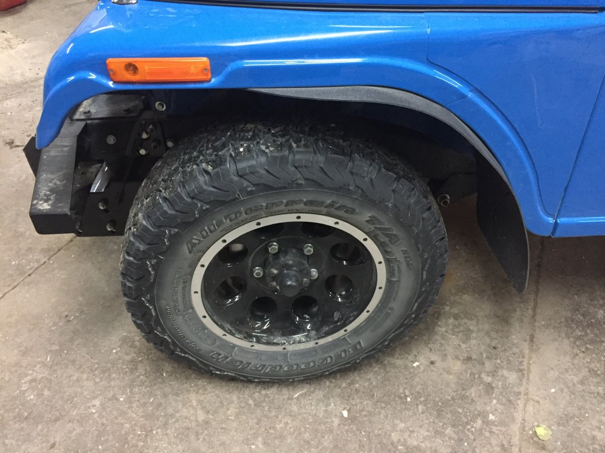

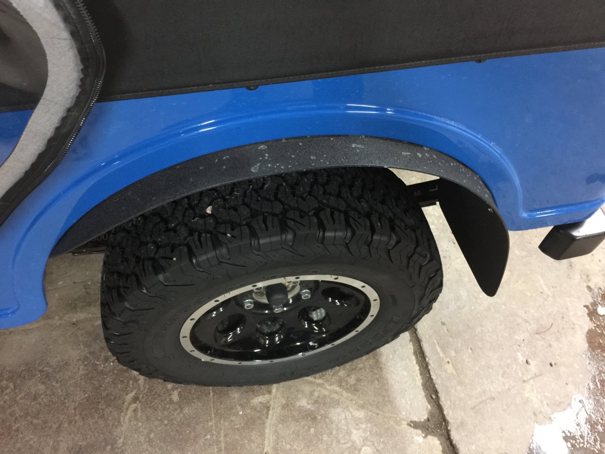

I just used the tap and drill screws and the washers that came with them. On the front ones I used small stove bolts through the existing holes where I could. I can get some tomorrow if I remember.
On the front, as I mentioned, I used existing holes where I could; those are the grey stove bolts. Anything that is black is the long tap and drills that came with the flaps. On the back, at the top of the wheel well the long tap and drills would go through the inside fender cause of lack of room, so I used some short ones I had and placed them as close to the top as I felt comfortable. I drew a 2” line on the flap to give me an install guide. Then I clamp and fought with them to get them as straight as I could. Nice thing is the straight body. A helper is suggested. Lol

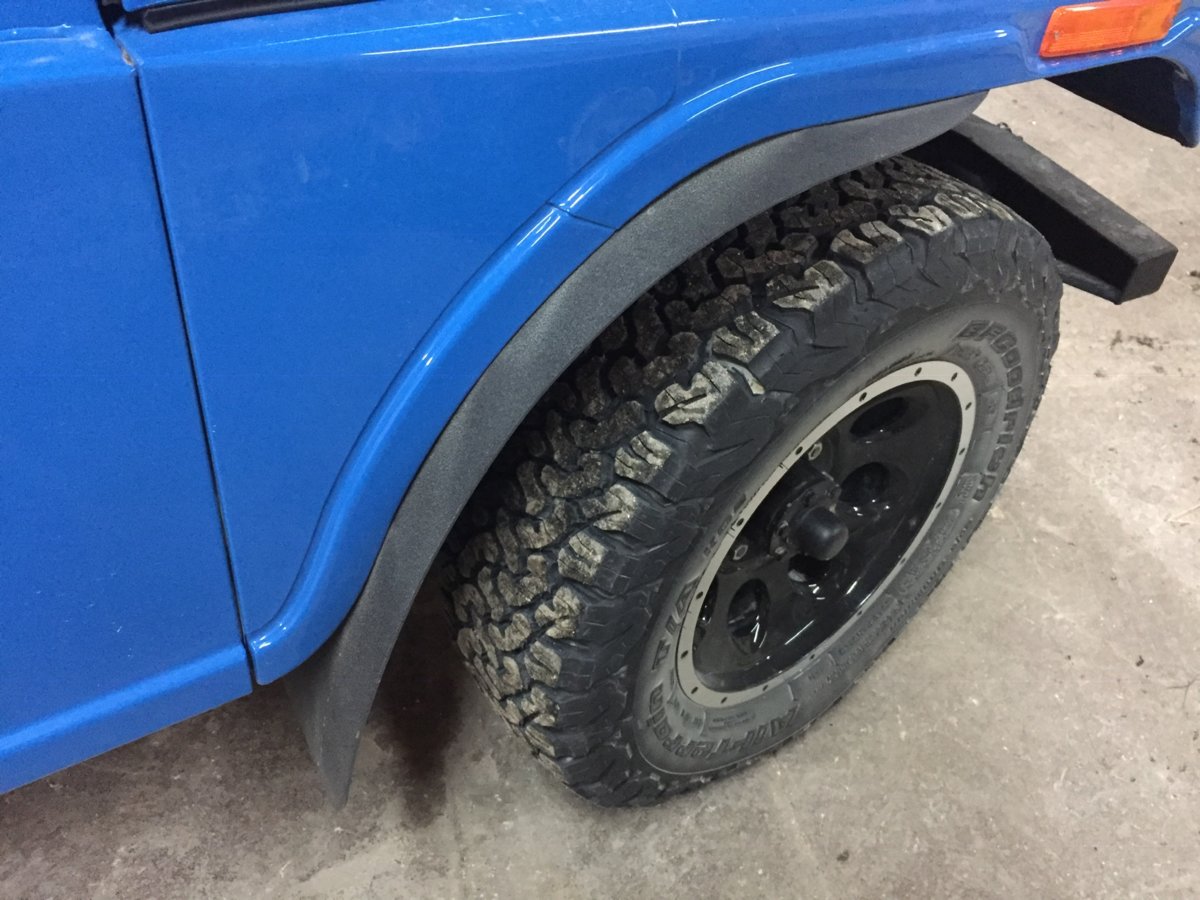

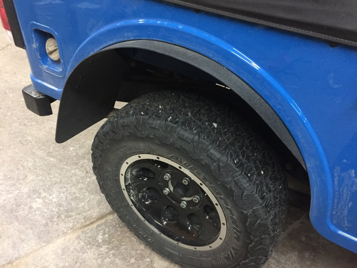

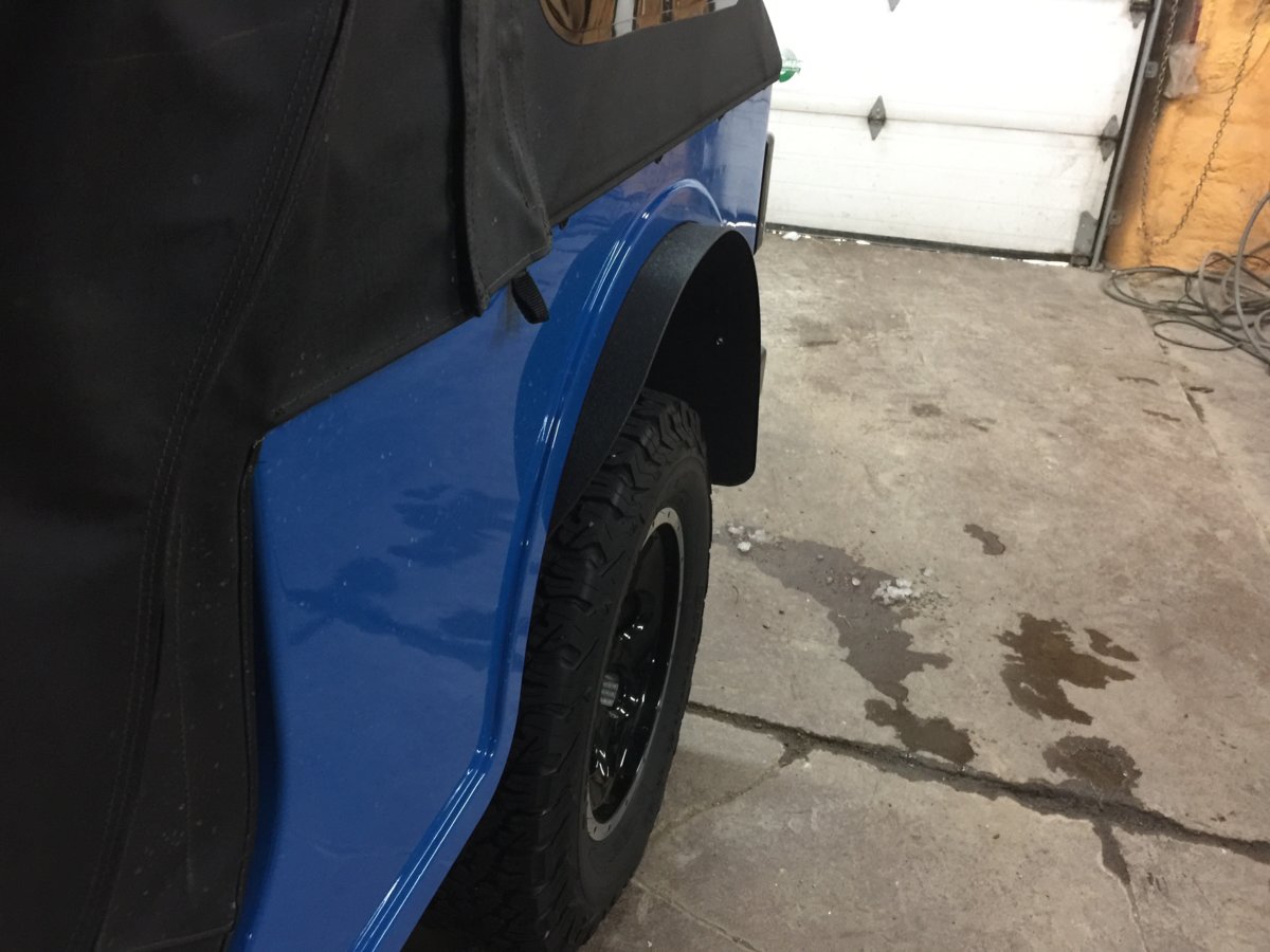

My spacing could have been better, but hopefully im not laying on the ground looking up at them too often.

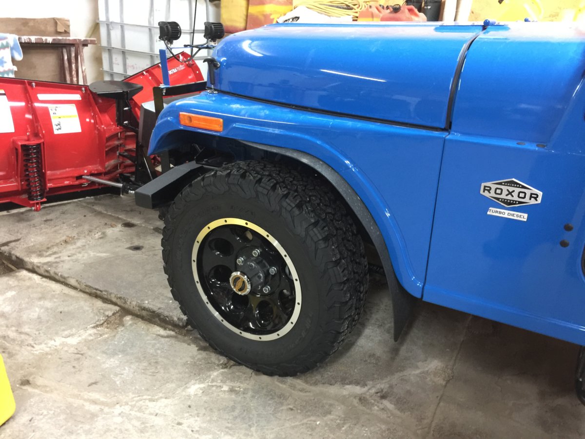

When you get a chance can you post a pic standing back a bit so we can see the complete vehicle and how they look from that vantage point?
where did you pick them up from?
Amazon. Ebay has them also. Dirt Legal has the 36” ones listed in there page. I like the 48” all the way around. Another guy on Facebook “Mahindra Roxor Enthusiasts” did 48” front and back. He kept his up high also. That’s a personal preference thing.
Nice, thanks.
Sorry I took so long, the post slipped by me.
Edit: I would do 48" on the front if I had to do it again. I didn't know how they would work so I ordered a set of 36" first to see what they were like and I knew I would want the 48's on the back for sure. I have a 2" side overhang.
