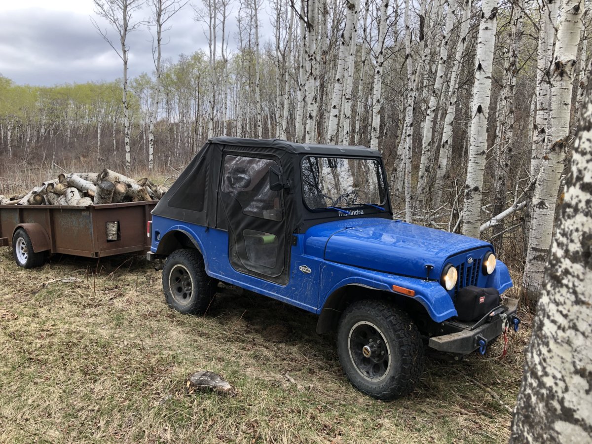

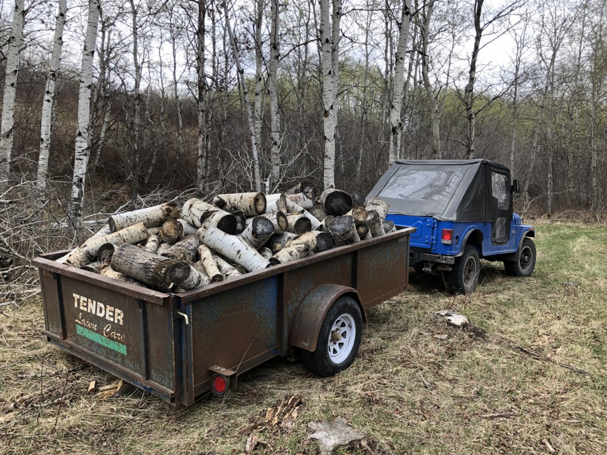

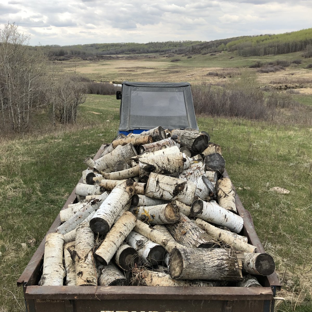

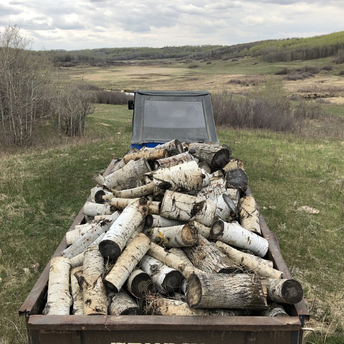

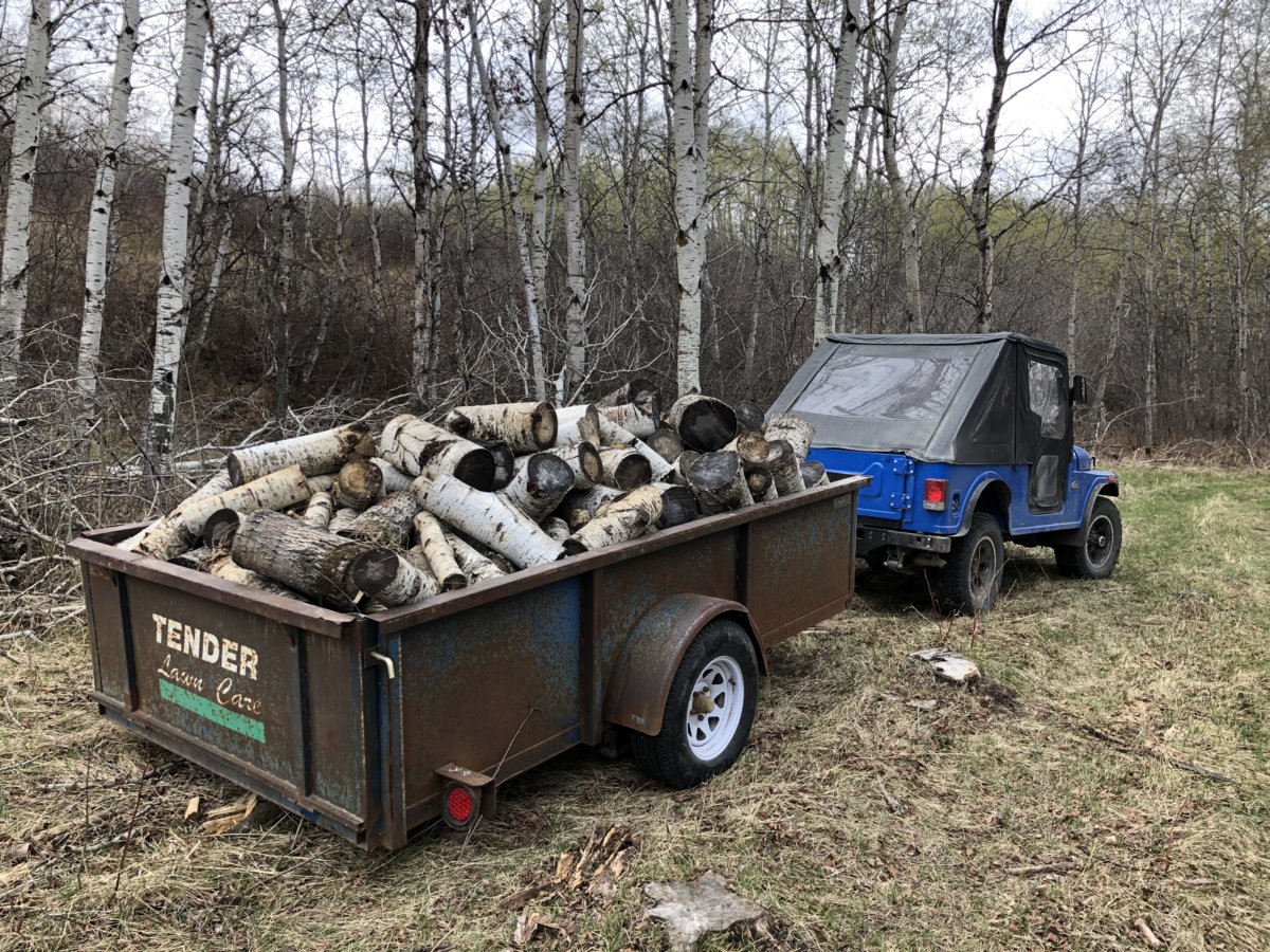

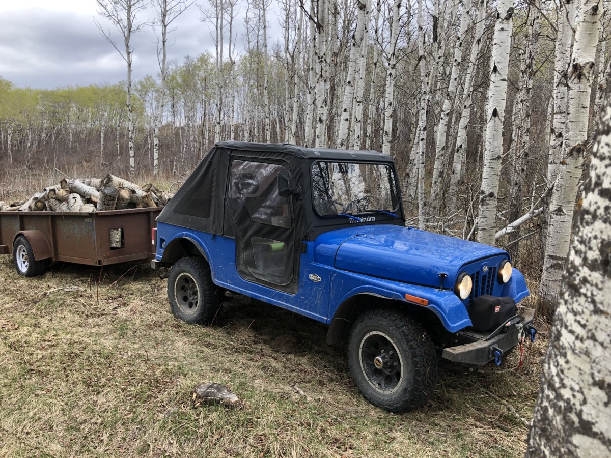

I don't think you will need anything extra. All 4 of your wheels will be on about the same type of ground/traction. Lockers are more important when wheels are on different surfaces or mudding/rock climbing or not on the ground at all. I drag around trailer that holds about 2/3 - 3/4 of a cord of green aspen (about 3900-4500 pounds for a full cord according to various sites via Google) in 2 wheel drive and I have no problem. Once in awhile I do have to go to 4 lo and I do have the warn front hubs plus front and rear lockers, but the lockers are not really needed for that situation.

View attachment 4269View attachment 4270View attachment 4271
Good shots. We are using an ancient Chevy pickup, ancient. Never a problem. I’m sensing a theme here. This truck is going to be stuck on this California Vineyard, I’m not going crazy, I don’t think I need anything extra. Btw what type hitch do you have?
If that truck handles it with ease, so will the Roxor.
