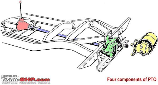

Is the Roxor transfer case a Dana 18 design?
If so, does it have a removable plate that allows the connection of a PTO something like this with the old Jeeps?
(here's where I'm going with this. I'd like to drive a PTO generator)

The TC is 'based on' Dana 18. The PTO related sections INSiDE the case were removed decades ago and that space taken up by other parts. So opening that plate will reveal a bearing and other assets unrelated to PTO. ie, you can't do any bolt on jobs. TC itself has to be redesigned back to original D18 form for that. Also, there's that fuel tank in the way of any conventional PTO shaft.
MANA is said to be working to bring back the PTO.
