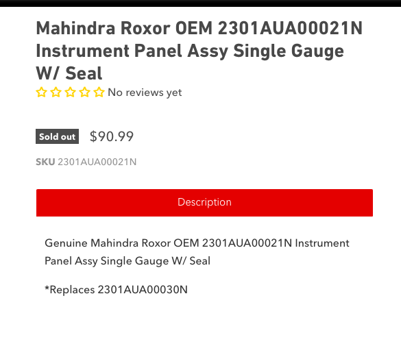

Mahindra Roxor OEM 2301AUA00021N Instrument Panel Assy Single Gauge W/ Seal if they ever come back in stock looks like $90

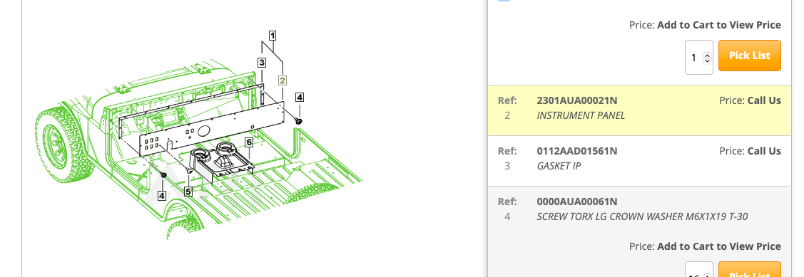

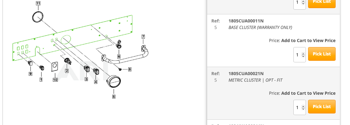

That part number doesn't match up with the parts book (close though), but lots of stuff is out of date on the site. I know that gauge was over $600 before for sure. It would be nice if it is available for $90 for sure. Maybe they smartened up. lol
Even the old part number doesn't match up.
