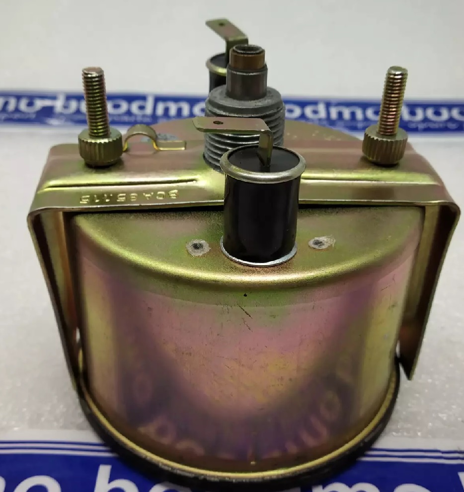

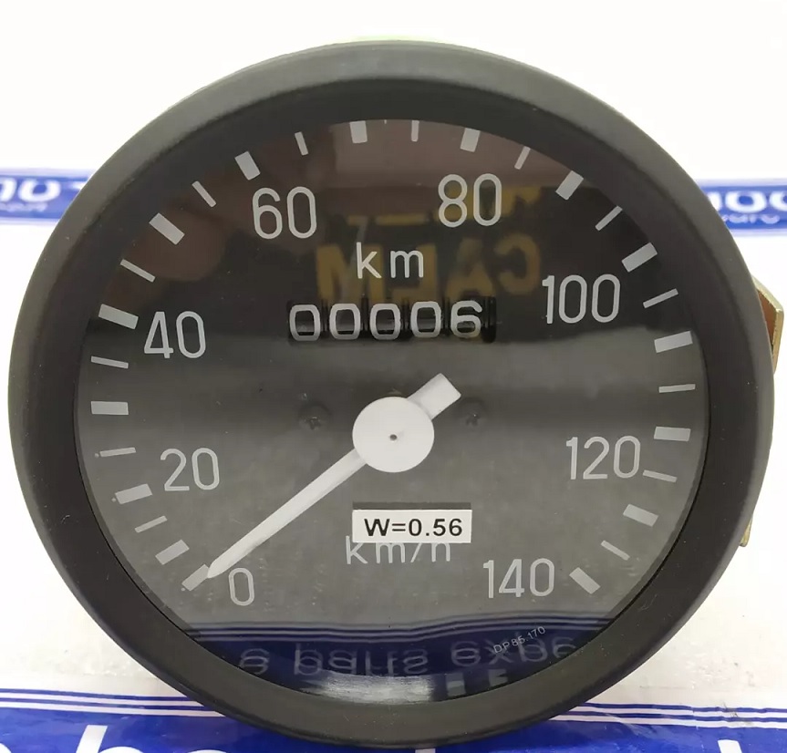

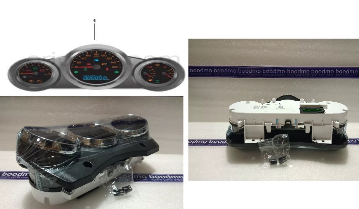

Its painful to see such a small cluster creating headache for so many,Pls check the attached speedo & other stuff in Mahuindra Thar ,If these can resolve your concern let me know i can arrange same at very reasonable cost

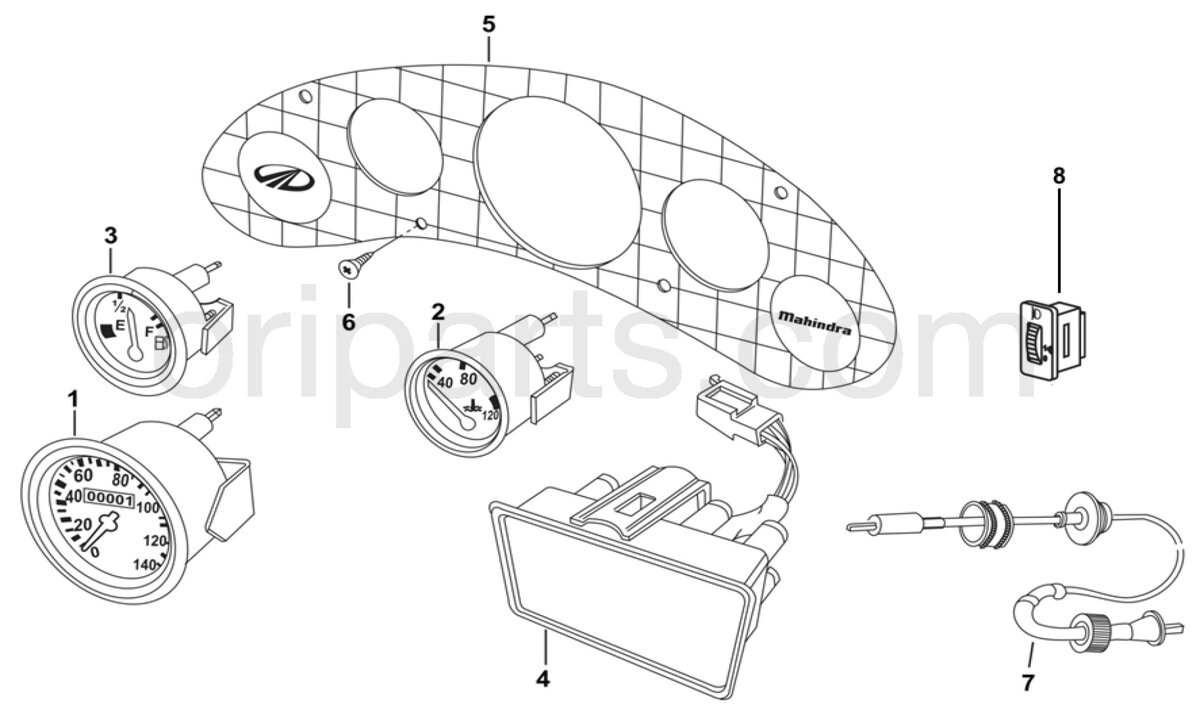

This attached picture is for Thar 2nd Generation cluster
