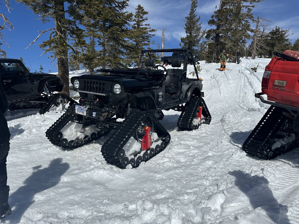

Guys:
I have overworked my steering running tracks
I found a company that taps the steering box for the Roxor and sells a kit
I an putting a heavy duty steering kit in
What will break next? The ears on the knuckles?
I have debris in the fluid from when I overheated and clogged my Power steering pump, they seem to be easy to come by
Where do I get a spare steering box? Or is this easy to clean out or is there a crossover from redhead or someone?

I know of no one that has tapped the stock box and is still running it. 2 issues. the stock pump does not move enough fluid for it. 2 the boxes don't hold up. Originally there was a company that would drill your box for you but they stopped because of the number of failures and that you could not get individual parts for the steering boxes once they fail to rebuild.
Personally I use a PSC TJ XD box with a TC style pump and hydraulic assist. It works great but did take a good bit of roxor modification to make it work. Jesses Hanies's roxor is also now using the same set up I went to.
One finger steering sitting still with the locker on. It's great! I can literally wedge my front wheels up against a rock and steer and either the entire front end of the roxor will push over or the rock will move.
