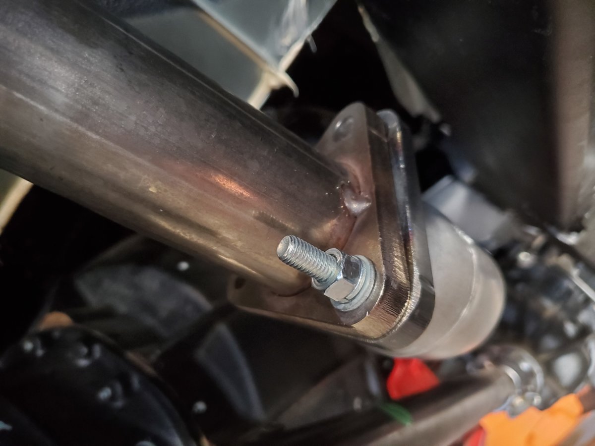

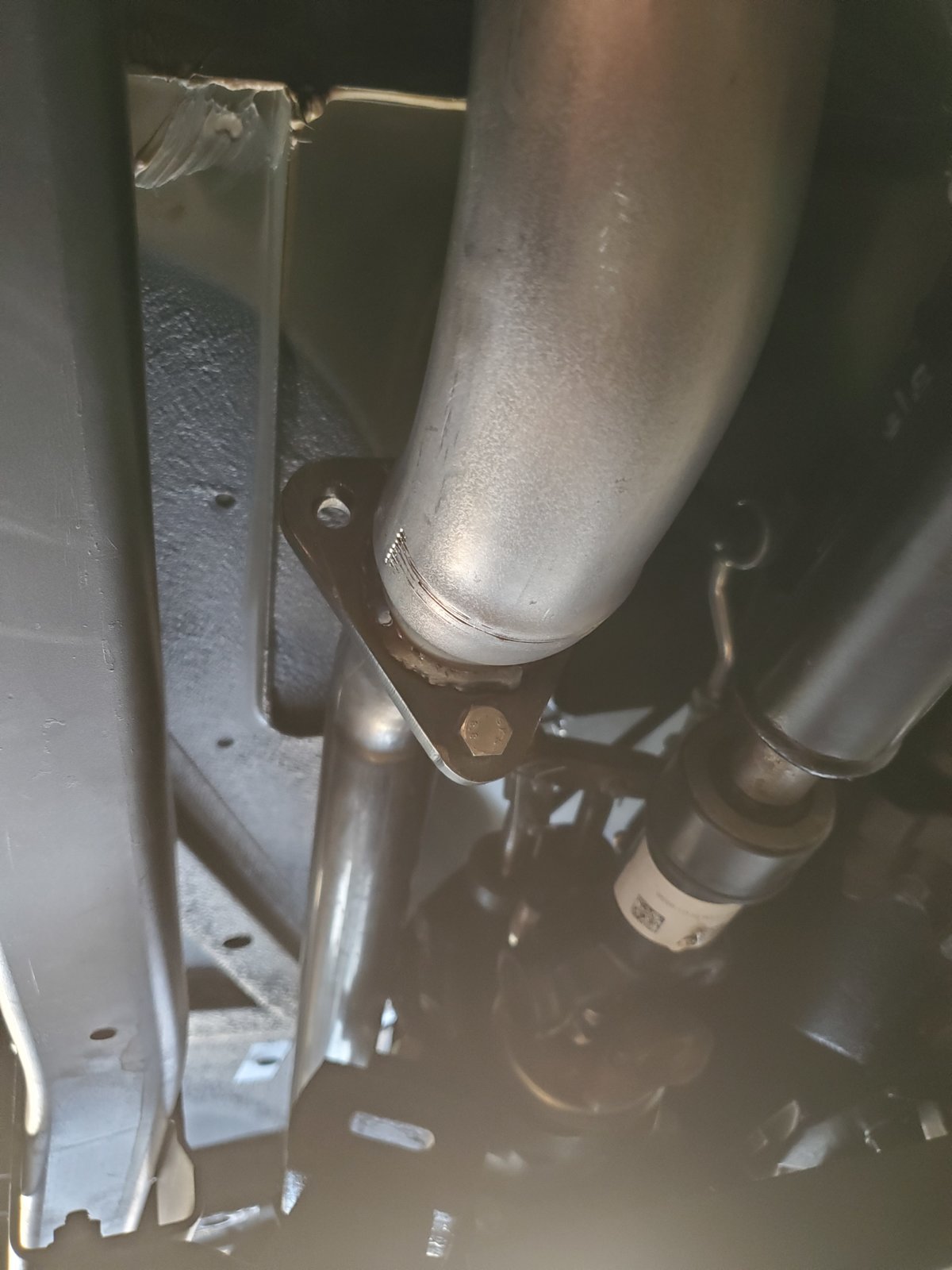

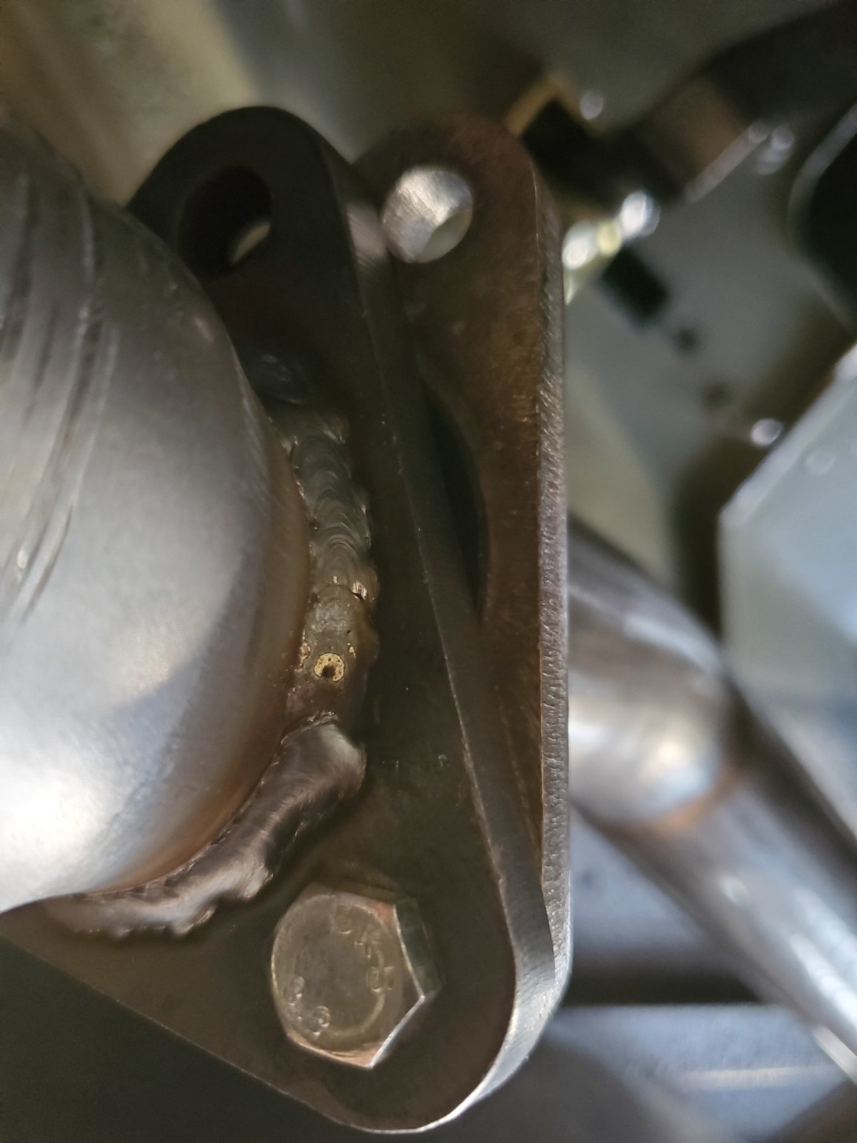

Has anyone had fitment issues with the Highflo Performance downpipe? I ordered through Diesel Freak and installed today but it does not line up with the factory mid-pipe. I reached out to both Diesel Freak and Highflo Performance so hopefully I'll hear back soon.

Mine was about a half of a bolt width off on one hole, I just opened it up a bit with an angle grinder. If yours is off as much as it looks in the one pic you’ll probably have to return it.
