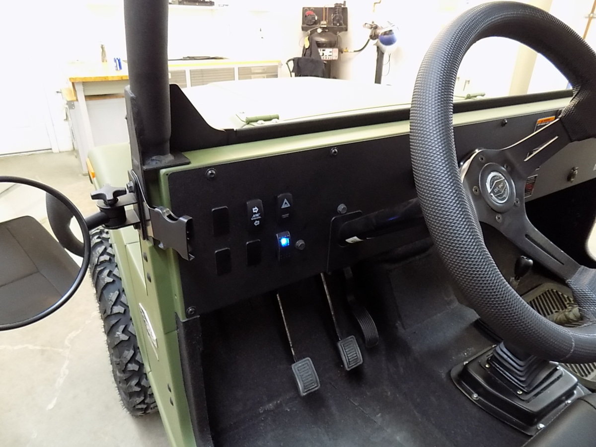

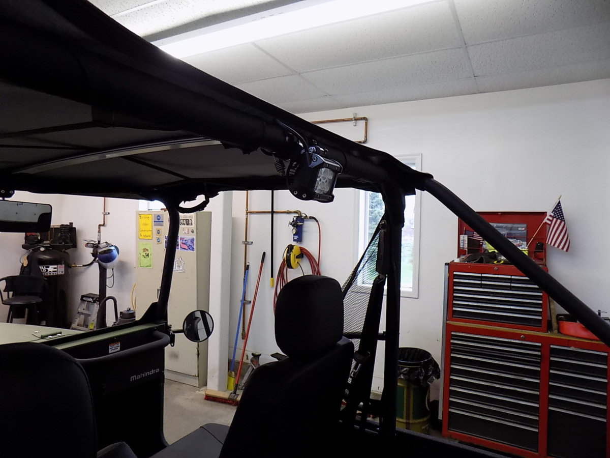

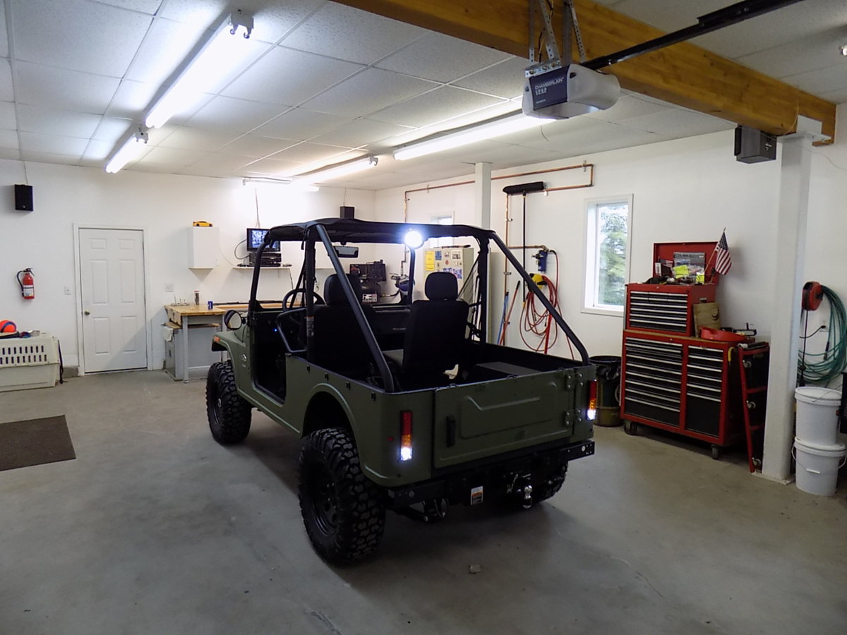

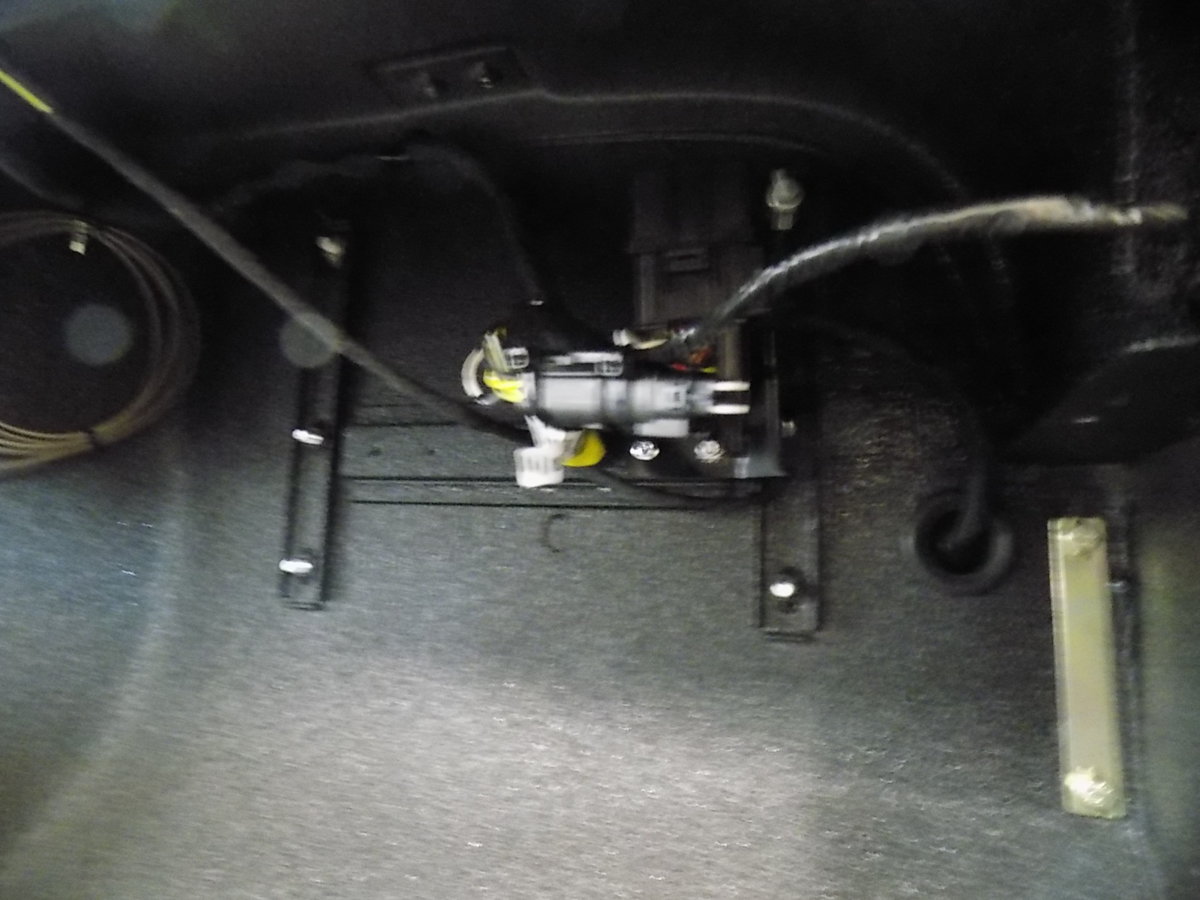

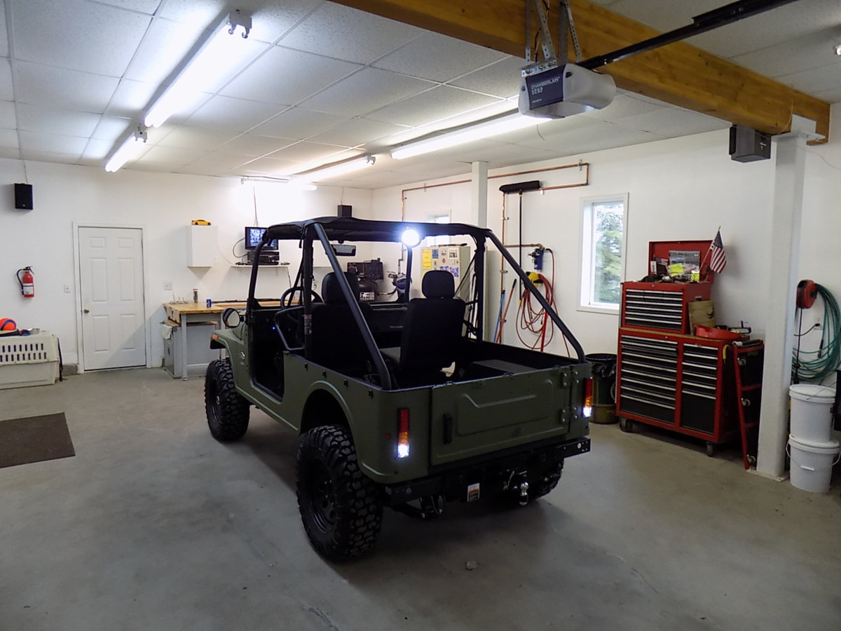

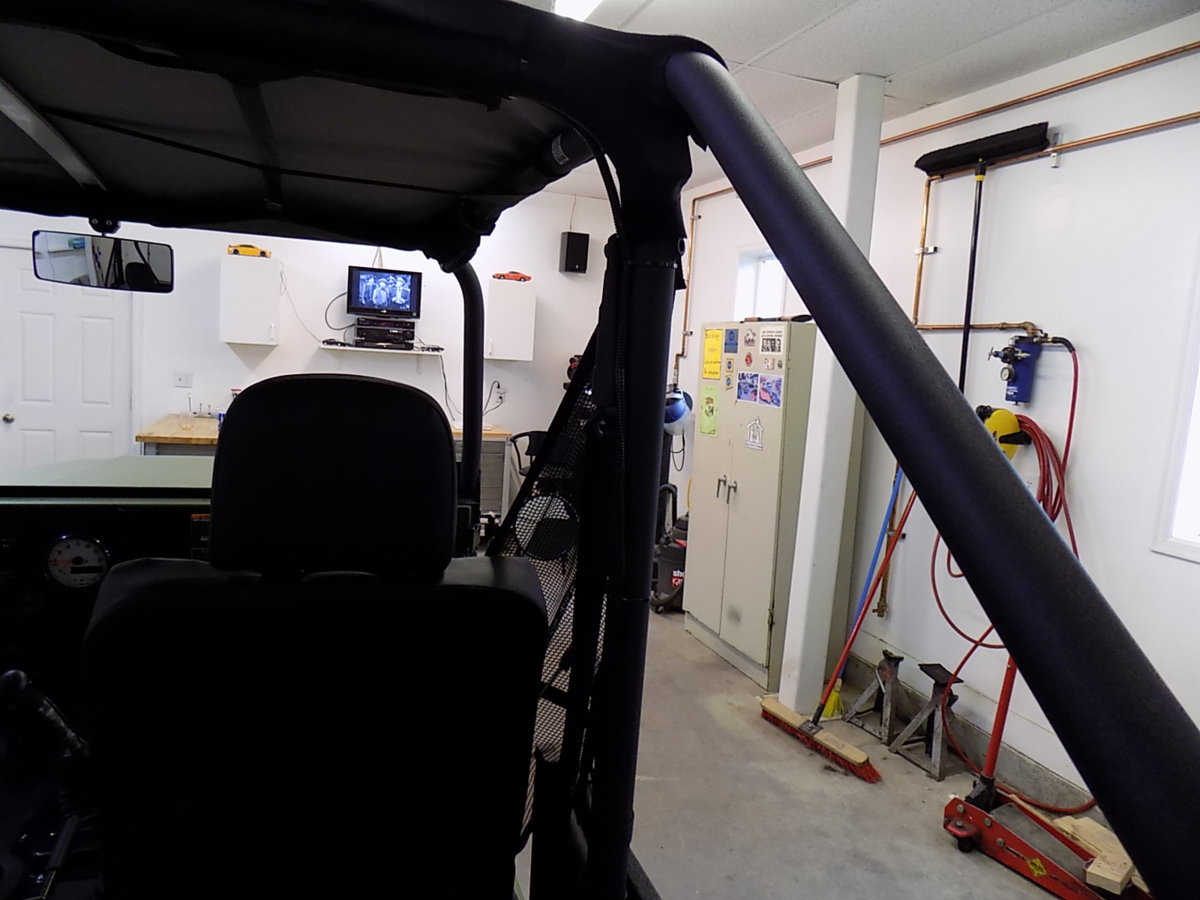

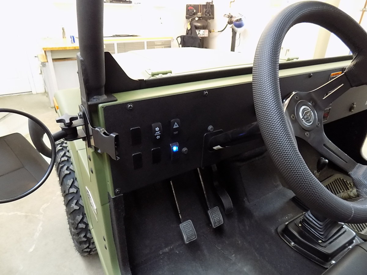

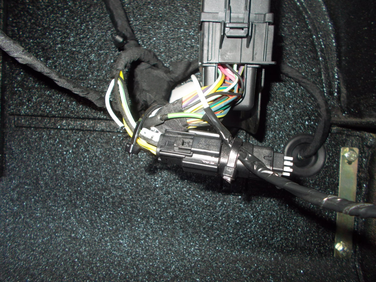

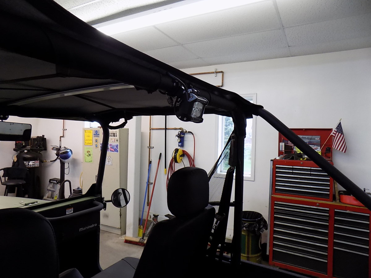

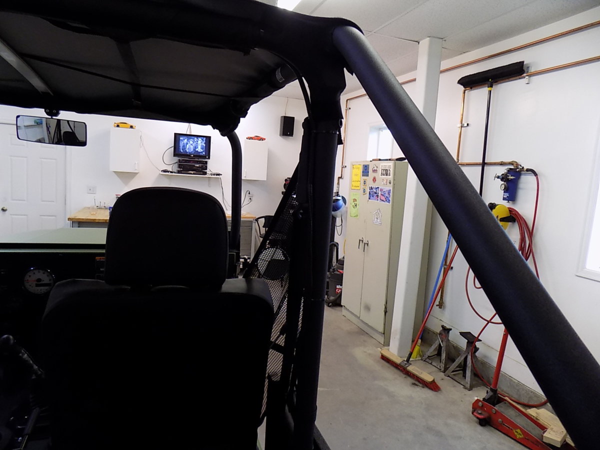

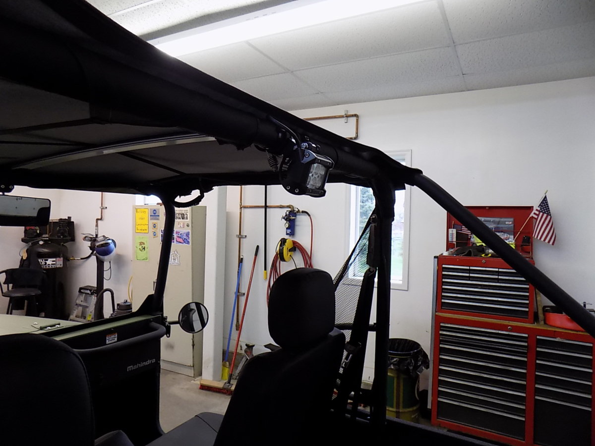

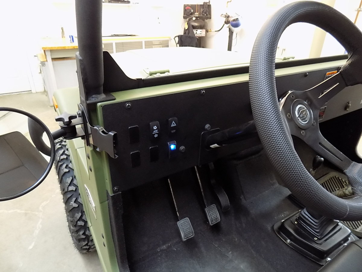

Mounted an LED single box light on the ROPS bar. Used a rubber isolator from the side mirrors and secured with a stainless steel heavy duty clamp. The power supply is coming from the OEM relay under the hood. Knocked out the lower right blank on the dash and used the factory harness to power the control side of the relay. Routed the wiring from the light following the same route the manufacturer recommends for the forward facing light bar. Just turned the backup lights on for the pic. Should work well at night.

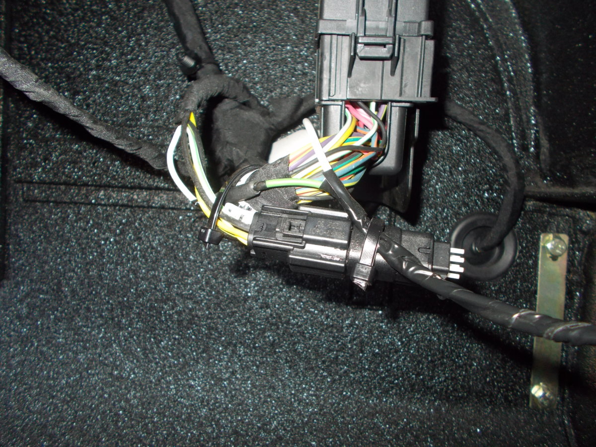

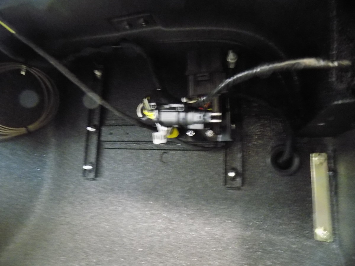

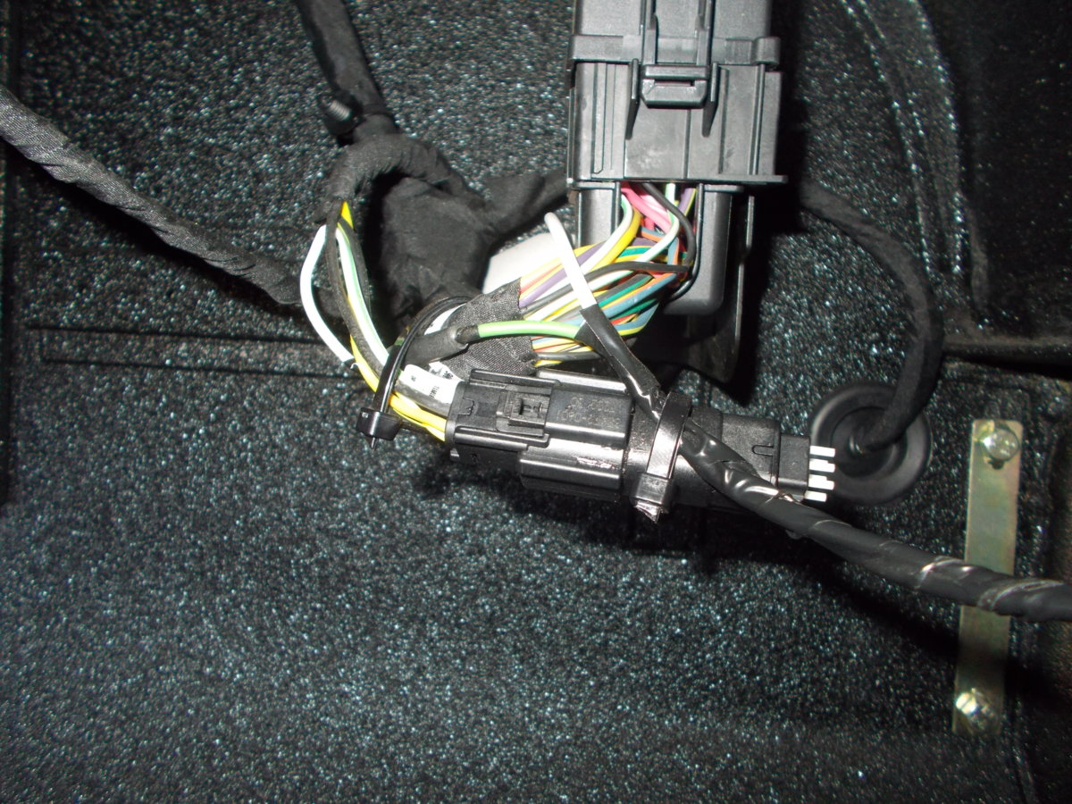

The last photo is a bit blurry. What is it showing?

That's the passenger side corner of the dash where power was tapped from the OEM relay for the light bar. There is a six wire plug over there with a weather cap on it. There is a white wire that gets hot when the relay is energized. Used this wire to supply power to the high center back up light. Just attached the ground using an eyelet and a screw that was there.

Thanks, every bit of wiring information is valuable in the absence of a wiring diagram.

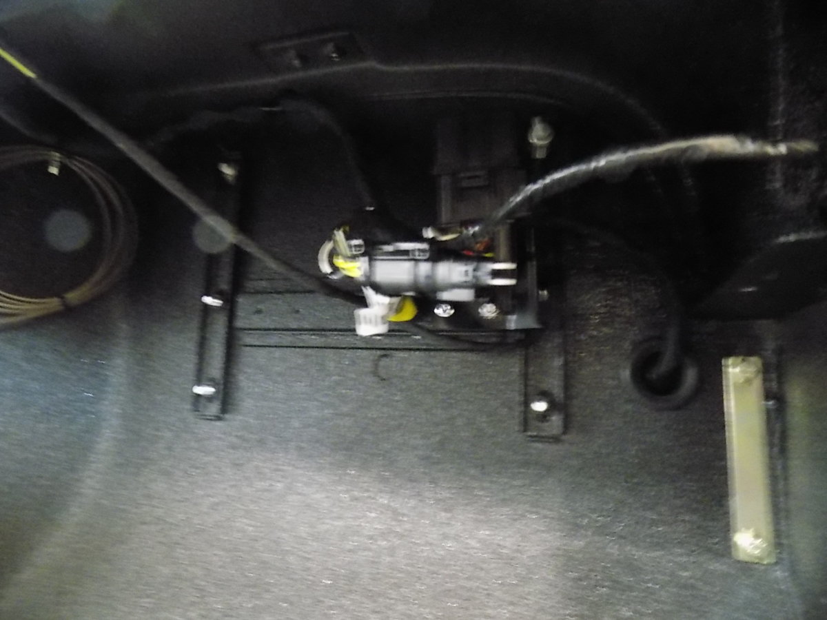

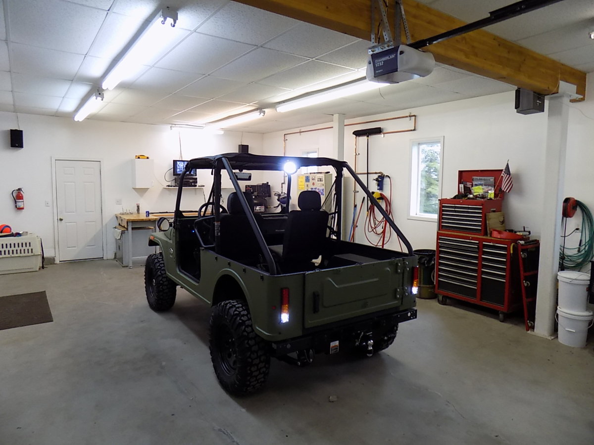

View attachment 3629View attachment 3630View attachment 3631View attachment 3632 View attachment 3633
what tail lights are you using? those look great

would you mind taking a picture of the wire that you tapped into? I looked today and there are a few white with a stripe. I am trying to tap into it for additional power options. thanks!
