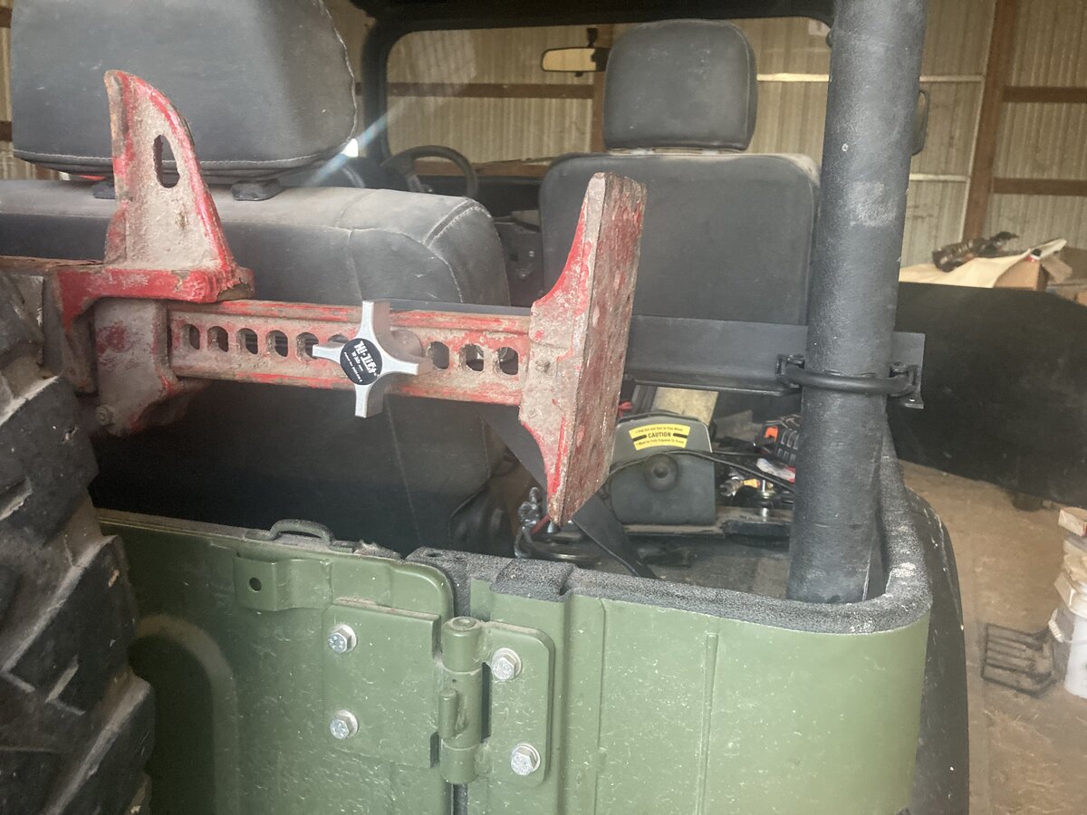

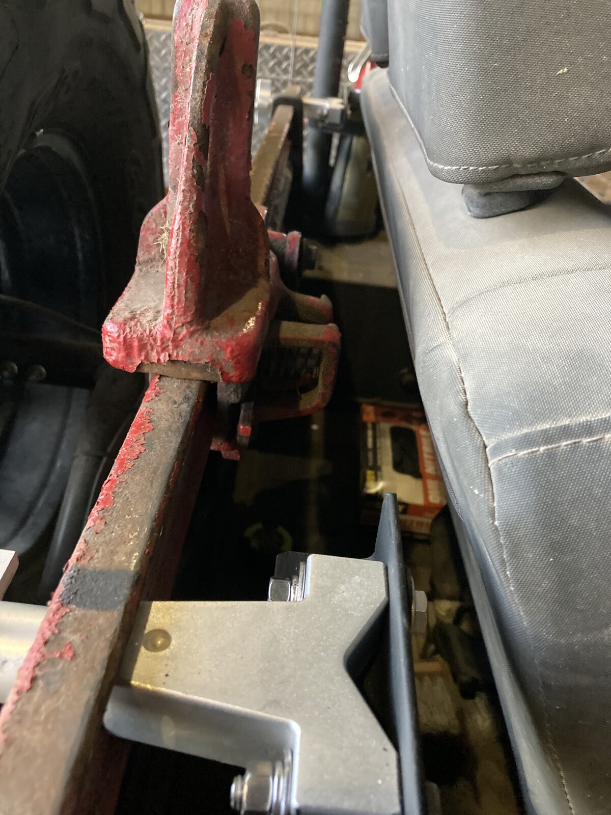

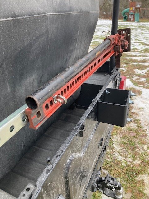

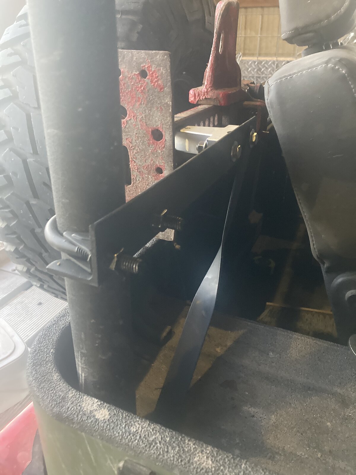

I bought the hi lift roll bar mounts but then discovered that with my roof and the way they attach to the roll bar I couldn’t use them in that fashion. So I used some 1.75” exhaust clamps and some angle iron to make my mounts. I then only used one side of those hi lift roll bar mounts and bolted them to the angle iron. Came out real good and have held up fine so far.

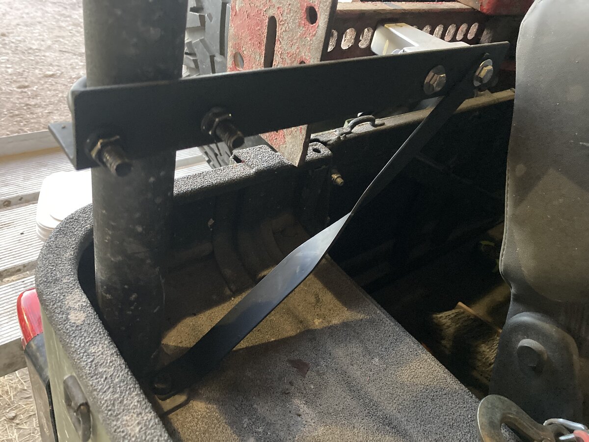

Don’t forget that flat bar I forgot to mention. Put it in a vice and put the twist in it as well as the bend to bolt it to the roll bar mount. Without that there was too much leverage and weight on that mount making it want to droop. no welding needed with this setup. Very simple and works well.

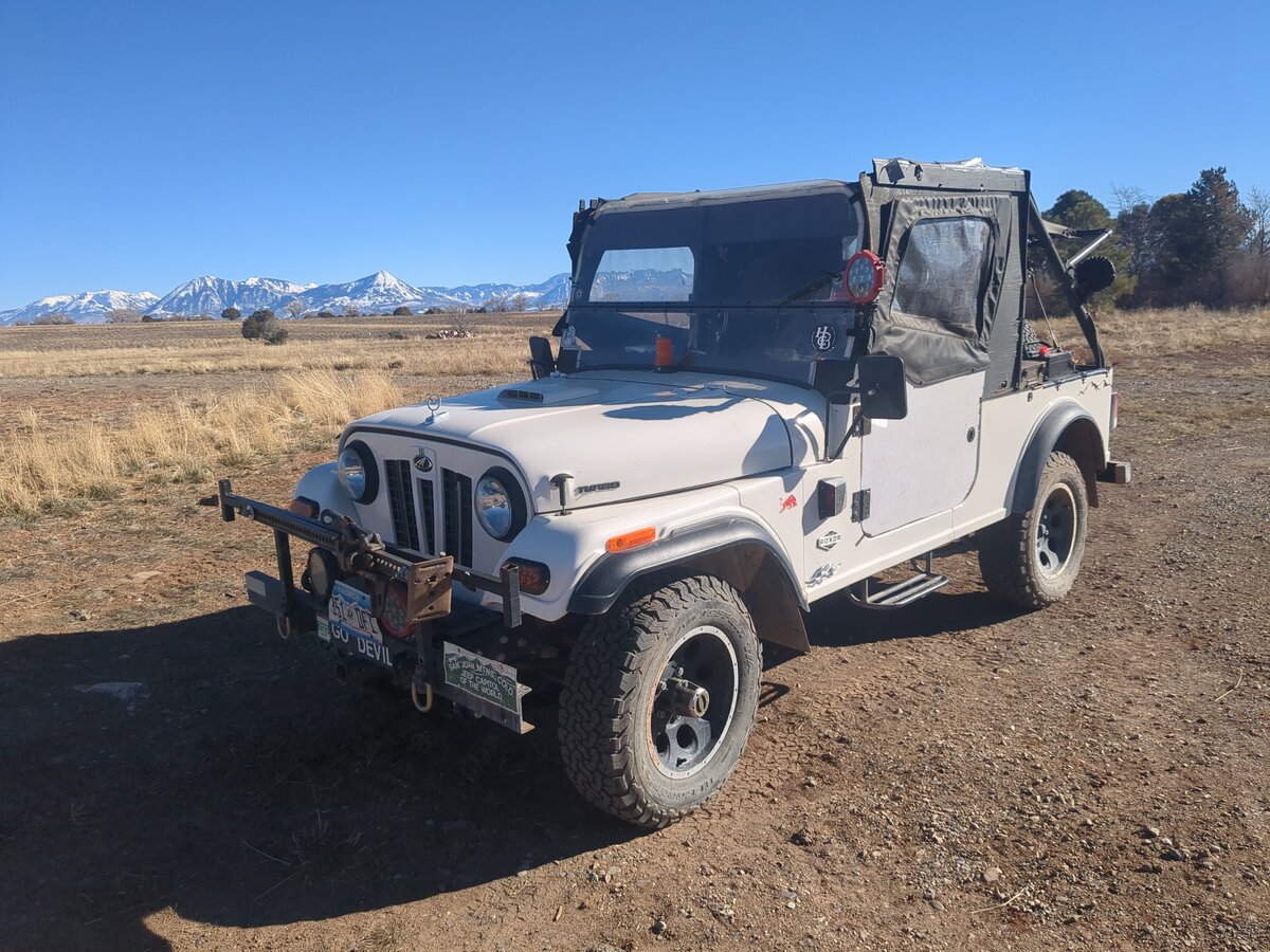

Mine is mounted on font brush guard above the bumper. This out of the dust & dirt so it will work when you want it too. Rc

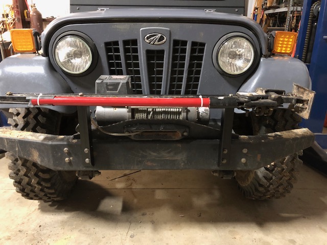

Nothing fancy, but only takes a couple feet of angle iron to make and helps protect the grill and winch while staying out of the way and easy to access. No need to buy mounts.

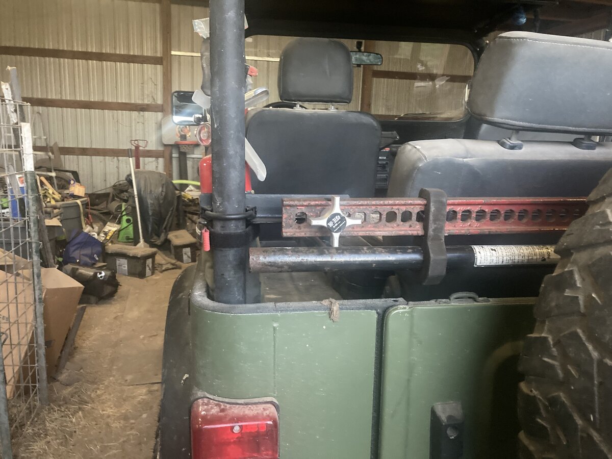

You can get by without mounts by just using a bolt instead. I opted for the mounts since I already had them. I like the big twist knobs that make it easy to remove without tools. I’m sure you can buy or make something similar if you do bolts instead of the mounts

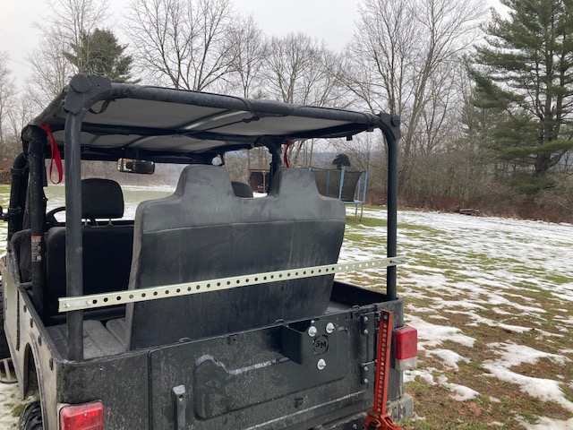

A neighbor of mine is an electrician and has a piece of kindorf about 6 ft long. Kindorf is some slotted steel that electricians use to attach conduit etc. Pretty strong stuff. I'm going to measure across rear ROPS and use U-Bolts to fasten and see if this works. I can then just mount the jack to the kindorf with eye bolts that lcp mentioned. I like that idea of using a screwdriver to tighten bolts. Hopefully this works. If so I'll post pictures. Thanks everyone and "Happy New Year"

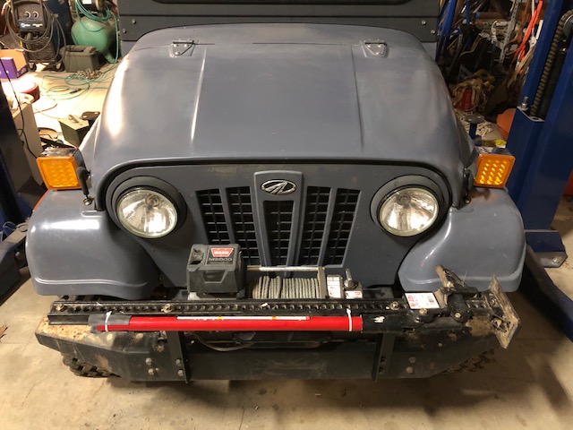

1 inch tubing welded on top of 4 inch channel bumper. Servers as a brush guard, 2 bolts to hold jack on. Keeps jack clean and easy to use. rc

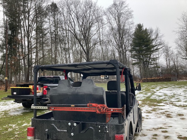

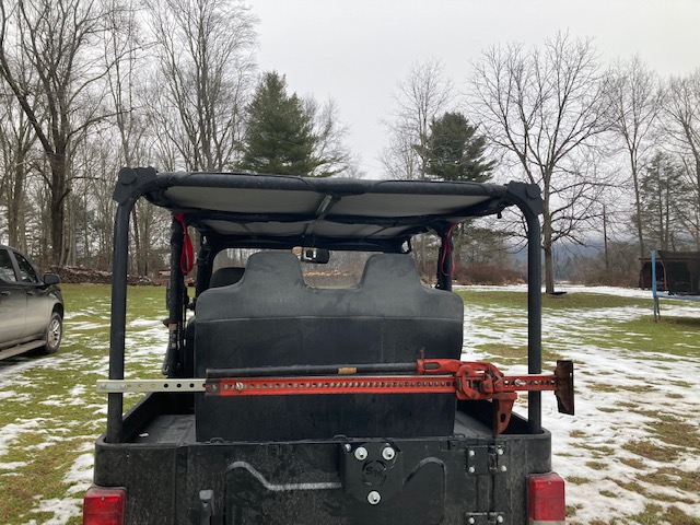

Here you go my fellow Roxians!...For all of you with the 4 person ROPS I was able to attach a piece of Kindorf across the rear tubes with U-bolts. I then fastened the Hi-Lift Jack to the kindorf with eye bolts that lcp suggested. I could also use spacers in between the kindorf and jack to move more to center but I feel this is unnecessary right now. All I need now is a spare tire! See pictures.
