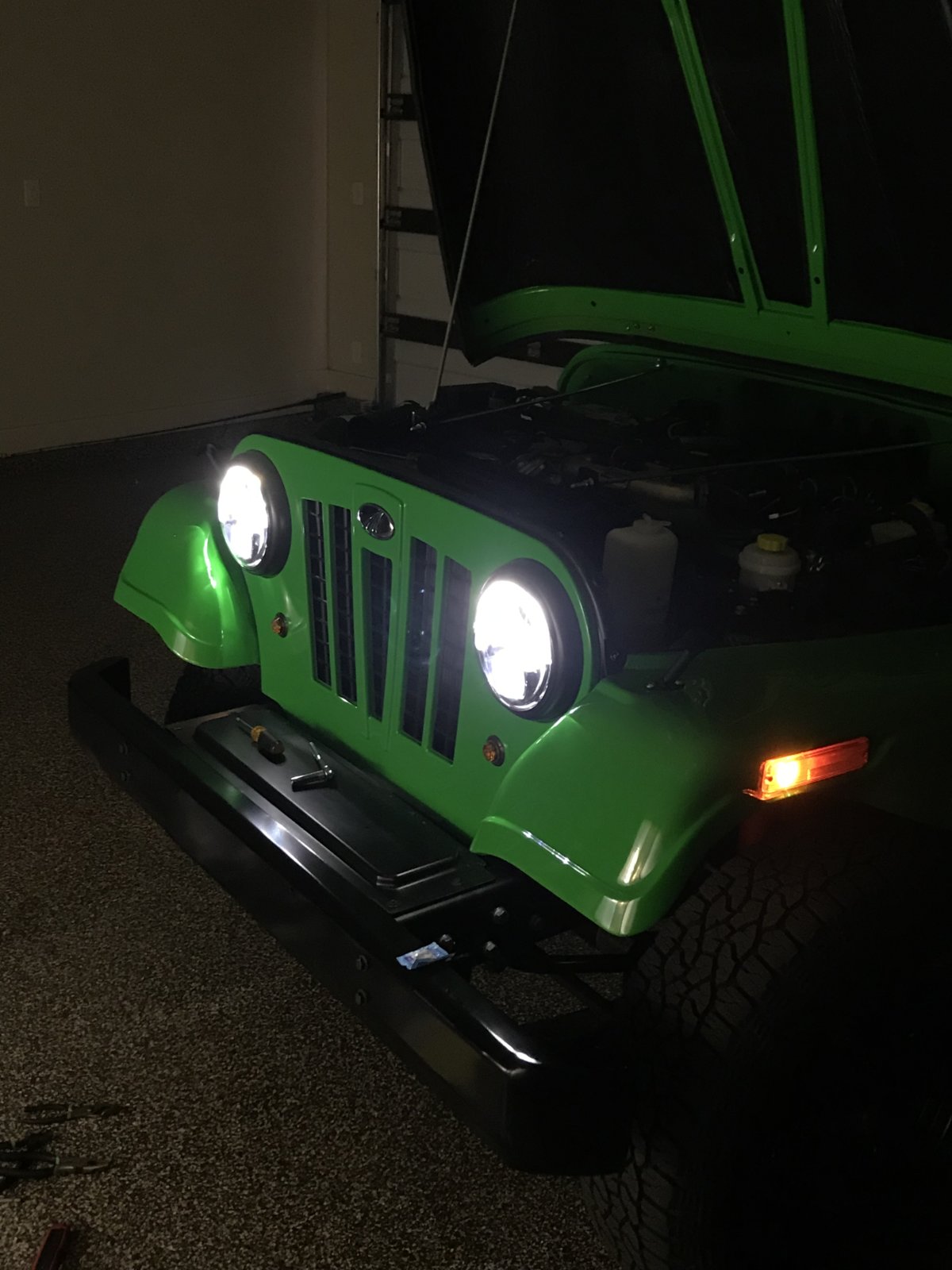

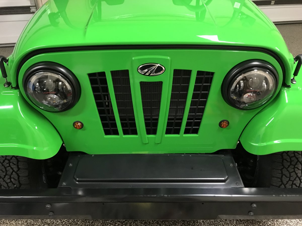

I did the JW Speaker J2 8700 LED Headlights, plug and play no flicker issues. 3200 Lumens Raw output.
