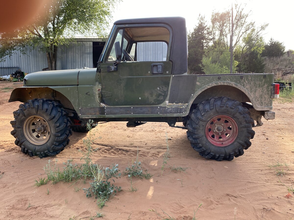

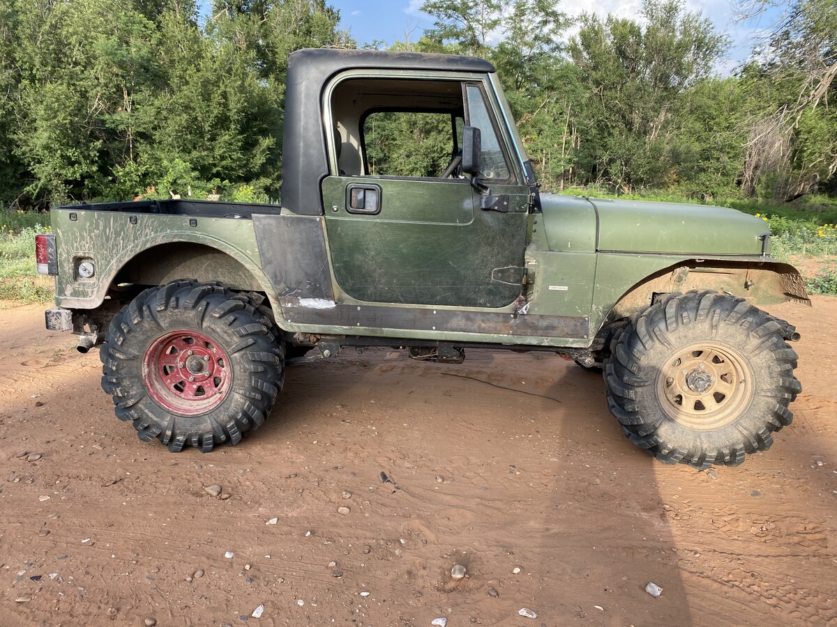

How’s this for a hard cab and full doors with roll up windows, and a sliding back glass..... I cut the door frames off a cj7, used a set of yj doors, a scrambler half cab, a cj7 windshield, cut the seat bases down flush with the bed so you were sitting at proper height for the shorter windshield, and dropped the nose cone out of the transfer case and removed the interlock pill so I could twin stick my transfer case and have 2 high and 2 low, then I cut my front fenders so I could clear 35’s and keep a low center of gravity.

By far the best looking cab I’ve seen yet.
If that was available option I’d really consider getting one.
Im sure Mahindra is jealous.

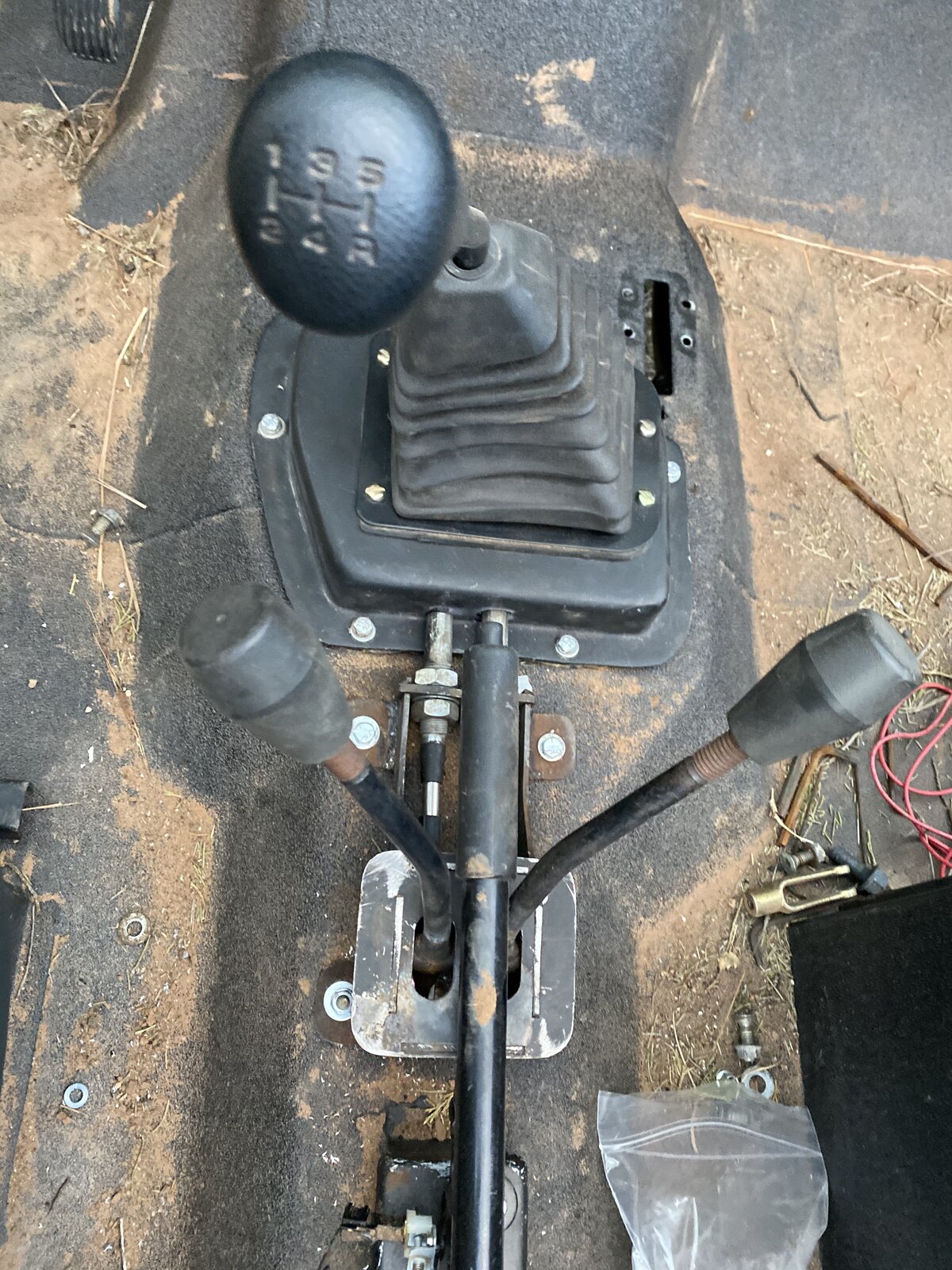

Could you explain in more detail what you did and parts used to get to a twin stick setup?
I like the doors.
I pulled all the old linkages off and used a twin stick cable setup that I had traded for that was on an old Jeep, I built a bracket that bolted in the side of the transfer case that allowed me to adapt the twin stick setup to my Roxor. Even if you twin stick your shifters you can’t shift the levers into place separately unless you pull the front of the transfer case and remove the interlock pin, it’s not difficult, but it’s fairly entailed.
