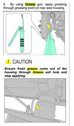

You’ll never see the grease come out of the axle bearings on the rear axle. If it comes out it’ll be inside the tube and/or behind the drum. I’d say 5-10 pumps on initial greasing in case they were on the dry side from factory then 4-5 every oil change or after being submerged in water.
Yes it does come out on the rear axle there is a hole on top of the axle.
Also for a clunking int he front you can't find check your sway bar. rock it aggressively by hand and if it clunks, it's probably the sway bar. have a friend watch.
1,305
I stand corrected. Thank you for the clarification
