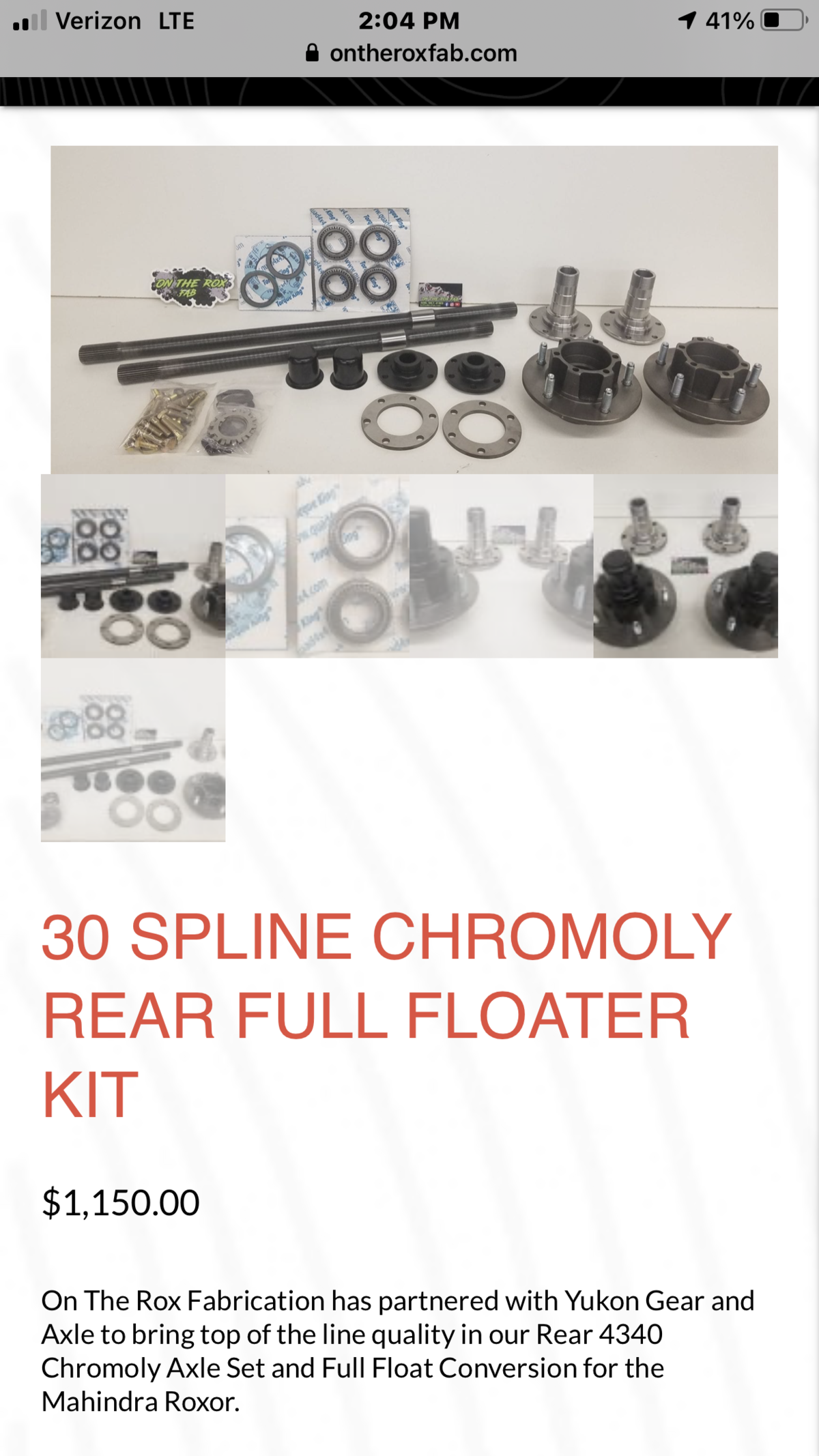

I have a 1964 CJ5 with a Dana 44 rear axle. (Same as the Roxor, although the Roxor axle isn’t actually made by Dana, it is a clone and Dana 44 parts will bolt right in.) I found a guy who sells a “free-floating” kit for the Jeep. It allowed me to put locking hubs on my REAR axle. With this setup, I can just disengage the hubs and tow it at any speed, for any distance, and the rear wheels just spin like it was a trailer axle. No movement of the diff gears or drive shafts. There’s a free-float kit available for the Roxor, but you’ll have to change some more internal parts to accommodate the change in spline count.
I’m planning to do this and add a Tru-trac locker. Eventually. Here’s the link for the Roxor kit.

Flat towing with a front or rear lunchbox locker would essentially be the same as flat towing with a front or rear open differential, you will be speed limited. On the front if you have unlocking hubs just unlock them as Bister stated and your front axles and driveshaft will not be rotating, but you will still be speed limited by the rear axle. Like Uncle Chuck stated the rear axle free float kit can eliminate the speed restrictions, but I would not do it, as I have seen too many free floated rear hubs on CJs disintegrate on the trail. I just don't think the hubs are strong enough to take the torque applied to the rear wheels. Understand the CJs were not running Dana 44s, and I have found the Dana 44s, even with Lock Rite lunchbox lockers installed to be near bullet proof, I think the locking/unlocking hubs to be the weakest link.

As per Hummingbird Ranch, I am inclined to agree about the locking hubs being the weakest link. I haven't had any issues (yet), but I carry one of the original hubs (non-locking) that came with the free-float kit just in case.
