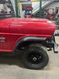

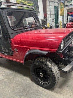

I saw this on a Facebook post. Looks like they just trimmed the flare a little to fit. If the person that owns this Rox is on here, thanks for posting this pic of your awesome ride. .

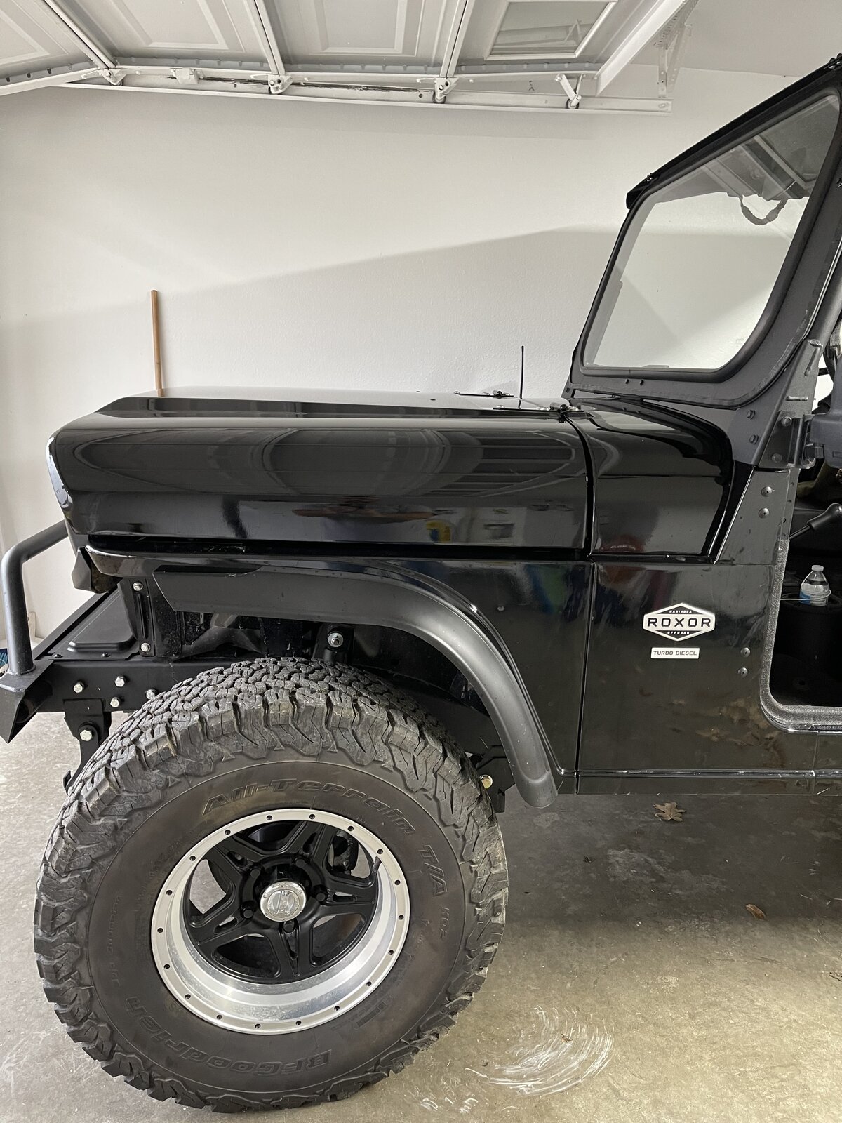

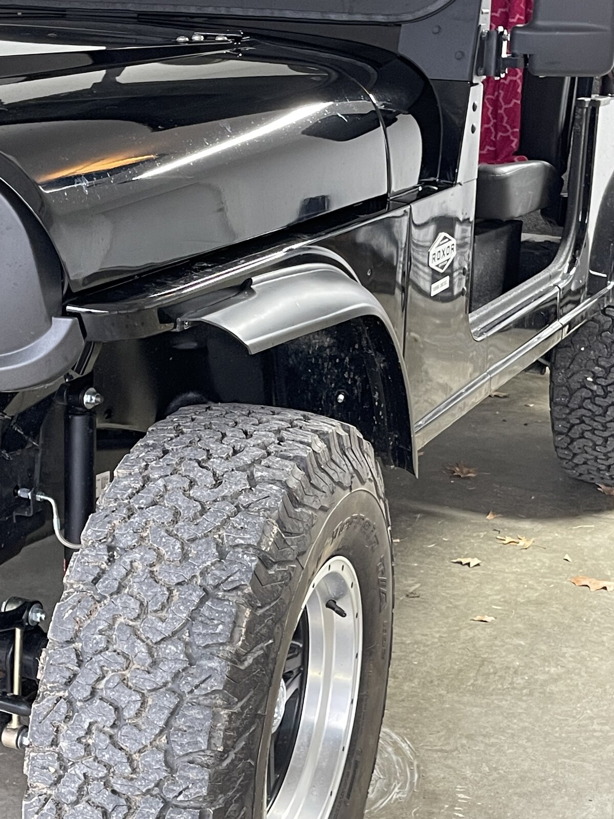

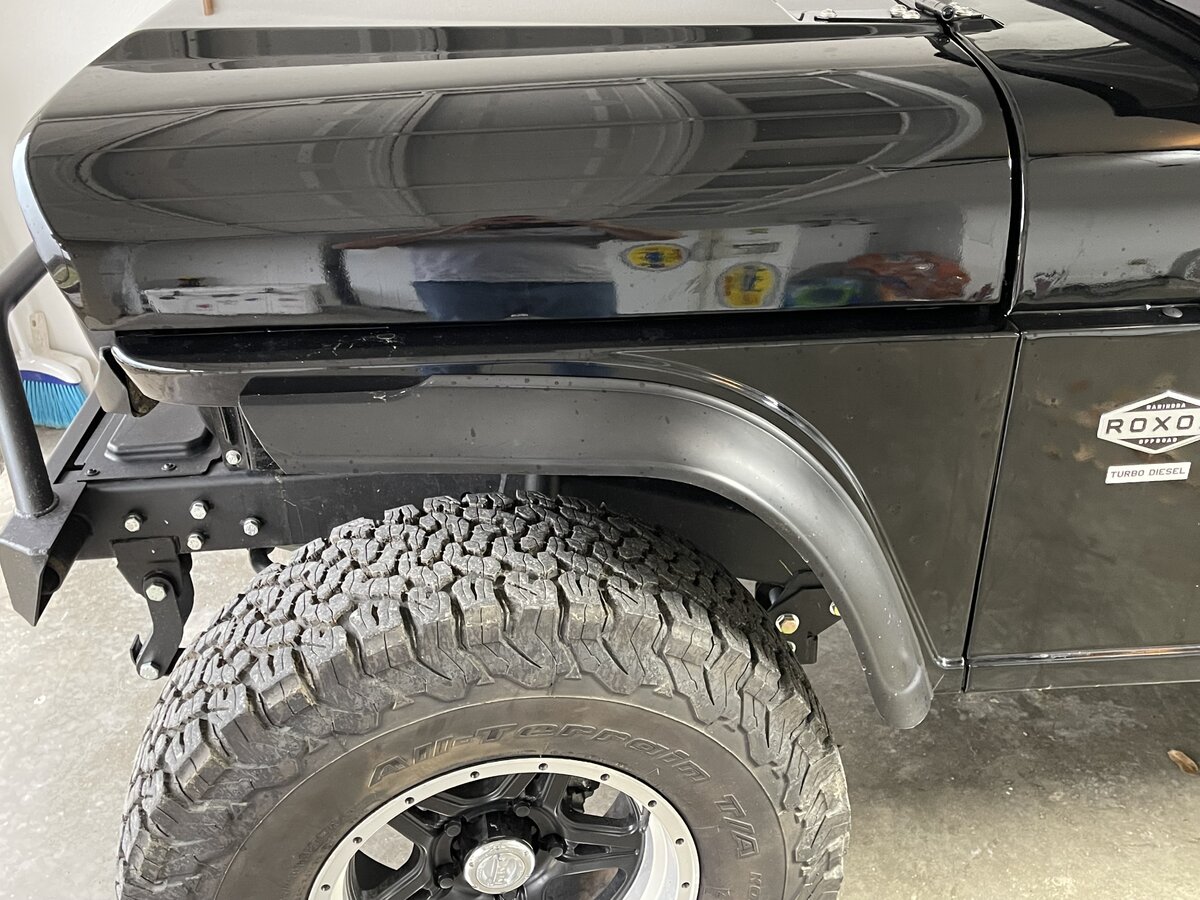

Hello all. Just thought I'd send this as a FYI for all the inquiries I've read. I got my flares from Diesel Freaks. The rear flares are pretty much a cake walk to install. You have to compress the ends a bit to get them in the wells, but they fit nice. I mimmicked DDP70's install on the front and admit that it was a slight challenge. They are not as forgiving as the rears. I drilled the holes and put a thin bead od RTV on the back side of the flares and I coated the threads of the mounting hardware with RTV before I drove them in. Wasn't too bad of a process once I got the fender ligned up.

If I didn't kow better I would have thought you bought them like that. Looks great!
