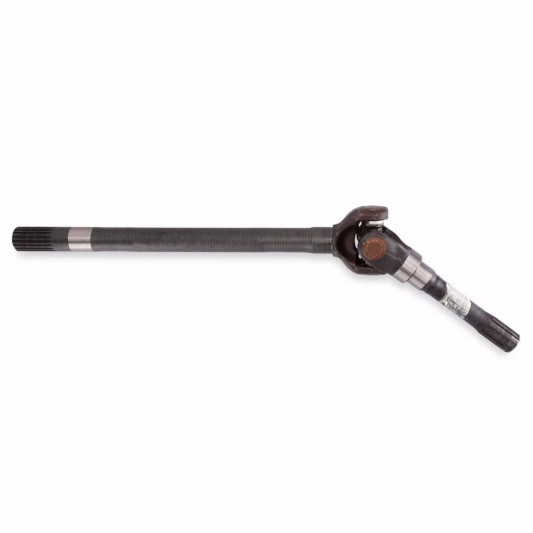

You have to keep in mind that these are somewhat based on the older Dana 27 design. Also the locking hub listed for the old CJ also works on the Roxor which means it probably has 10 spline outers (Unless warn came up with a totally brand new hub for them, I've emailed Warn and still awaiting reply back on this), which is also a Dana 27 design. And if the axle shaft itself is the same idea, then it has 10 spline inners aswell. I've seen people say they are 31 spline and 19 spline, but at the same time when mentioned, didn't sound too confident. I also crossed the locking hub listing over to AVM hubs who make a set for the older Mahindra solid axle models and it also says 10 spline outers. But once again, this is all speculation with what I've found. Doesn't mean it can't have 19 spline inners and 10 spline outers etc etc Really what we need is for someone to get a hold of the shop manual or just to pop the drive flange off and count splines. But then again, I just found a picture of a Bolero shaft here and you can clearly tell the difference in splines if the photo is accurate. It looks like 19 inner and 10 outer in this picture.

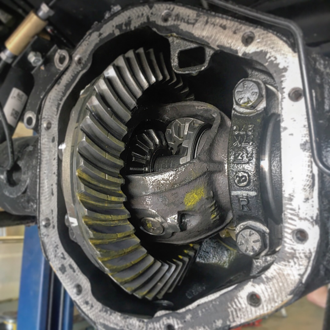

I just checked the Roxor accessories listings and they now have available, a Lunch Box Locker. Anyone got a clue how these work? It states that the are a snap to install then recommends professional installation.
838
On most semi-float rears, with ends not compression fit with bearing, these are a breeze to install. Seriously, like a 10m job on each side. The process equates to removing and replacing the spiders. I haven't pulled an axle shaft on the Roxor yet, so I don't know if they just slide out. If they do, it will be super easy. The process is greatly simplified by the diff case not needing to come out. Therefore, a gear lash does not need to be performed.
These work with springs and blocks to keep the axles spinning together.
838
Sounds like we may have a winner.
They have serious appeal, due to their install process, and are usually one of the first diffs available for any platform. If they require fluid additives, be sure to heed that.

At $300 I can't resist. At Roxors $900 it appears they want a Caribbean vacation with every sale. Good vid.

We also have them for sale, Spartan Lunchbox Locker we can also help with install directions over the phone and with purchase we will email you Roxor Specific Installation Instructions!
I got my spartan locker through on the rox, Steven is a wiz with the gears and installs and was able to help out tremendously. I just got done helping out another member who's mechanic installed his wrong and was having serious problems, had they talked with Steven I think they would have never had a problem. The spartan works great but it's not a 10 min install. It will take the better part of 5 hrs and you better have a good wheel puller, preferably a hydrolic wheel puller to get the hubs off. The axels need to come out and the axels will need a slide hammer to pull them. Other than that it's a pretty easy job.as jrobzz said no lash needs to be set because the ring gear and carrier are reused. Save yourself 200$ and the cost of "pro install" and buy from Wyatt at on the rox. Tell him Sonny sent you;)
And fwiw the 900 is for 2 lockers through mahindra, on the rox sells them for about 350 each I think. Extra cost is worth the expert advice.imho
