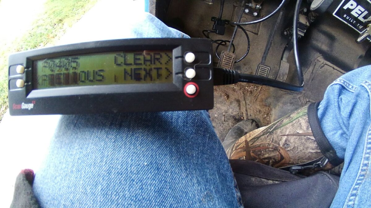

No jury duty for me . Just farm work. I did finally get a legible code off of the scanner and it appeared to be P0405 , On Page 153 of diag. manual. I took the time this morning to check all of the vac lines and tightened all of the other hose clamps , also looked for loose wires and wiggled probably everything under the hood. When I turned the key and started it, the light came back on . After a few more cycles though, the light went off and has stayed off all day thru many starts and stops. I'm hopeful that the problem will stay away. I will likely be returning the scanner though, because the one I was sent has display problems.
Thanks to Txroadkill and Harry for help and encouragement.

Some codes are set then if the problem is fixed it might take a few cycles for it to turn off. Glad you sorta got the problem figured out. If it comes back I’d take the egr off with the help of a tune or remove the valve and use some carb cleaner and clean the valve out as it’s possible the carbon soot has it gunked up enough to stick and then the ECM senses it’s stuck and sets a code. Not sure how the Roxor egr actually works but that’s what I would do.

The manual says : 6.29 P0405 — EGR VALVE SHORT TO GROUND ERROR 6.29.1 EGR MODULATOR EGR modulator controls the EGR valve through vacuum. The EGR modulator is actuated by the EMS ECU.
