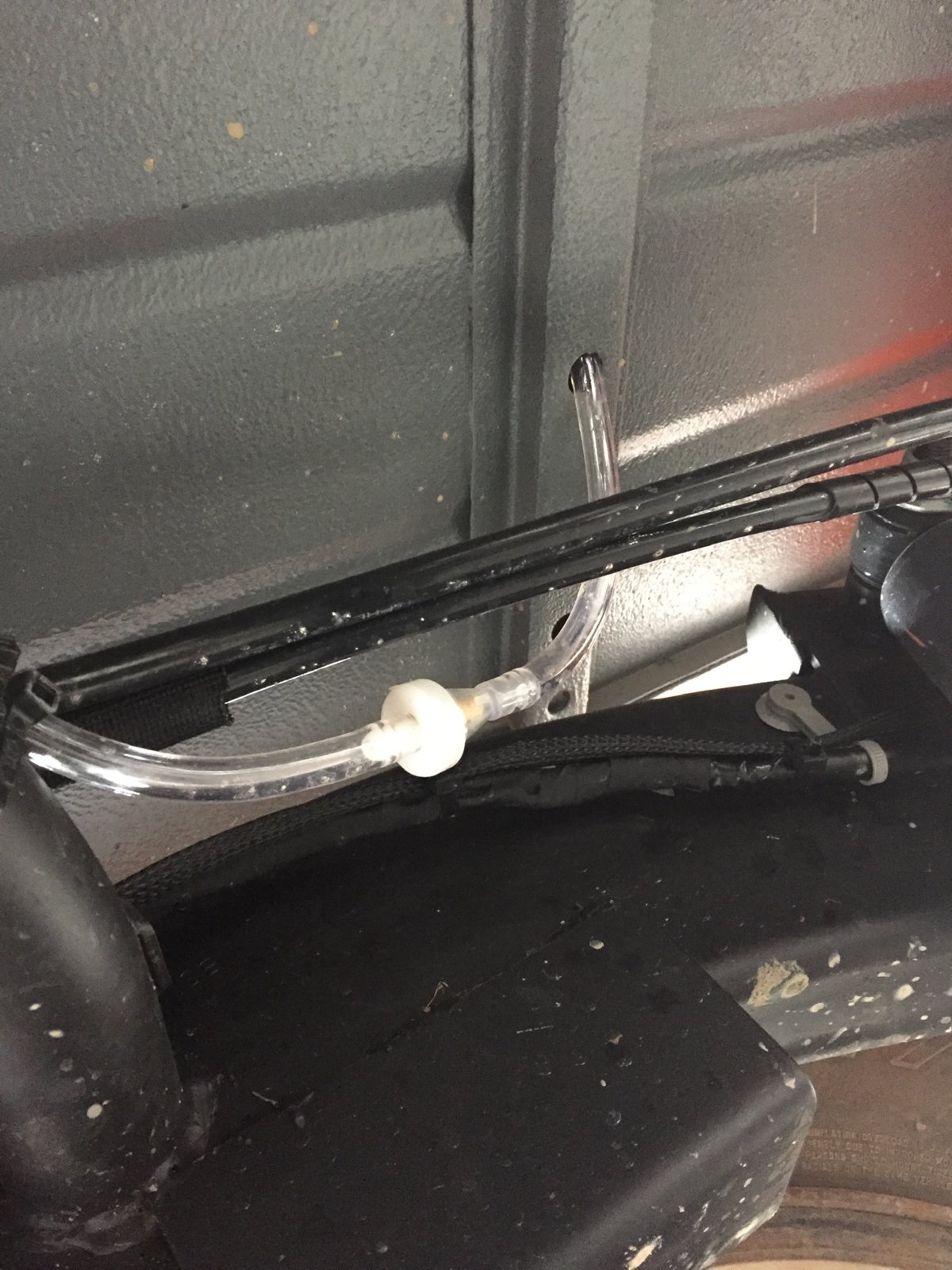

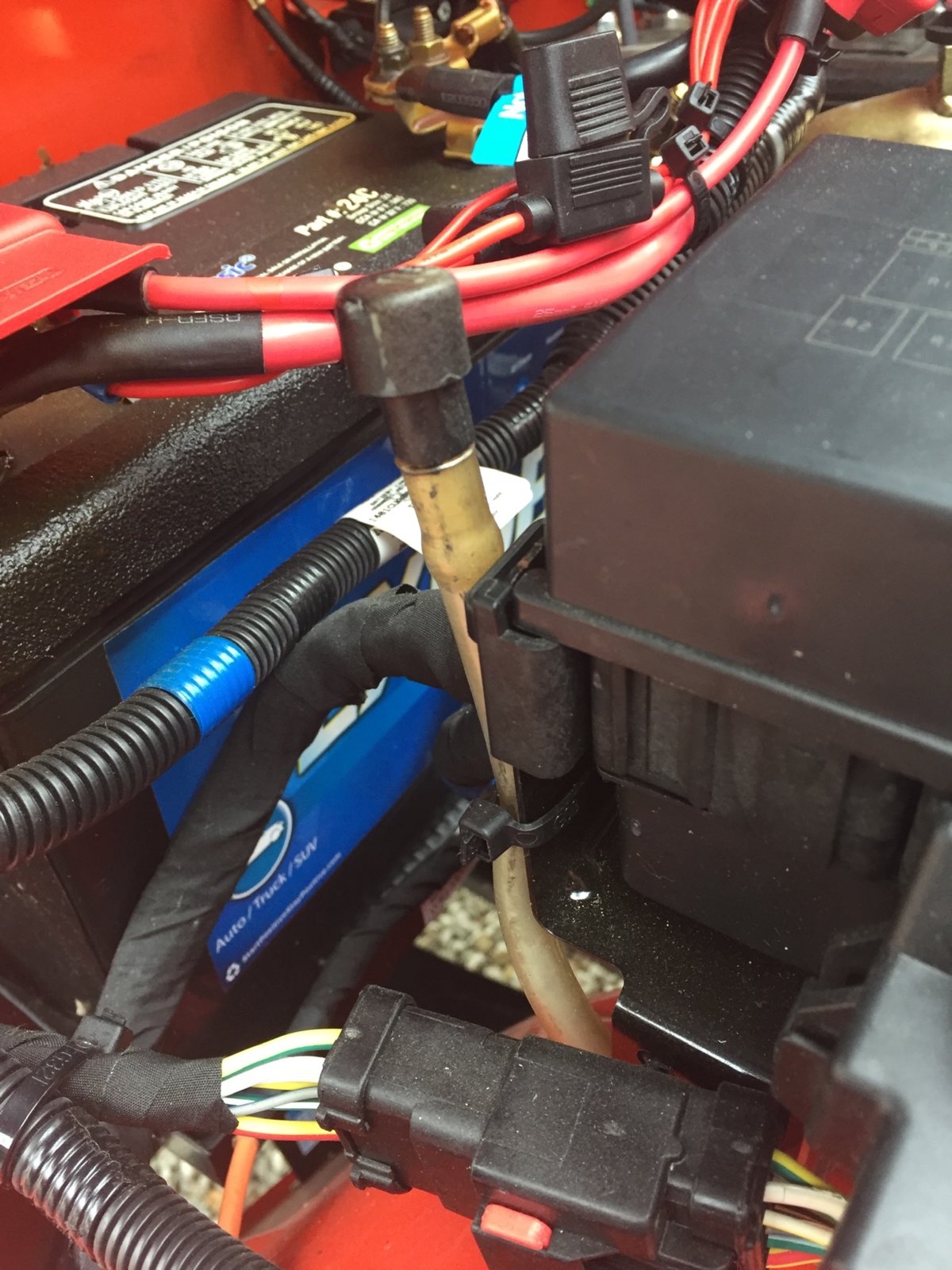

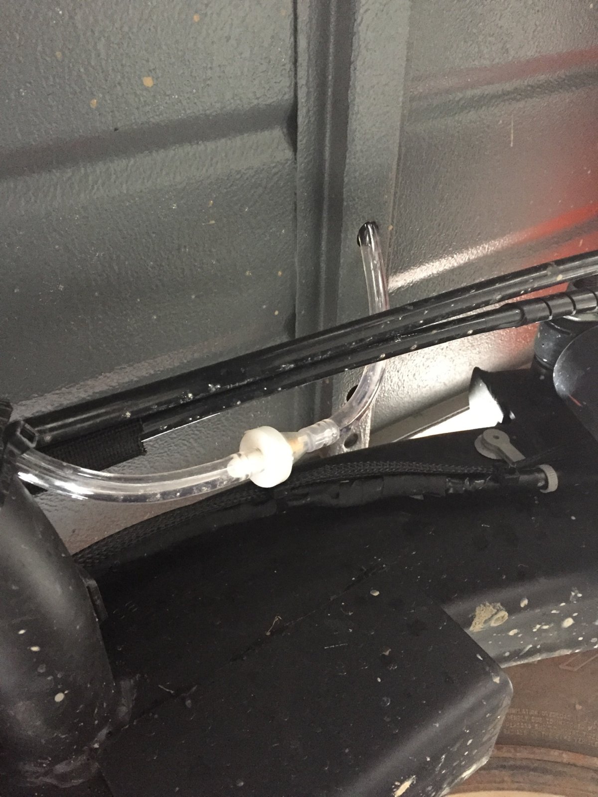

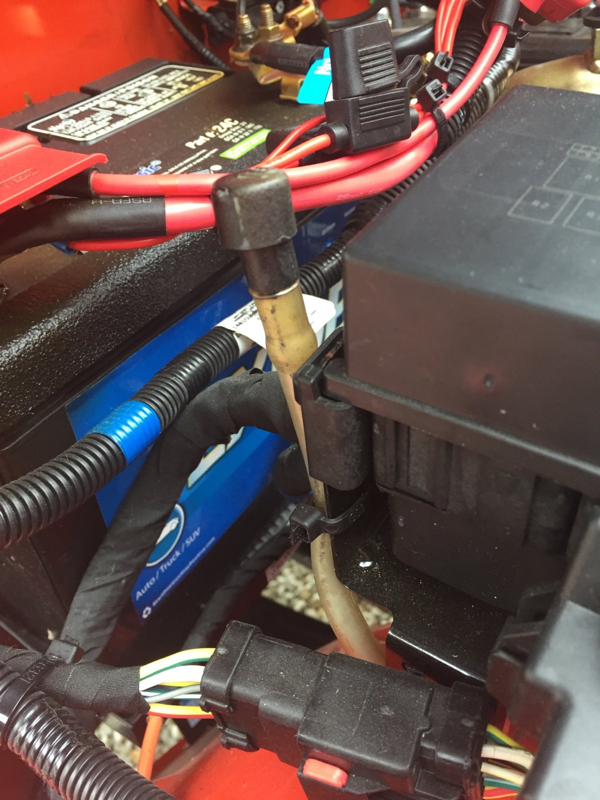

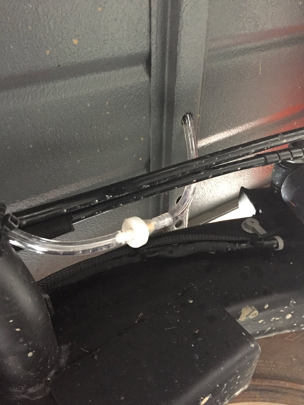

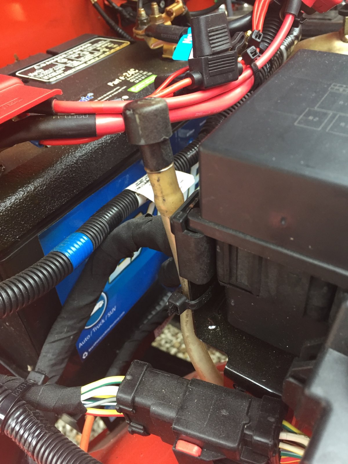

Sorry for the slow response with pics.
WoodLot
Jun 29, 2018
84
N.A. Woods
what type of breather is that for?
The front is the Factory vent cap just moved to the end of my extension hose. It should be mounted vertical.
The Factory rear was just an open hose so I installed a small engine fuel filter into my extension hose since there is a lot of dust in the rear area.
The tranny and TC vents are Factory and component mounted, no elevation. They should be considered if you think you're going to get your trousers wet, in fact you should run all four up to your intake height. I haven't looked at the fuel tank vent but it could be an issue too. Again, I'm talking about continuous deep water submersion swamp buggy style, not just dipping in and out of a hole.
