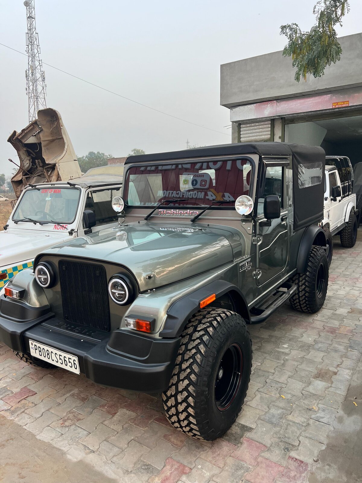

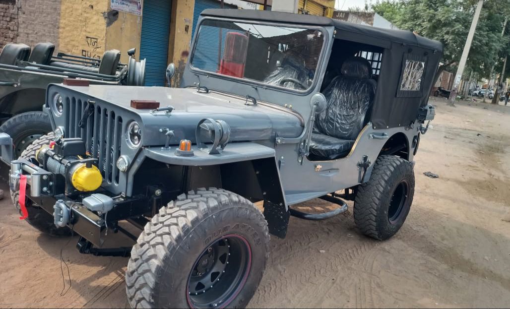

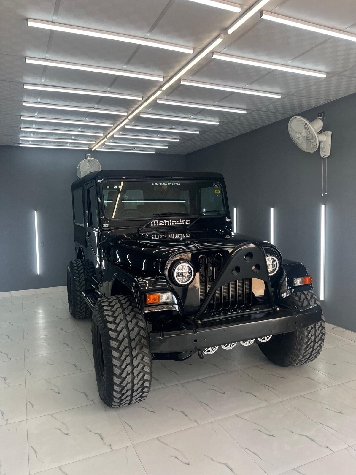

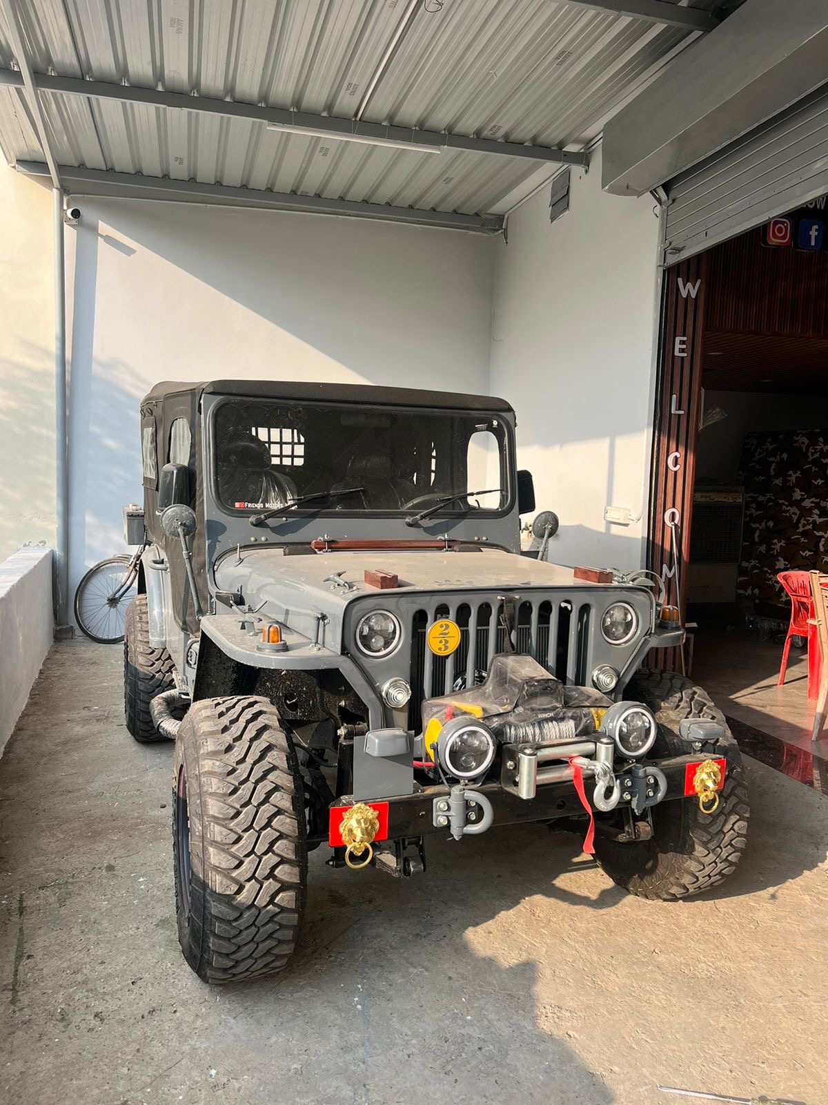

Hey everyone,
Hypothetically speaking if I were to import the Mahindra Willy and Thar body into the states, how complex does one reasonably believe it would be to swap the body of the dreadful 2022 Roxors and up? For reference I'm talking about this body type. FYI they would have to be paint and primed by the customers.
******Thar body is right hand drive, and Willy body is left hand drive******
67466bf300a0b5.61391882.jpg 67466b4e2ee5c6.59595412(1)(1).jpg Resized_67466b217a1f83.38952532_1732668649592.jpeg Resized_67466b1ee6dcb9.31889423_1732668632158.jpeg

That Willys clone is pretty sweet. I have no idea how easily they'd be to swap, but I'm sure it could be done. Obviously, the right-hand drive Thar would be a different story, but everything under the sun has been converted or modified in the past and I'm sure it could be done as well.

The second picture from the Left looks very good.
