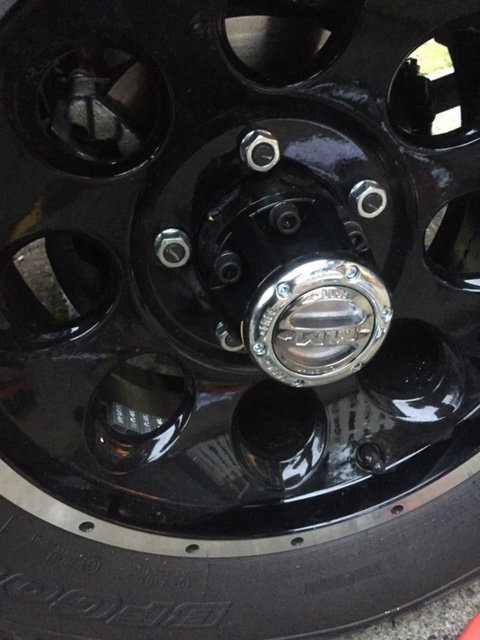

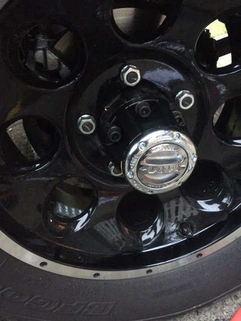

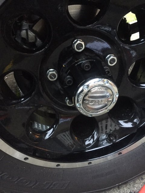

I've been posting several threads about how to modify the Roxor without blowing your kids college fund. I was disappointed with how prohibitively expensive the warn hubs were for the Roxor so I was looking around for alternatives. I found the Mile Marker 481 hubs fit perfectly and I had them delivered for just $93 dollars. If you use these hubs you'll need to buy new bolts with an allen head. They went on in just 30 minutes and I have no concerns about their quality.
BTW, I know some users live in areas where it's a bit harder to find parts. The Allen head bolts you'll need are 3/8-16. These one's will work and you'll need at least 12:

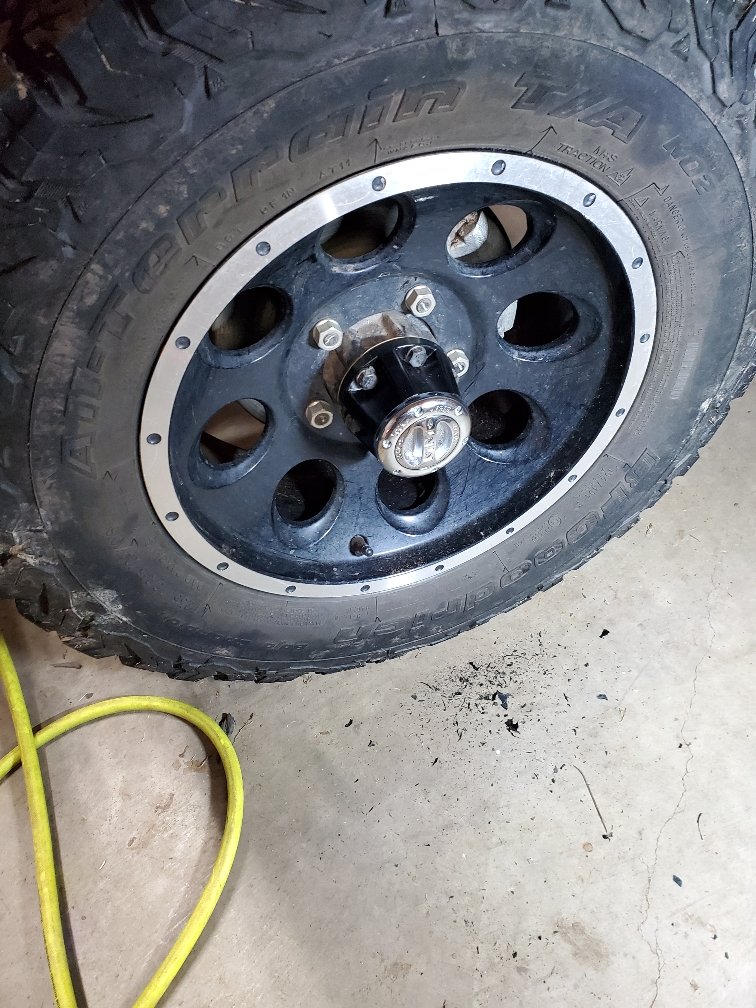

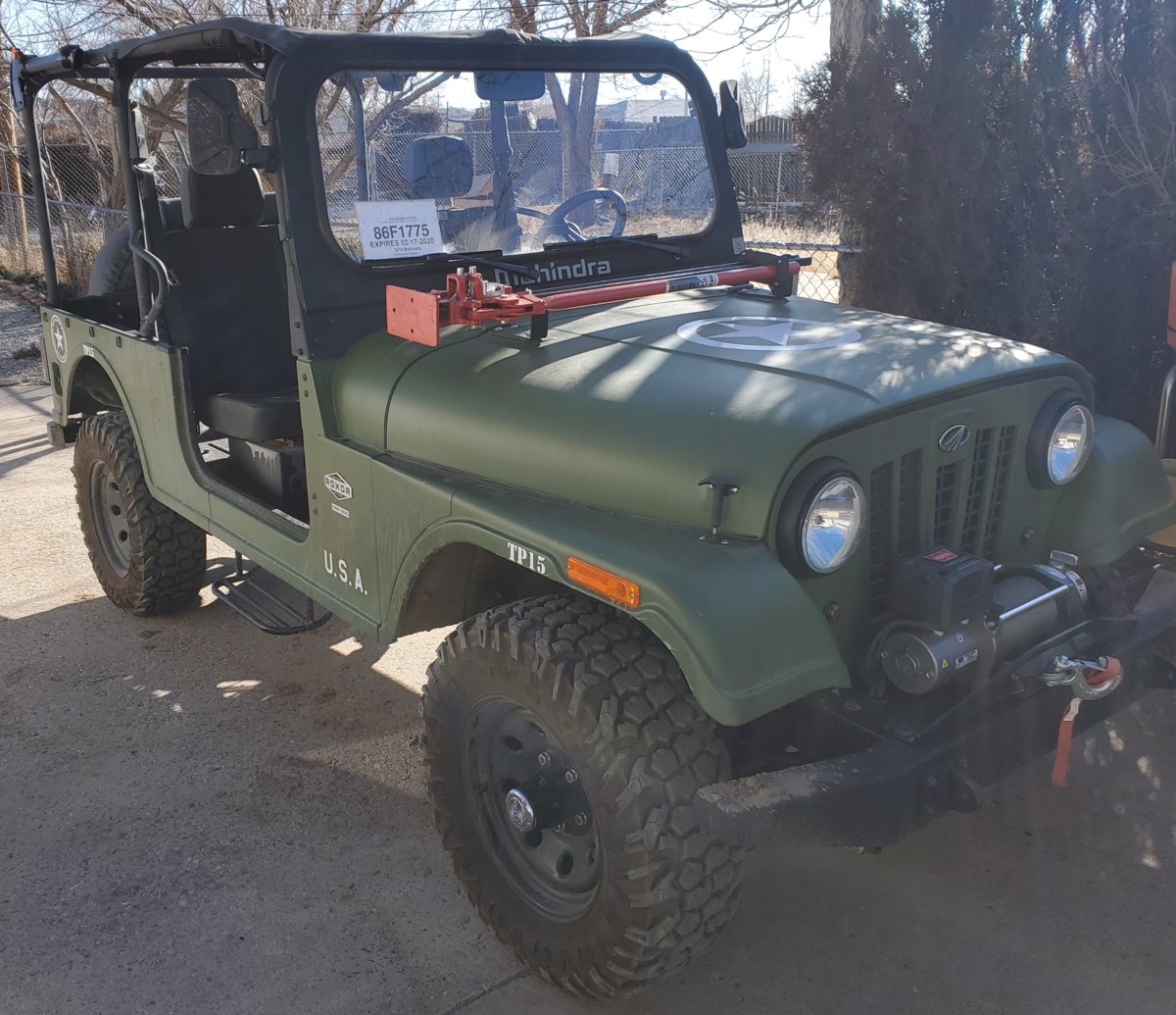

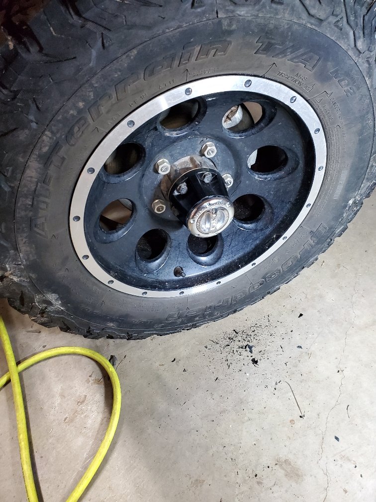

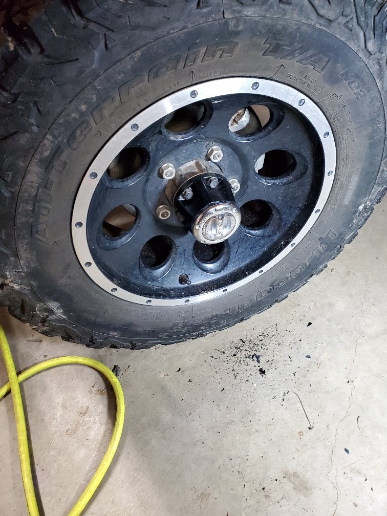

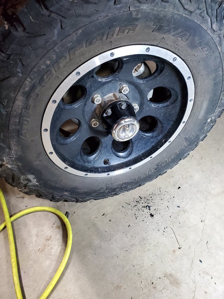

I just finished installing mine. Pretty straight forward and easy install...except for the cap...that was hell. Also mounted a farm jack, an axe and shovel.

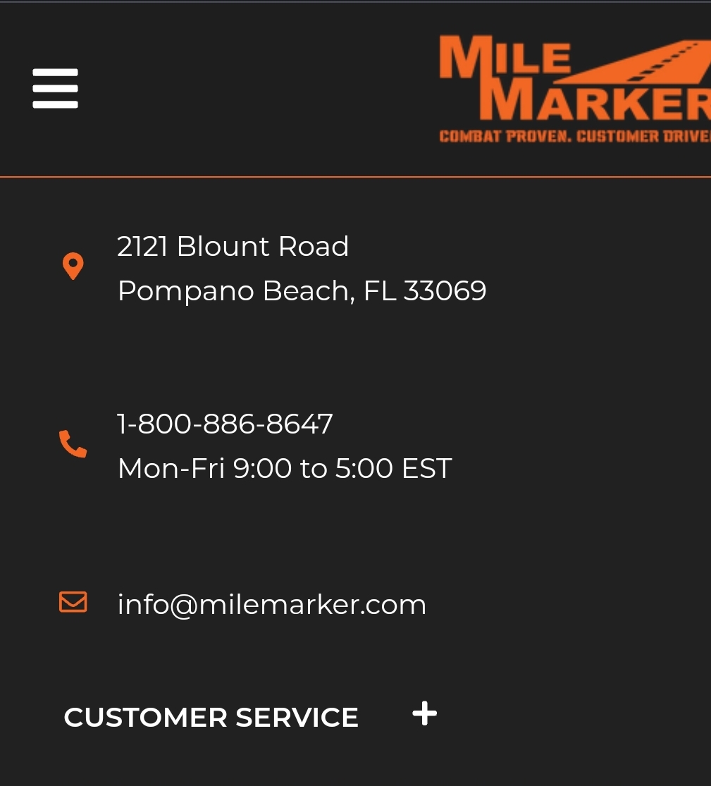

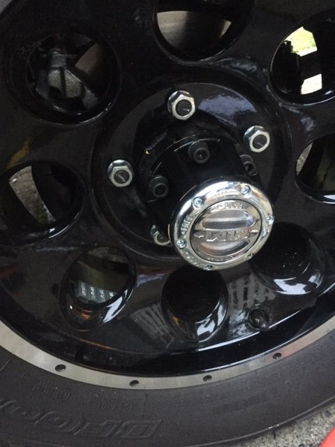

should these work? I only ask because it doesn't mention the spline count; however it says "Mile Marker 481"
