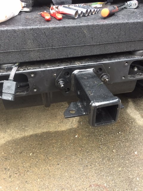

I've started attaching pictures of my Roxor and the modifications I've made without spending a fortune. I found this nice hitch on Amazon for just 24 bucks delivered. Here's a link:
https://www.amazon.com/gp/product/B06Y1CT85P/ref=oh_aui_detailpage_o09_s00?ie=UTF8&psc=1
It's a nice heavy hitch that's made from 7/16 steel plating. I had to drill a couple new holes and I bought some grade 8 bolts to hold it to the frame. I have no concerns about the quality and it's very affordable.
If you'd like to learn about how to attach a 4 pin trailer harness take a look at my thread about how to install Jeep LED tail lights. Good Luck.

The hitch will be plenty strong enough, you won't hurt it; but I might be careful how much weight I would put on the factory bumper just in the middle without any extra reinforcement. Keep an eye on it.
Ya I agree. I think the factory hitch is a bit stronger, but I’m not aiming at towing anything all that heavy. This is a good option for owners who want a good hitch for moderate duty
The factory one has a 19lb, 3/8 backing plate that bolts on with 12 small bolts and 2 large ones in the pintle ball combo, then the bottom 2 of the 4 on the combo just go through the plate. This thing will tow a tank. :)
