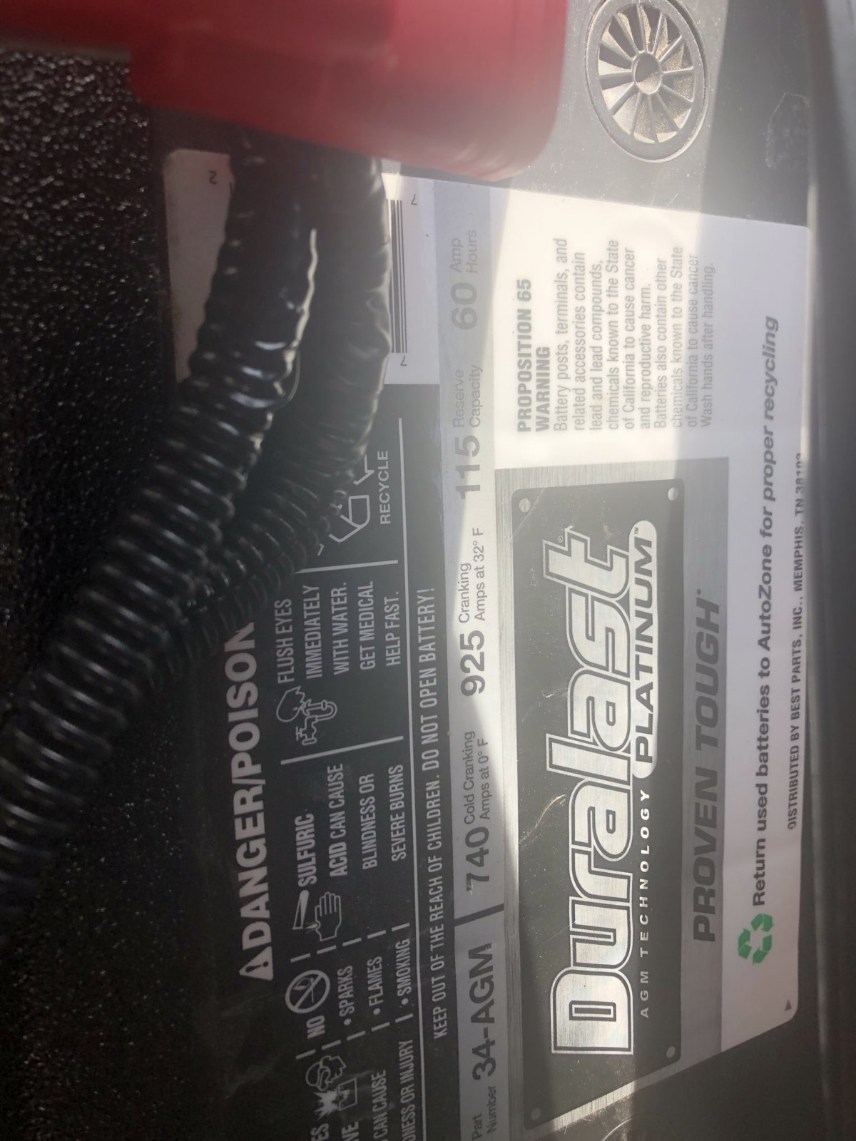

Fried the stock battery, I think the Stereo, heater and winch were to much, got a AGM 900 CCA at 32. No more dim lights when powering the winch.

Here is what I got, fit perfect, it’s a shorter battery. It came with a tray at the bottom to raise it up. To short without it,

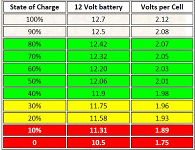

A battery is considered dead at 10.5 volts, that is why they may not take a charge again.
I doubled up on my old Rhino using a battery isolator. For people not familiar with a battery isolator (common in motorhomes) it will charge your main battery first, then charge the secondary and if you run your accessories off the secondary and kill it, your vehicle will always crank. I did this in the Rhino cause the battery is so small. My plow puts a good draw on the system with the heater and lights on on the Roxor.
This isn't what I was taught. 12.8 volt means fully charged. 12.4 means half charged, and under 12 volts means it's dead. From there you need to charged it and see what the voltage is after it's charged up. Hopefully it'll stay at 12.8 volts. Then you should load test it by disconnecting the computer and cranking the engine. The battery should be able to run the starter for at least 30 seconds. That's how I've always done it.
Yep, your numbers are right. Every chart has numbers close to those, but when I said 10.5 is dead, I meant it is completely dead. This is hard to read with the logo over it, but the first one is “state of charge”.
