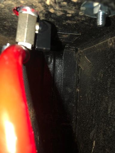

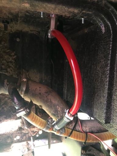

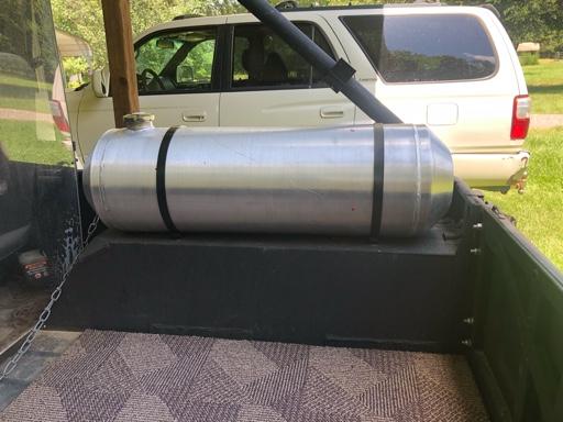

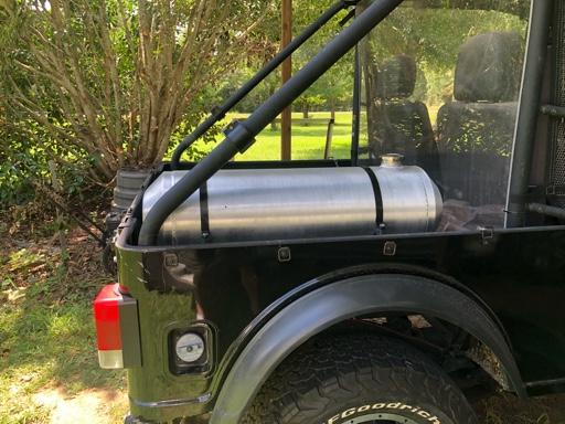

Just added a auxiliary fuel tank have not added fuel yet to test but will test it soon. It’s 11 gallons. Total cost about $210 I installed a on/off valve no pump just gravity fed!

Update. Added fuel so far working great and no leaks! It should keep my main tank on full at all times till the auxiliary tank runs dry of fuel. I will fill it up completely and see if everything works out as planned. The main tank is 12 gallons auxiliary is 11 total of 23 gallons

Awesome set up. That would be a great add on if you going way out. With 35” tires and 4:88s I’m getting 19mpg. How did you splice into the fuel fill?
Look at pictures I put a tee into the vent overflow hose It’s a simple hook up
