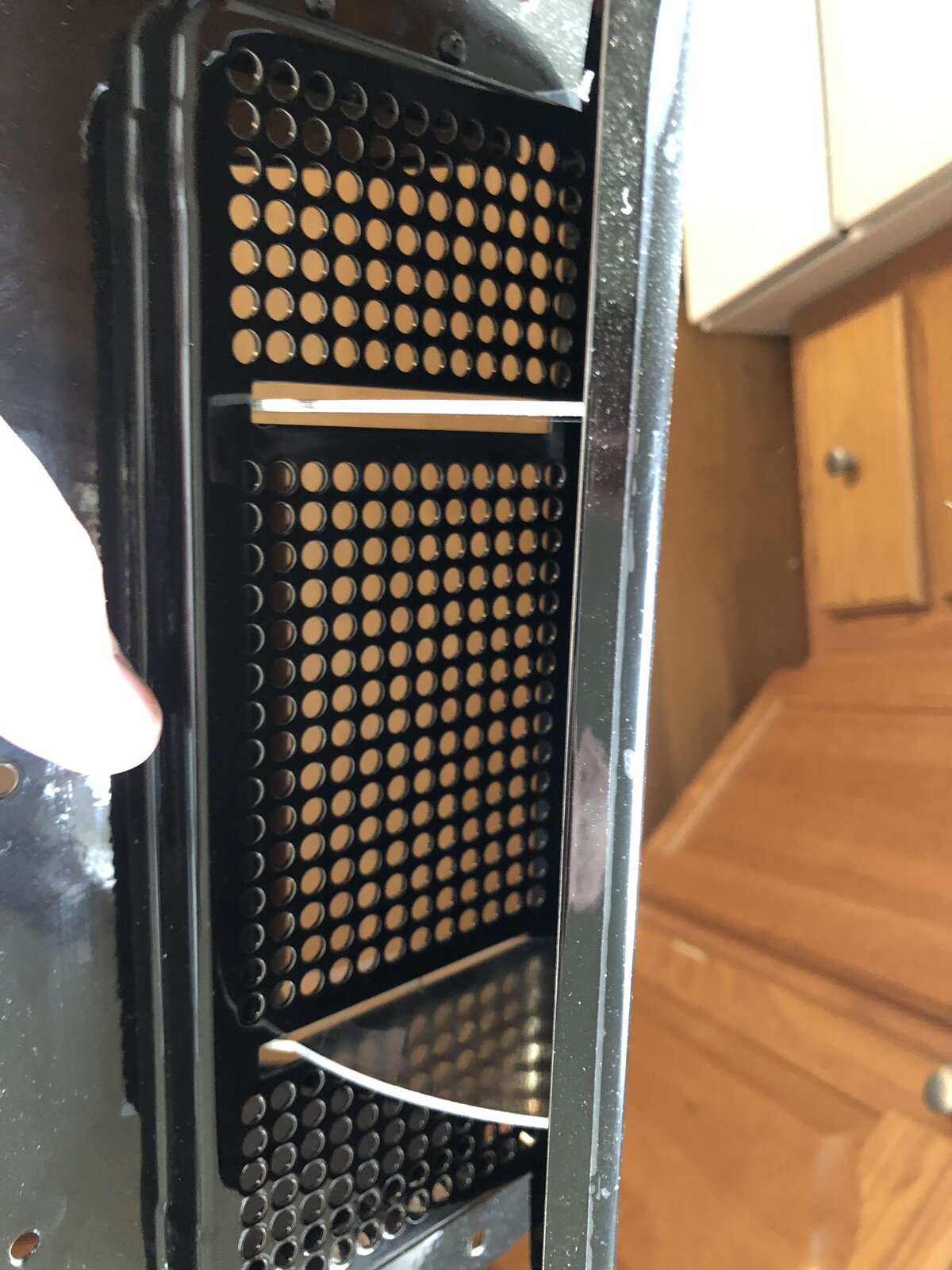

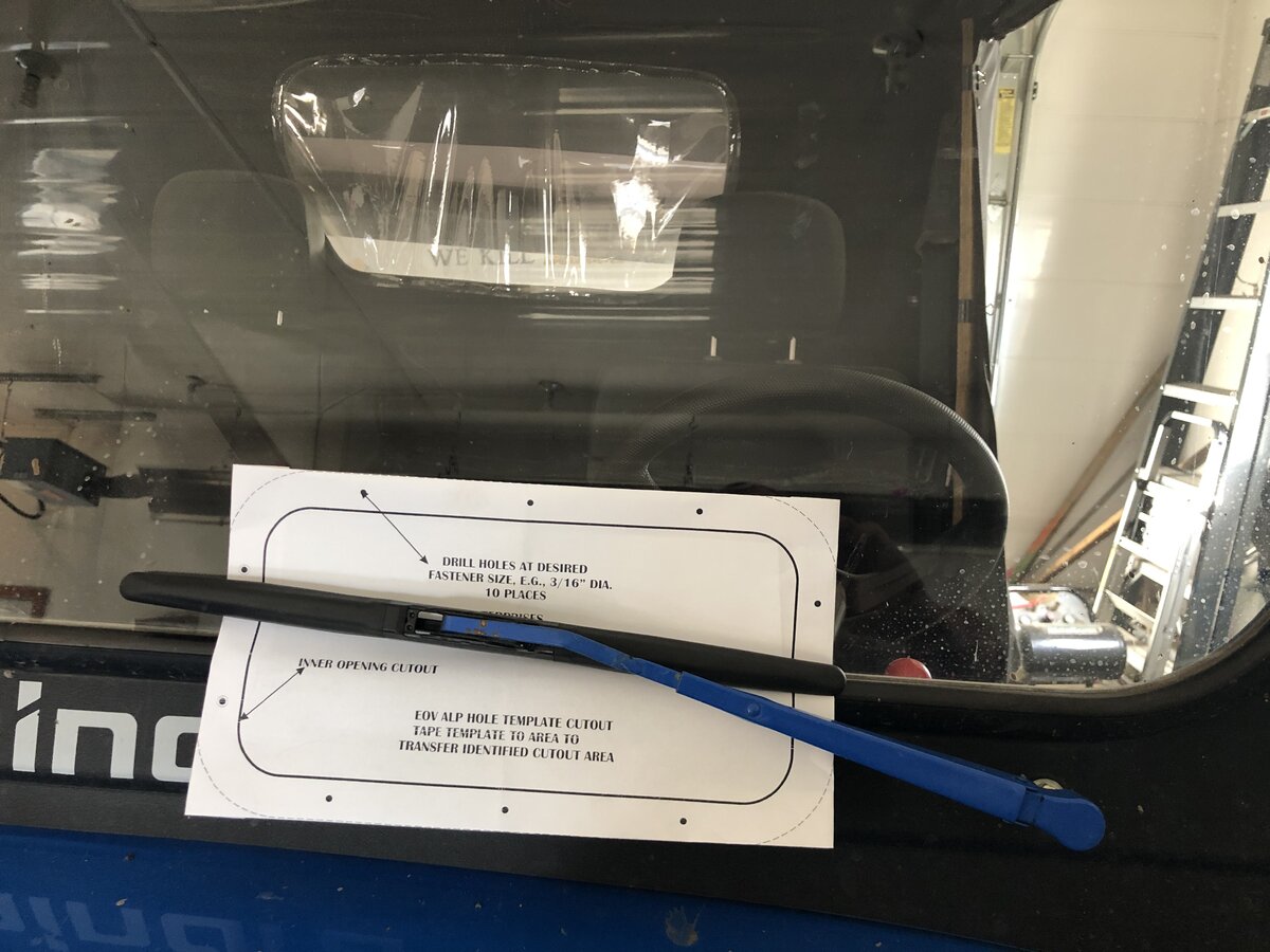

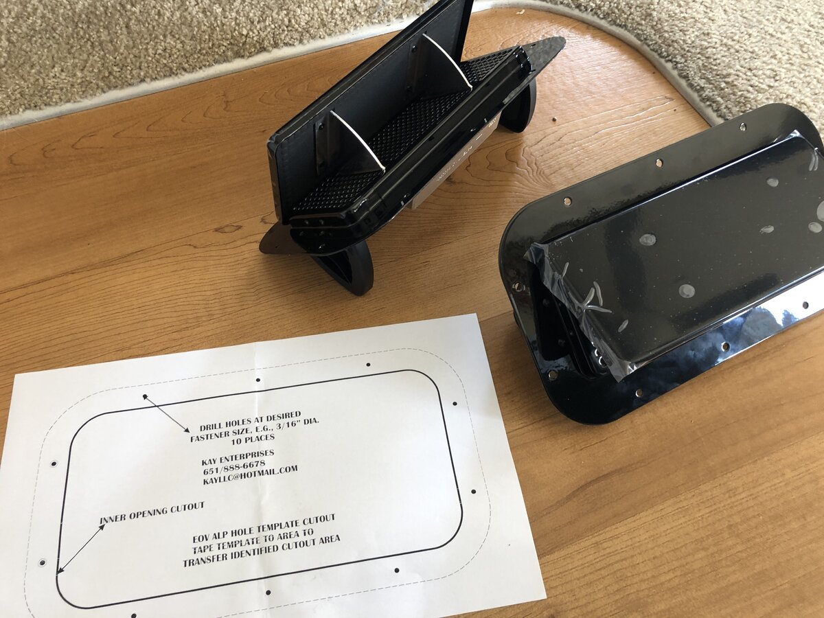

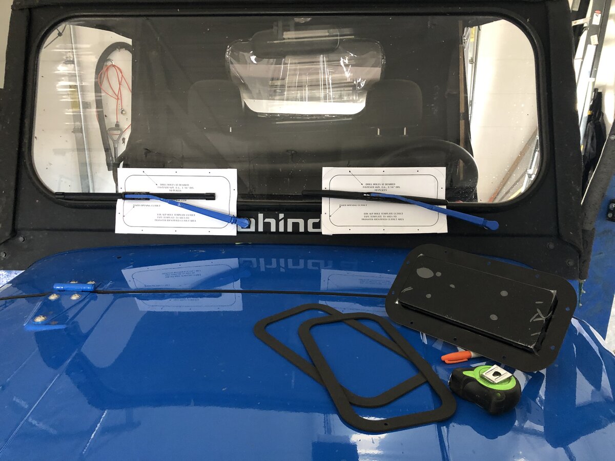

I'm also having a custom, 10 gauge, vented, glass, powder coated windshield made that is identical to the OEM for specs (holes, bends, size, etc) so the vented windshield will work with the cab just like the OEM and will pressurize it and make me dust free on the back roads and remove the vortex behind the windshield if the doors are off because of the rear bulkhead and panel.
That is the vents and where they are going. I taped off the bottom of the glass to see how the vision would be and I never even noticed except I couldn't see all the hood, no big deal.
Horse trailer vents $25 each, 3 positions each way, up or down. It's going to be spectacular.
