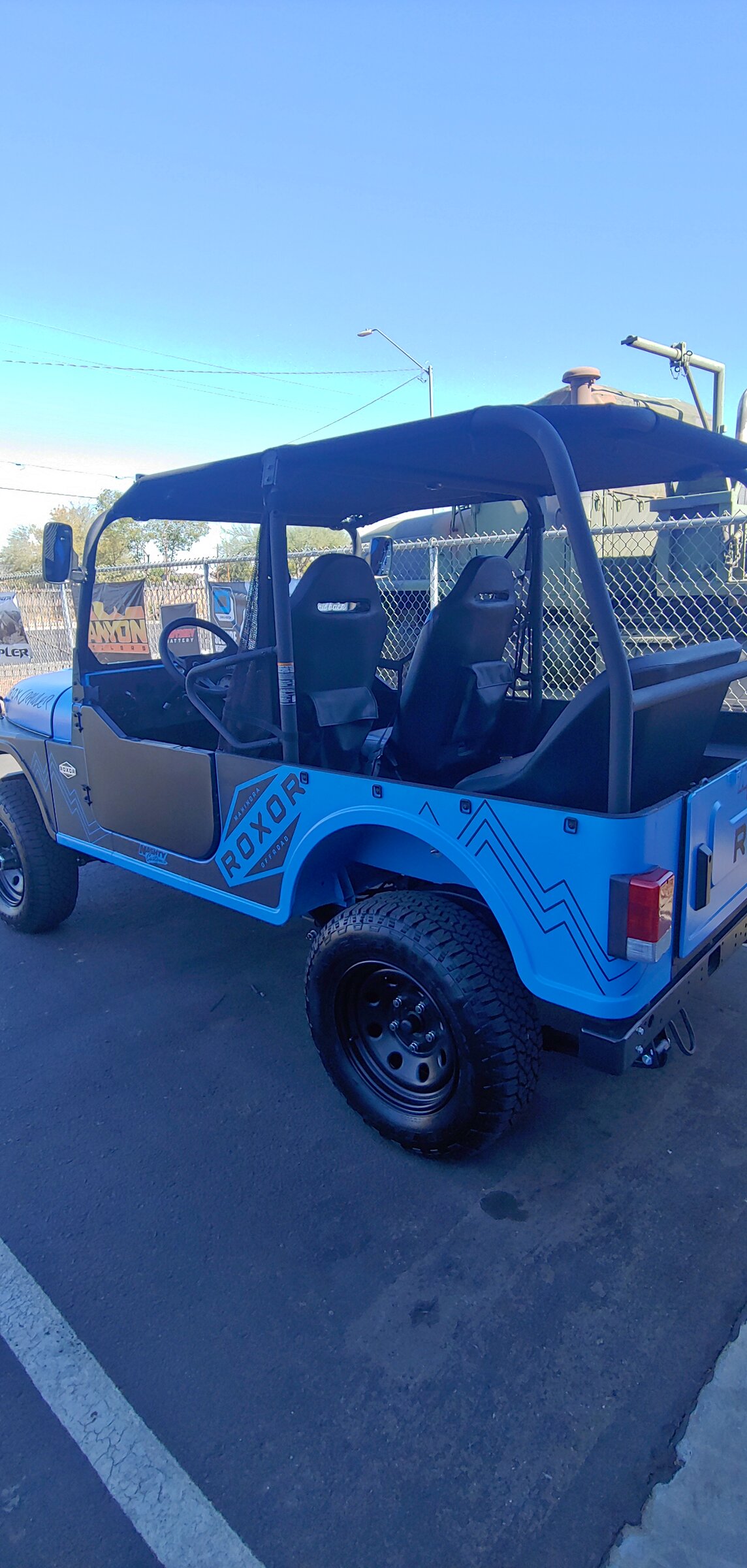

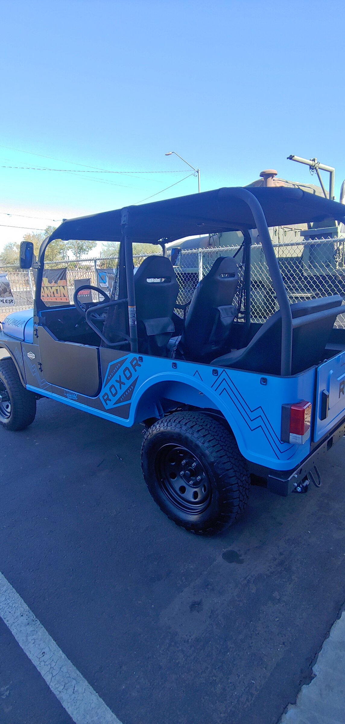

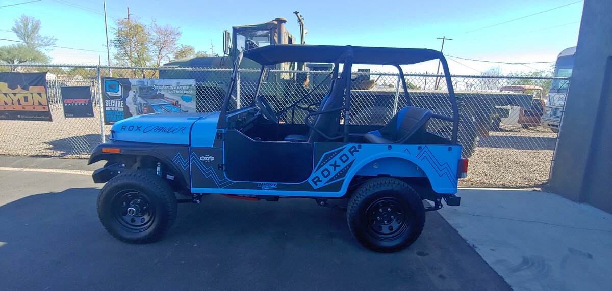

2019 Roxor, A/T, warn hubs, soft top, rear seat, front end level, street legal package, stage 1 tune. Nash powersports completed the graphics and seat upgrades.
