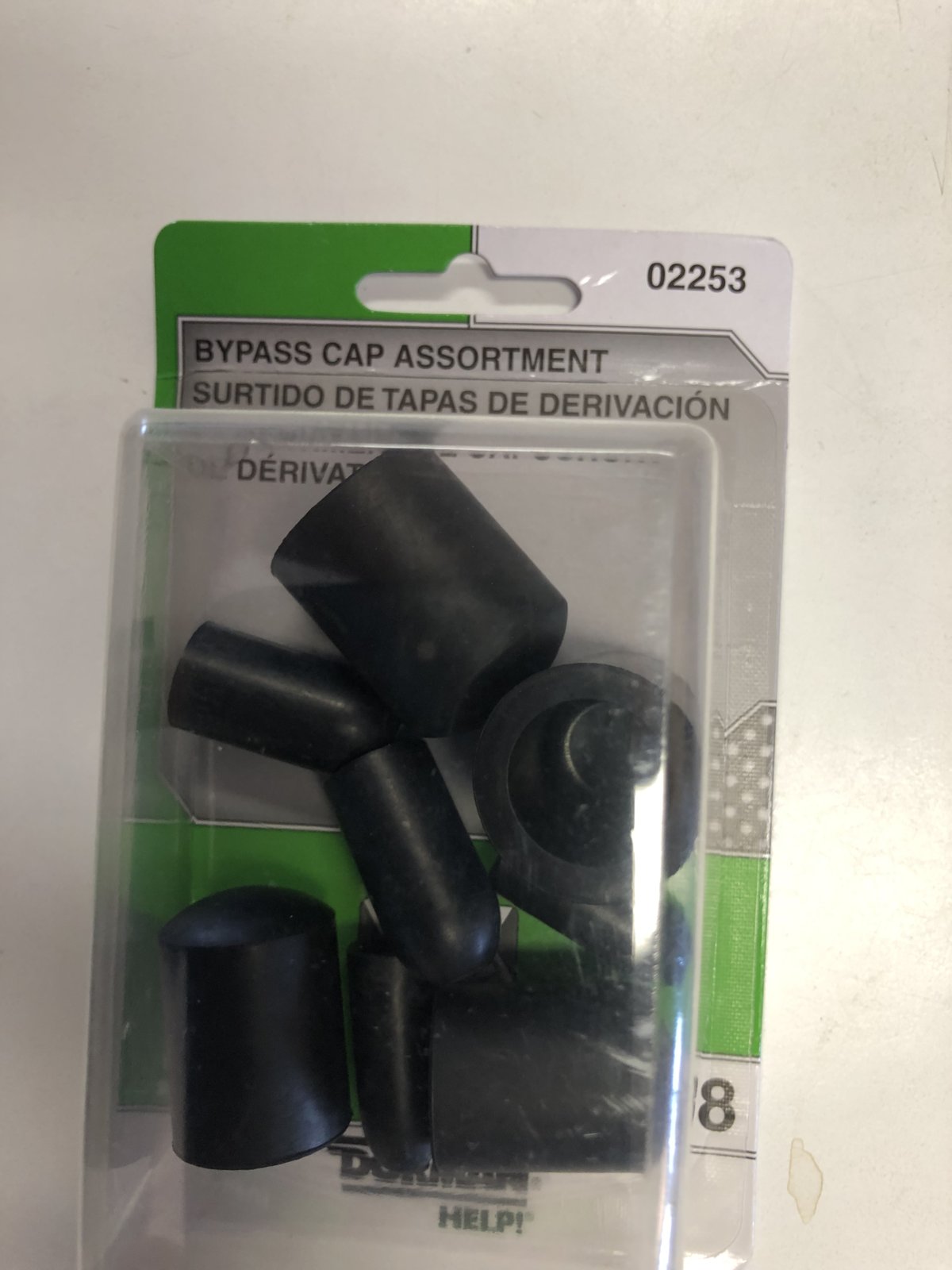

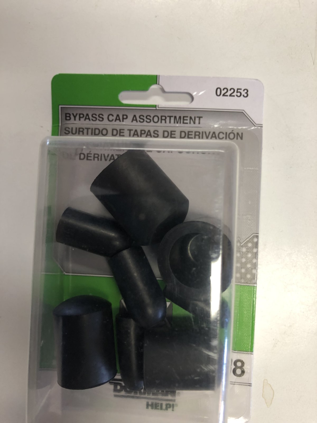

Im having a difficult time finding plugs for the coolant line , i would have hit jimmyb for the whole kit but i already had the block off plates bought . Are the plugs being used a plastic 5/8 barb with a cap end? If so , where the heck would a guy find them? Ive been to every parts store in town and no luck!

Anyone tried these? Found them at Oreilly auto parts.
Campyman
467
Bellevue, WA
The caps you need can be bought individually at any good hardware store. I think I paid 1 for the ones I needed
