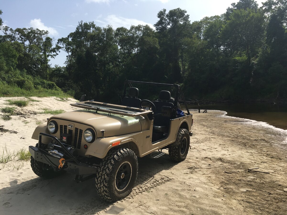

Yes they will work if you have a bumper with enough clearance. I too have longer front shackles and 1.5" spacers. For the most part mine is a run around fun vehicle that the whole family can fit it. My super duty has probably spent more time in 4wd than my Roxor. But when need to be, it goes quite well in muddy situations.
