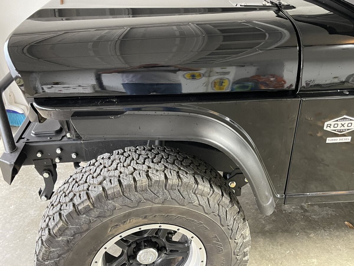

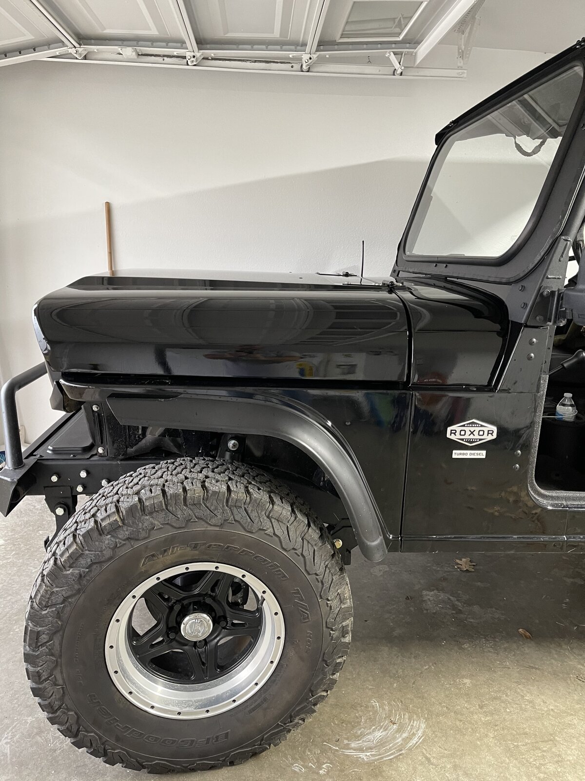

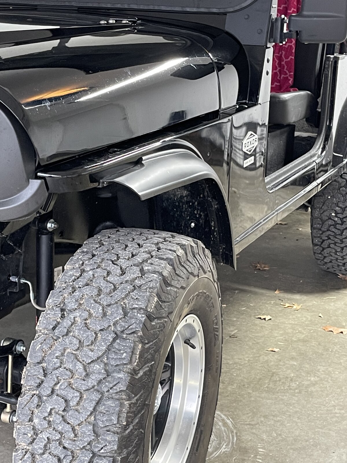

I got a set from online but can’t remember if I got them from Diesel Freaks or On The Rox Fab. I ended up cutting the front fenders down so the would fit as they were designed for the older model Roxor’s. I clamped them on and used the edge of an 8” paper plate to get the radius I wanted and then cut them off.

If I had it to do again I think I would have left them a little longer but they work great as is. Definitely help to keep the mud off me and out of the cab area.

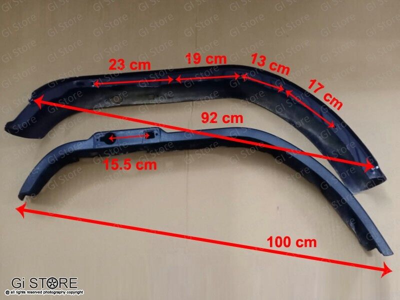

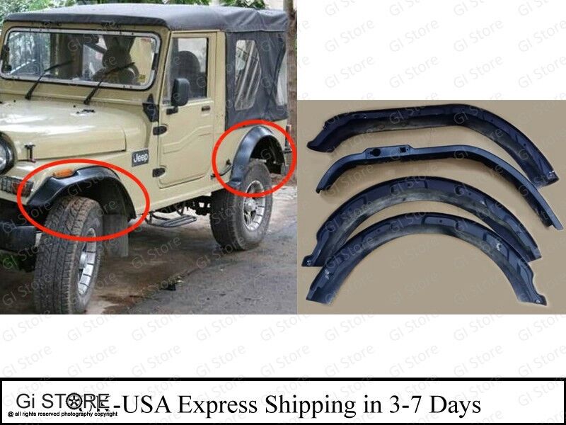

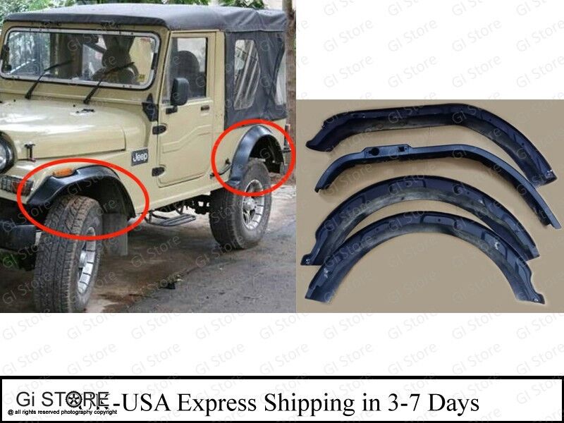

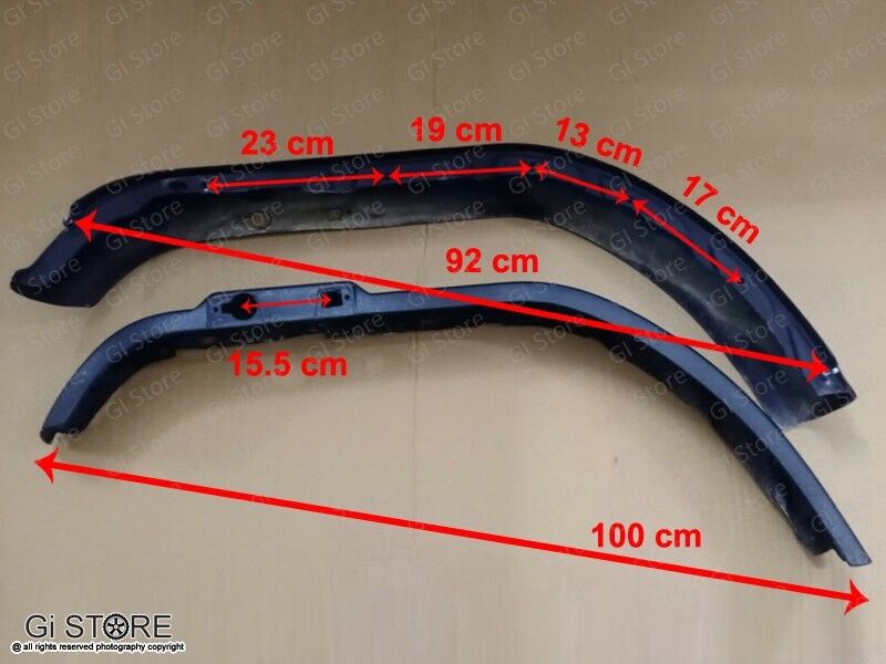

Check these for MM540 I think these should fit
View attachment 12090 View attachment 12091
These would have to be modified as well. The front fender on a 2022 model does not roll down in the front like the unit pictured. They run straight out and just end. No turn down.
