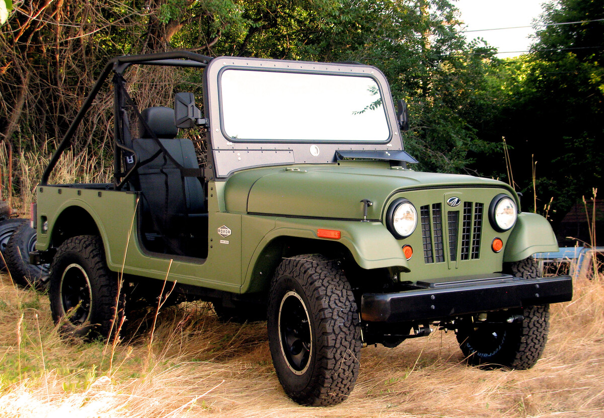

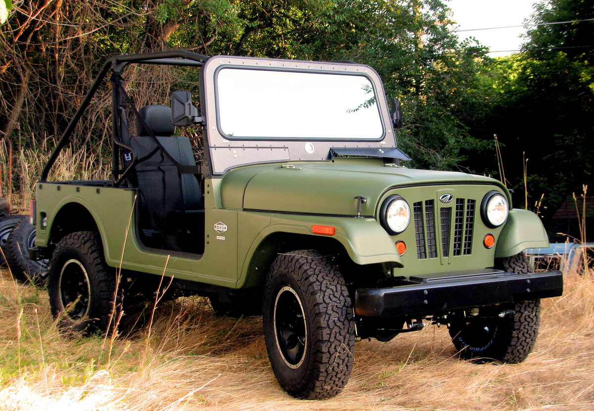

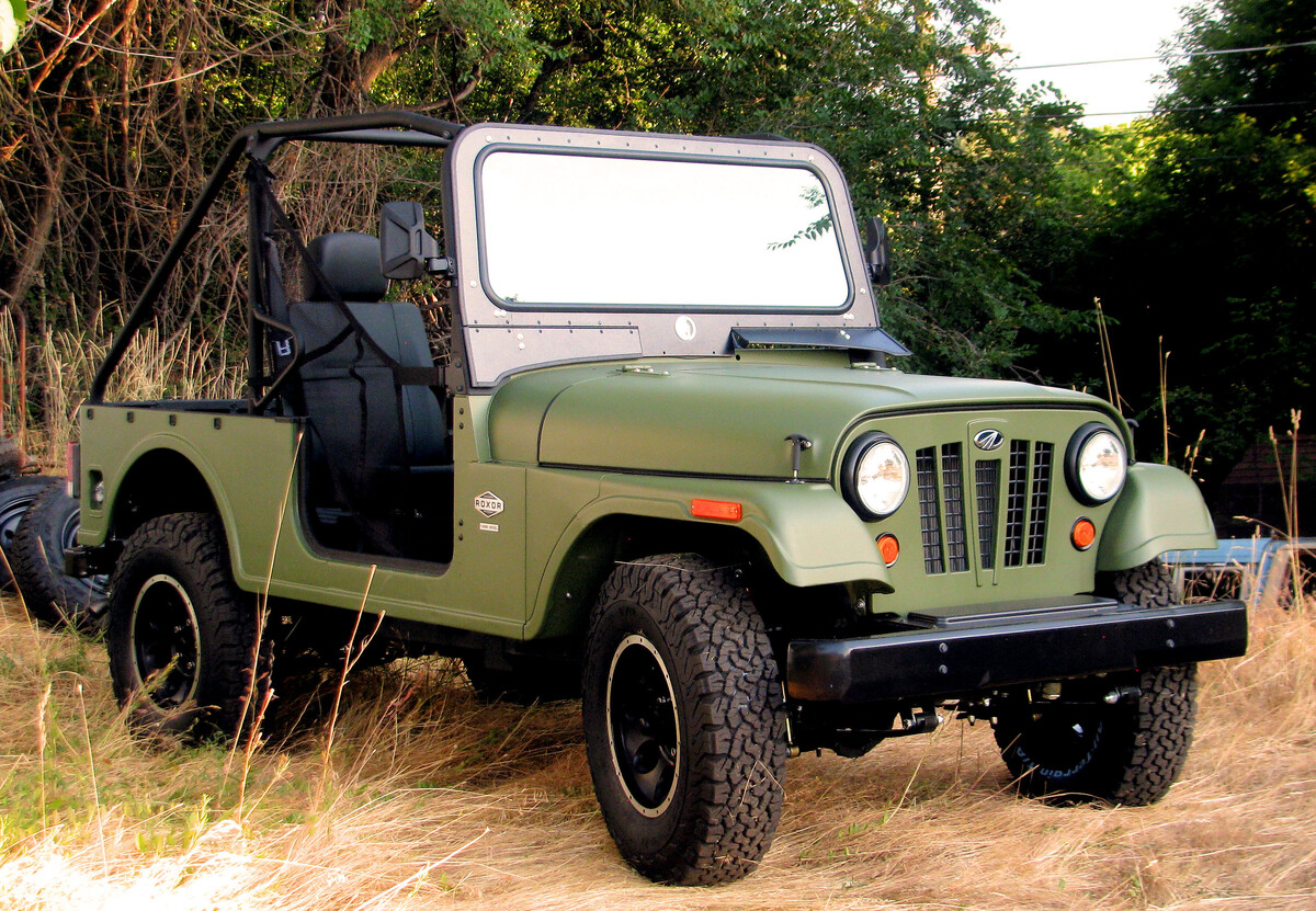

My Roxor has 235 85r16s and they fit with no rubbing. I have BFG KO2s on but I'm pretty sure I've seen other brands of tires in this size on the forum here somewhere...that's how I knew they would fit. I kind of like the "pizza cutter" look on these vintage looking Roxors and for the type of wheeling I do around here, I think a skinnier tread gets a better bite and actually performs better. Seems like when I measured them when I first got them, they were just shy of being 33".

My Roxor has 235 85r16s and they fit with no rubbing. I have BFG KO2s on but I'm pretty sure I've seen other brands of tires in this size on the forum here somewhere...that's how I knew they would fit. I kind of like the "pizza cutter" look on these vintage looking Roxors and for the type of wheeling I do around here, I think a skinnier tread gets a better bite and actually performs better. Seems like when I measured them when I first got them, they were just shy of being 33". View attachment 7990
Great information, and good looking rig.
