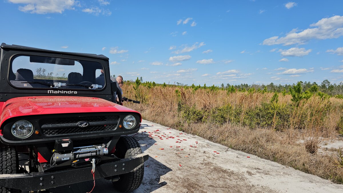

That is exactly what we did on our first trip out with the Roxor.
