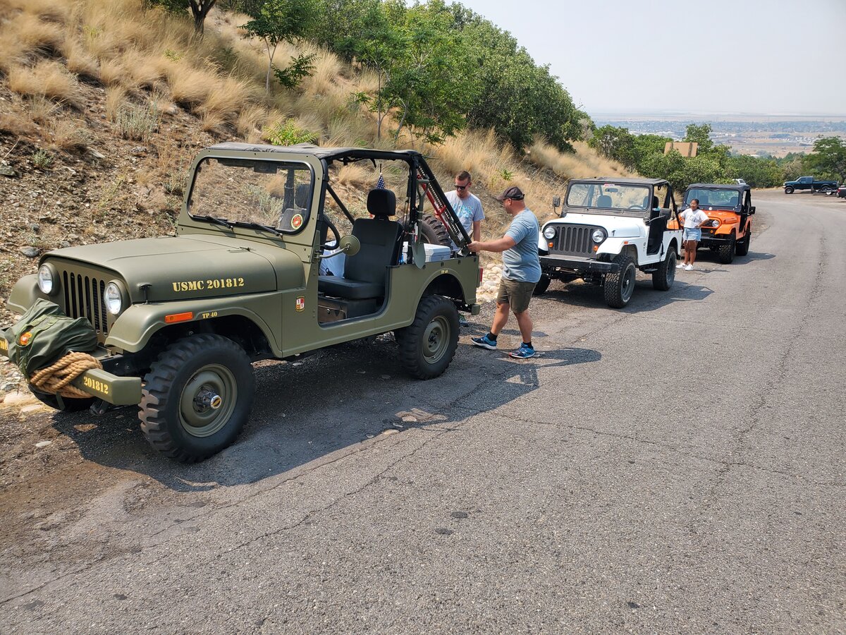

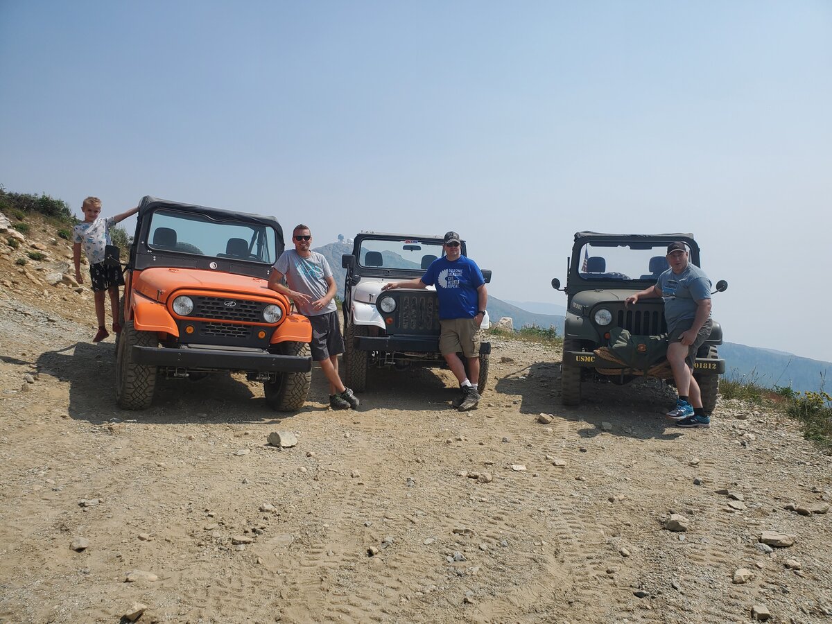

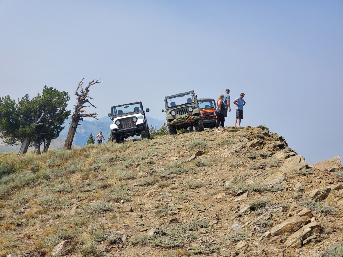

So mine I use as a daily driver as well as a off road rig. I live in Utah and have it licensed as a SxS so no freeways. My desired top speed is 55 but I can go faster. The Roxor is built far better than modern Jeeps. Built to last, many things you can do to make it better by deleting emissions and tuning. Install hubs on front to prevent excess drag on front in when in 2x4. In India I've heard of them getting many more miles on their rigs then any modern car you buy here. It's a tractor. Buy one and make it fit your personality
