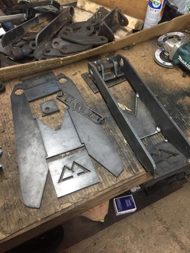

There are a handful of kits out in the wild now. I wanted to start a thread where all the information can be posted up in one area to make it easier for people to find. Write ups, tips and tricks for the install, part numbers, stories, all stuff that may help some one else looking to build a stand out roxor.
I get a lot of phone calls, txt, and private msgs asking questions and I’d love for all of that to be somewhere everyone can see and learn from.
I’ll monitor this thread and answer questions as they come.
No the kit is not on climaxoffroad.com
I do make and sell the kits and they are available in small batches every so often.It’s the very same suspension I engineered when building my roxor to race King of the Hammers.

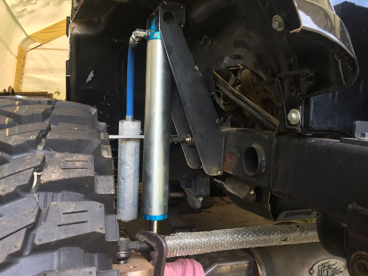

Hey @Max A. Can I get a measurement on this hole? Looks like it's maybe 3mm from the top of the frame, how far back is it? I prefer metric measurements if possible. I'm just about ready to burn your kit onto Jezebel.
My buddy is a union welder, used to tight spaces... Should I go ahead and drop the fuel tank or do you think it's doable without dropping?
The rear shackle relocation should move 2.5 inches forward eye to eye. You can move it back slightly if you desire. Moving it back will give you a lightly stiffer rear suspension upping payload load capacity. I found 2.5 is the sweet spot for a trail rig.
You may consider moving it rearward a 1/4 inch or so if you have 4 people in your Roxor often.

What issues are there to install these kits? Also what kinda of cost range are we talking about?
The kit is not a complete lift kit as many want to think it is.
It’s more of a kit to adapt to Wrangler leaf springs and correct the suspension geometry for a much smoother and flexible suspension without giving up utilitarian characteristics of the roxor.
Cons-
-The kits requires minor welding grinding and drilling.
-The kit requires a front driveshaft be made (I can help with that)
Pros-
-You can keep up with your friends in rzrs in the woods.
-Still drive it down the highway.
-Still pull a trailer full of firewood back to camp.
-The kit stretches the front axle out about an inch for better tire clearance.
-Substantially increases your suspension flexibility for rock crawling.
-It keeps spring under axle for maximum stability/ or spring it over for big a** tractor tires in the mud!
-It replaces the short weak front leafs with a more suitable spring.
-Wrangler springs are inexpensive and some are better quality then small batch springs that cost more to produce.
-You choose the amount of lift or load capacity.
- King of the Hammers race proven doing 75mph+ through the rough desert.
Cost is up to you. The kit from me is about $650. And that’ll go down if steel prices drop. (They are ridiculous right now).
You will supply wrangler springs of your choice. They normally dance for $75-200 per corner depending on your choice of spring/brand. You’ll also source shock ($200 rancho shocks, $5000 king shocks, or anything in between) and have at least a front drive shaft made normally about $260 from Tom Woods.
